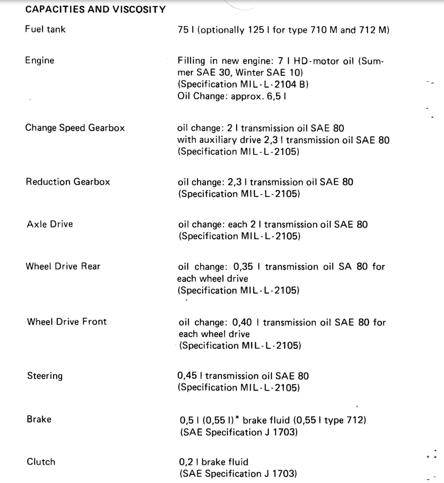

I am actually just getting ready to do mine also. I bought a gallon of the Redline. Is that enough to do all the tranny fluids?

Assume you have manuals - if not it should be 1st purchase
