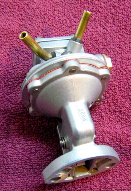

save the time to rebuild and get yourself a VW fuel pump
Volkswagen : 113 127 025 C - 113 127 025 B - 113 127 025 A
tested and working, see http://pinzforum.kiruna.de/viewtopic.ph ... mpe#p72668

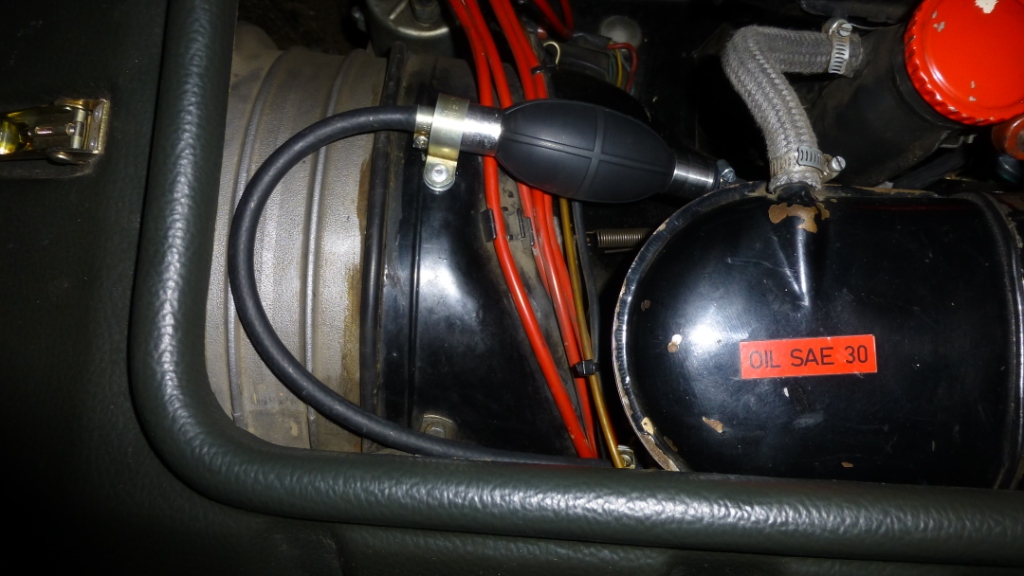

I was tired of cranking a long time before starting (the starter too...). So I've installed a hand pump (the same as for outbord motors): so I press a little to fill in the carbs... and the engine runs immediately.
- P1030580 (2).JPG (252.62 KiB) Viewed 14609 times

Pinzcat! Man, I had this thought awhile back but was to chicken to try it. I like it, seems very easy. Any issues with that? I wouldn't think so, but you never know.
Testing tomorrow, have to move a 1000 gallon rainwater tank to the top of a far off hill, bout 200 miles round trip. First time without a top/flat bed mode, I have to say, I like the look.
Pumping the pedal also has been helping to catch earlier.

@ texas 710:
No problem with this system. I am not the only one to use it, I found the idea on the german Pinz forum!
http://pinzforum.kiruna.de/viewtopic.php?f=3&t=8935
