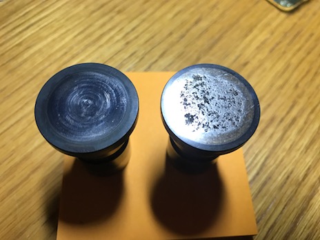

Be it a Hafe, Pinz, or C30X we run with SOLID lifters. You have to use oil with the proper
type and levels of anti-wear or you gonna end up with lifters that look like the one on the right.
Use motor Oil classified for "Classic cars" with solid lifters, or simply Diesel Engine oil with
designation CH-4, CL-4 or CJ-4 (most current). You do not want to use any API designation
of: SJ, SL, SM, or SN (most current) -- look on the back of the Oil for the API "Donut". The
formulation changed when Cat converters were eaten up by ZDDP which is the stuff you want
in your Oil. API decoding ring here:
https://www.api.org/~/media/files/certi ... h_2013.pdf
