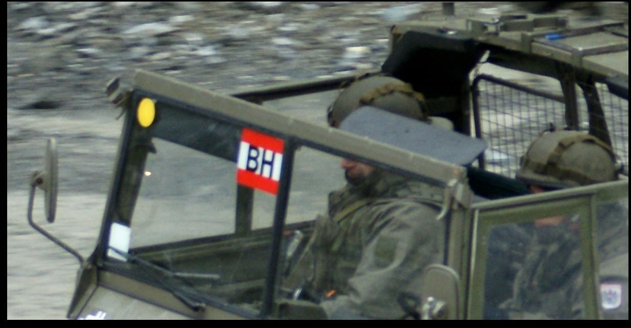

They are the mounting point for the front quick release locking clamps for the soft top on an Austrian 710/12 M.
Only the Swiss used the leather straps and footman loops for securing the soft top at the windshield. The Swiss never intended the windshields to be folded down, that is why none have the w/s frame securing bars next to the headlamps
- Pinzgauer_Typ712M_Austria_2 c.jpg (115.26 KiB) Viewed 8102 times

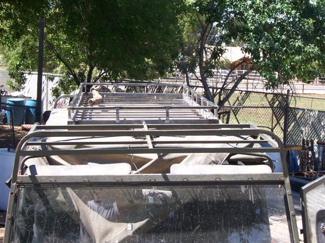

actually if you check your manuals you will see that there was an optional roof rack available. I built one using the same mounting points. I copied the design that was in the book as close as I could. worked very well.
- 100_3493 (Small).JPG (90.52 KiB) Viewed 8057 times

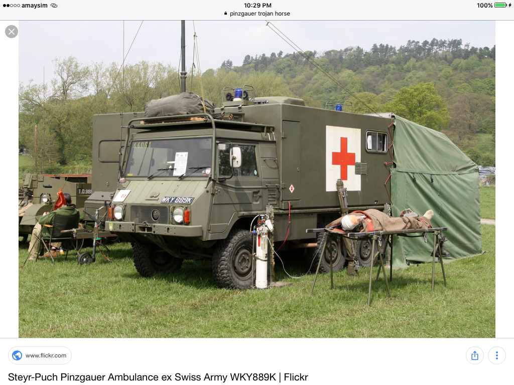

Re: Four 6mm bolts near top of windshield?

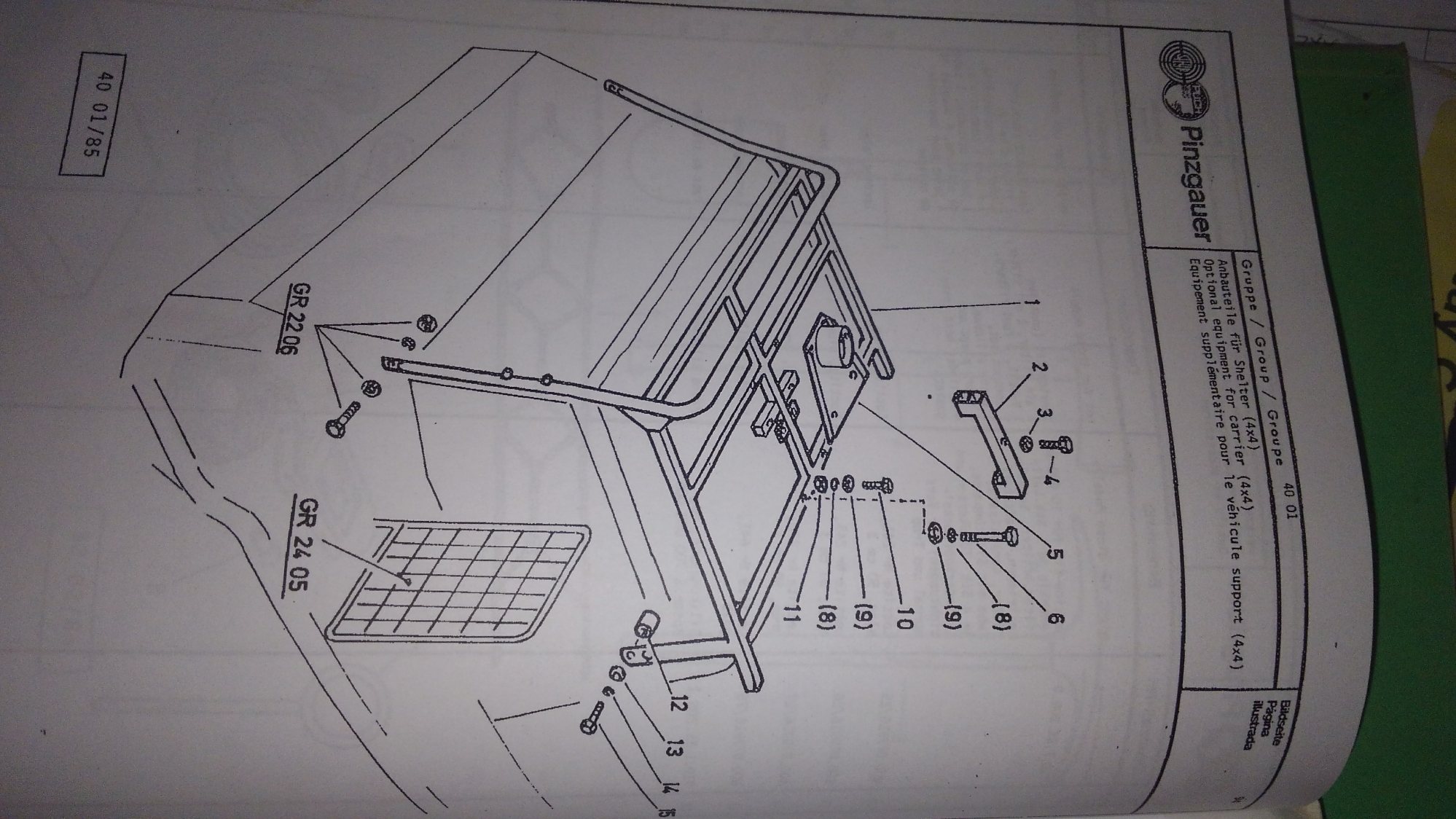

knew I could find it
- KIMG0960.jpeg (305.66 KiB) Viewed 8053 times
as you can see we carried the supports down to the hinge bolts and secured the rack at the top with the four bolts then land on the antenna mount. Have seen photos with spare tires on this rack along with a rack that was purposely built to carry the spare tire.
The part Number for that frame is 711.3.83.200.2, but Puch does not list it anymore
What manual is that? I just have the betriebsanleitung.
here you can download the spare catalogue 1985

I just stumbled across this pic of said cab mounted roof rack so I thought I'd add it.
