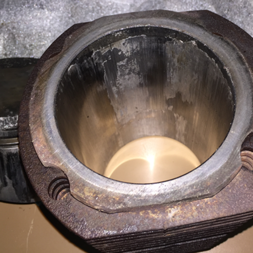

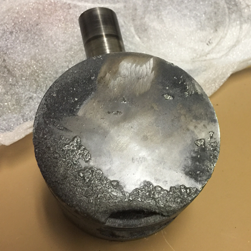

<t>The pictures tell the story. This was number three cylinder. The other cylinder have good compression</t>
712K #3 Piston1-small copy.png (1.86 MiB) Viewed 5117 times
712K #3 Piston2-small copy.png (1.4 MiB) Viewed 5117 times
712K #3 cylinder-small copy.png (1.39 MiB) Viewed 5117 times

Whoa. What are the valves like? Could it be it was running too lean somehow?
Re: Looking for reason my piston melted
Air leak in the intake manifold, or bad gasket on #3?
Posts: 940
Location: Indio, California
Post by pinzinator »
It looks like a lack of oil, but I have no idea how that could happen.
