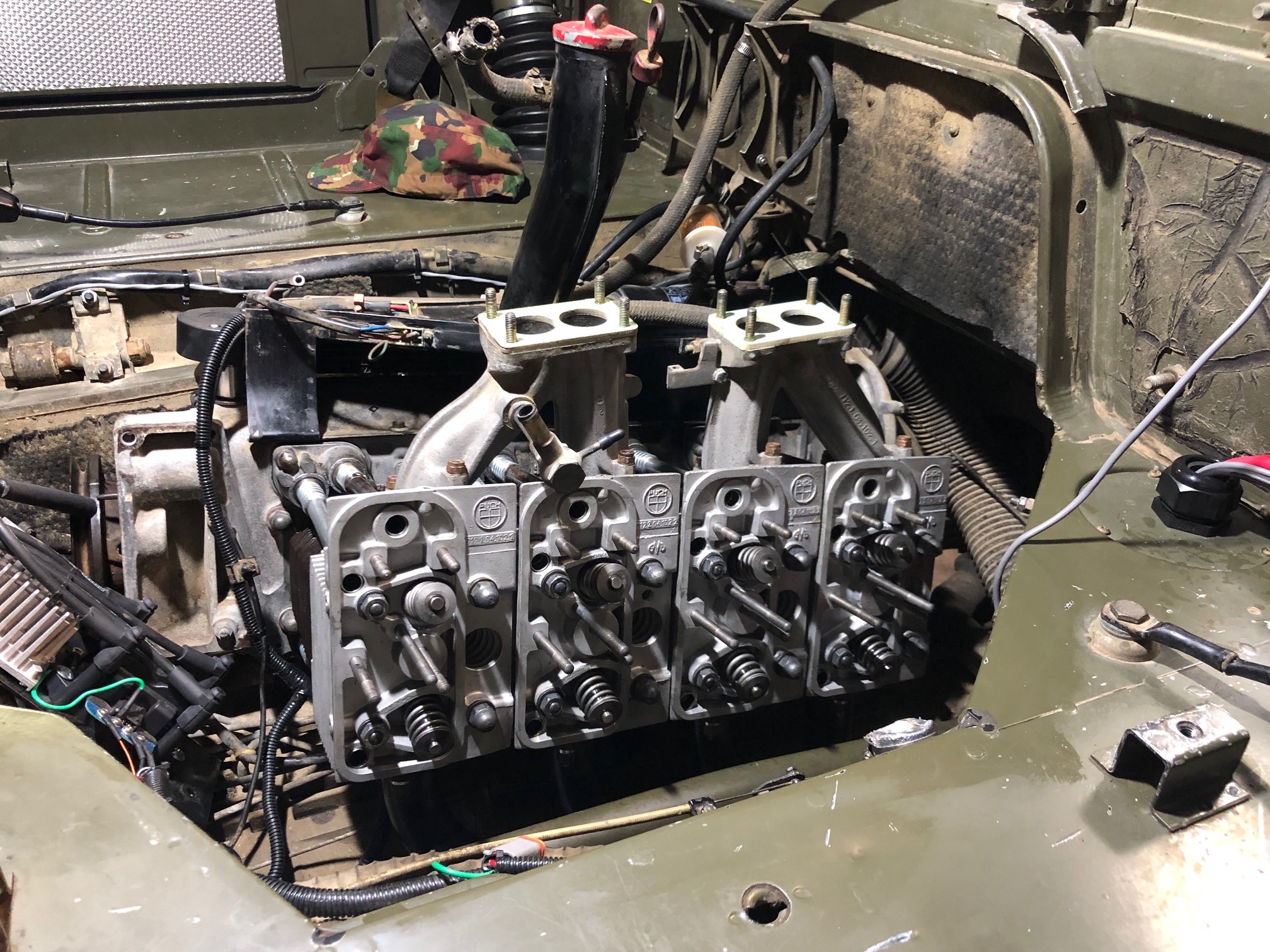

Well it's running OK now. Amazed it ran at all. Brake boost line broken, big Vacc leak.
Throttle plate on one card separated from the body, another vacc leak, accel jets plugged.
Completely out of balance carbs and linkage holding one throttle plate open. Just got
the carb balancing airflow meter today.
Good news is compression checked out very good, and a boroscope peek into the cylinders
looks very good.
Then I got to hatting the look of some very ratty air tunnel insulation and could not
help myself to get the heat gun and remove all that crap. That was more work than
expected. Good I did as there were several surface rust spots. All cleaned up, started
sealing, painting and will add some MLV as a heat and noise barrier. I'm spending all
my time on stuff you can't see
Slow going though.

Re: Pinzgauer Rescue
Five steps forward one step back
Better this happened on my property than on the trail.
After installing newly refurbished carb's from the Goatwerks factory,
cylinder #3 decided to give up the ghost and beltch tons of grey smoke
and oil out of the exhaust, leaking right out of the flex exhaust coupler.
Well the bright side is that I did have the 2.7L conversion planned but
I was hoping this to be a bit further down the road. For sure better this
happened close to my garage than out at 7,000' up in the Sierra's. Even
with the new carb's and PinzSSI I felt there was power lacking on this motor,
just don't feel right, though compression was on the low side.
Well, all torn down, and surfaces cleaned. I have a set of re-build spare
heads ready to go. Jugs need boring and piston fitting. May as well get the
Headers ceramic coated and get a AFR and Pyrometer bung welded in.
Don't know what's worse on these top end jobs: The prep work cleaning
before re-assembly or the re-assembly. Waiting for parts sucks too.

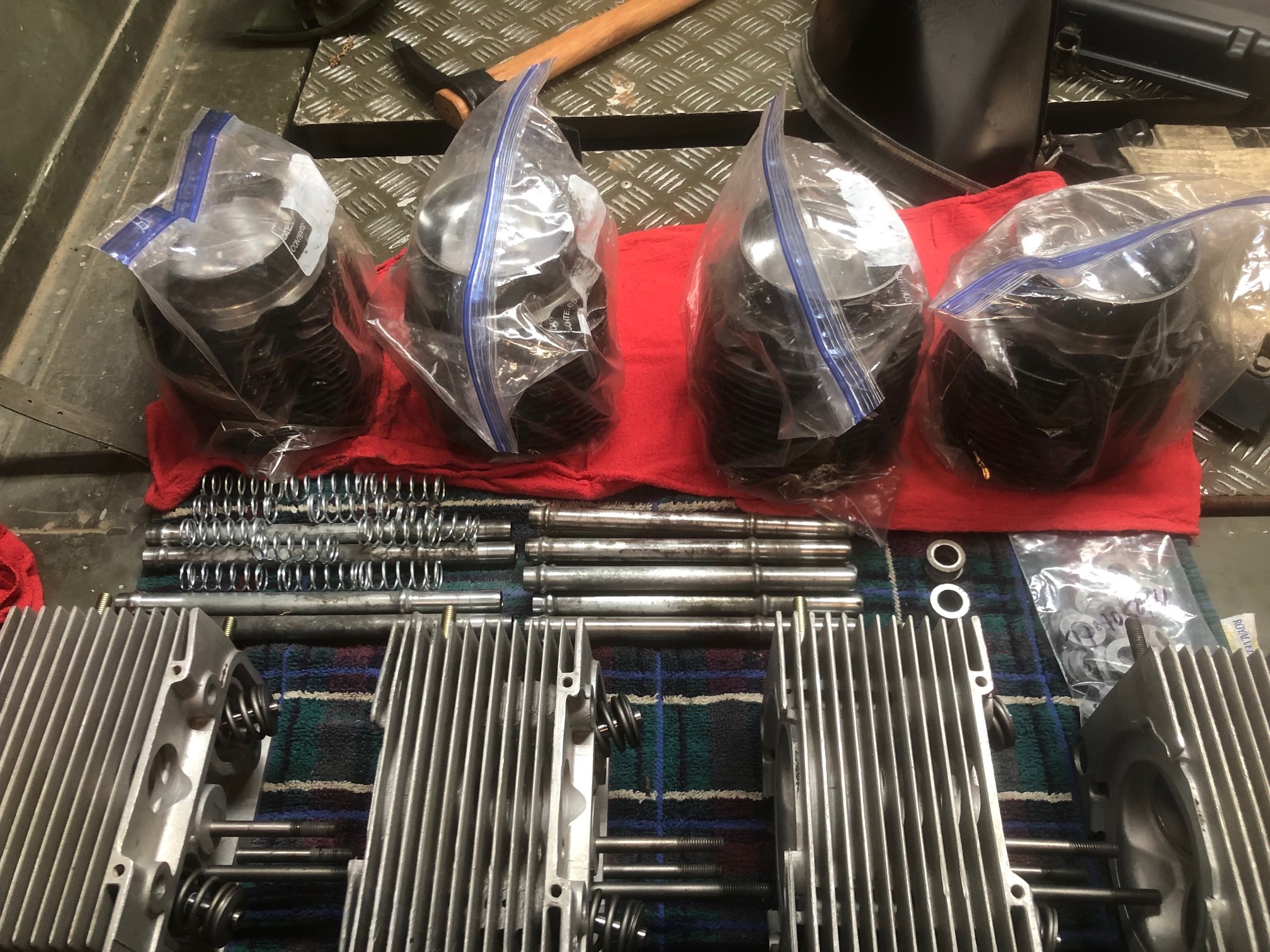

Jugs and Pistons received. All back together, started right up, runs smooth.
In the "trial" phase, doing short HWY runs checking for leaks and any issues.
I hand lapped each Cylinder to it's corresponding head prior to getting them
bored for the new Pistons.
#4 set in place.
Cylinders in position, Intake manifolds and Exhaust in position and aligned
ready for Torque down.
Done. Some tweaks were necessary to get the Airduct to sit proper on the Carbs
Now I have a shot to get this rig on the Trails.
#4 set in place.
