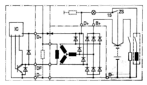

There are 4 terminals of interest. Bat (red), D+ (Blu), D- (Blk), and DF (Yel)
The D+ and Bat outputs should be almost identical Voltage when running, check
to see if they are. The charge indicator lamp connects to the regulator but
logically the lamp connects to Bat on one side and D+ on the other. So if
D+ is not outputting for some reason it looks like ground and the lamp is ON.
When D+ is close to Bat's output voltage then there is near zero volts across
the lamp so it's off. P.S. that's why the lamp can flicker at times or be dull
when the RPM is too low as the D+ output is below the Bat voltage.
The terminal DF is a control, it drives the field winding. When this is a low
voltage the winding is getting all of D+ voltage across it and the Alt is outputting
hard and furious. Measure DF as well and see what that voltage is. It should in the
ballpark of 8 to 12v under a lite load and far lower when the load is high e.g. high
beams on and anything else you got to load up, e.g. DF drops with increased load.
All the while above, Bat should be as you indicated a bit over 25V. If all that hangs
together you may just have a short to ground on that lamp
A representative Regulator -- Alternator schematic attached.

Hmmm, that has to be the other way around. DF can’t get above D+. So has to be D+ is a high voltage. Soooo this implies
the regulator thinks D+ is not outputting thus the regulator is driving DF to low voltage to get more output. Bad
connection somewhere between the Alt and Reg terminal. Or a bad regulator but I think you replaced that already.
Most likely a open circuit somewhere.

As I pointed out before, Blue = D+ and is a copy of the RED e.g. Battery output.
It should track the primary output voltage very closely. At 1.6V it sure ain't.
Make sure D- and the alternator case has a real good chassis ground. Just for
yuks, start the truck, then while it's running Open the Battery ground break
switch -- does it still run even with that open. See element #53 in the Pinz
schematic, that relay should close with a running Pinz and normal D+ output and
the engine should continue to run. If it does D+ is present enough to pull a
24V solenoid which would suggest something wrong with the measurement.

Re: Charge indicator light
Disconnecting the B+ was to isolate the output from the Battery to see
if there was any output -- which apparently there is none. If D+ has a
voltage on it e.g. ~24V which is supplied by the regulator, and DF is less
than D+ then the field winding on the Claw pole rotor would be energized
and you'd be cranking output.
So the only conclusion one can make under the above condition if you do
also see any D+ voltage is that the problem is likely in your wiring harness
or connections -- as you have already replaced the regulator -- I think. It's
probably that simple
Correction
The charging system on the Pinz is very similar to that of a Porch 911, obviously 24V not 12V.
Bosch Alternators and regulators for both.
Both are what is refereed to as a "B circuit" for the Field coil. What I described was a "A circuit".
I need to correct that.
The difference is; For a B circuit, one side of the Field winding is tied to D- e.g. Ground, the
other side connects to DF and is driven by the regulator to a positive voltage thus energizing
the field winding. Driven until D+ gets to the pre-set voltage of approximately +28V.
I described a A circuit; Where DF is driven toward ground by the regulator at the DF terminal,
the the other side of the field coil connected to D+. In both cases DF is driven until D+ reaches
the preset voltage of ~28V. Sorry about the confusion.
I also verified this by measuring an Pinz Alternator I just happened to on the bench from my 712.
Still doesn't fix your problem, but I wanted to get this correction out.
