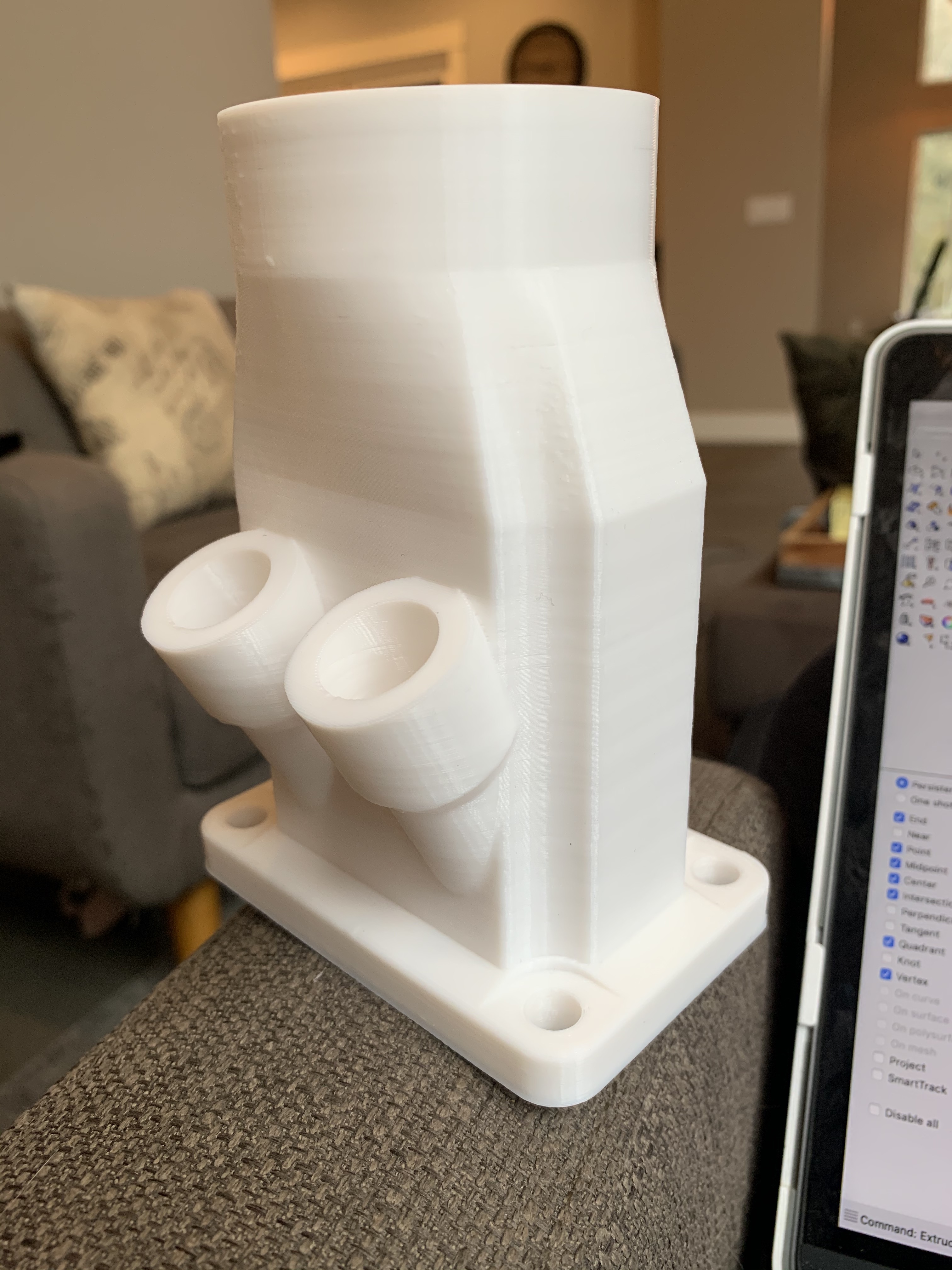

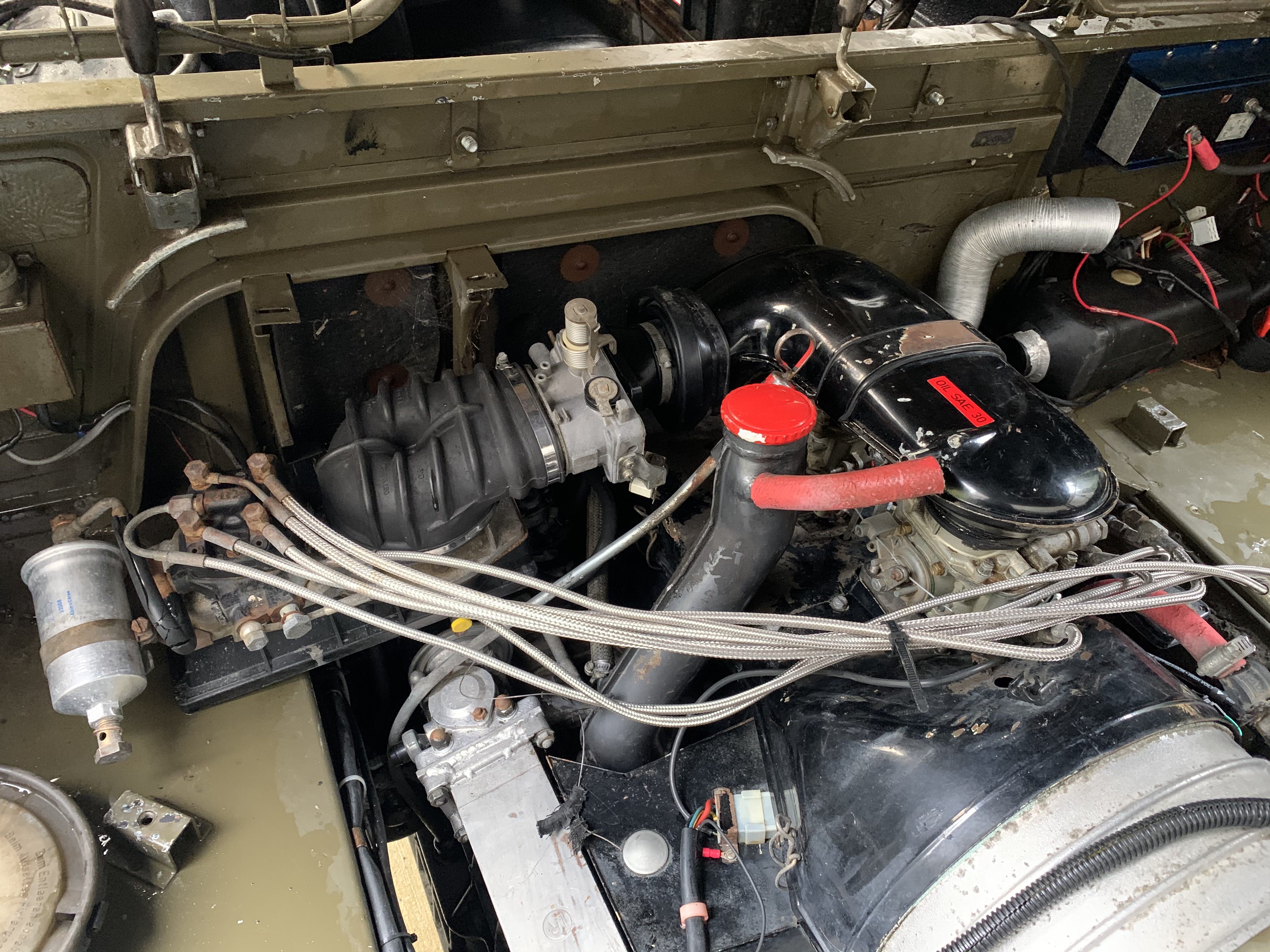

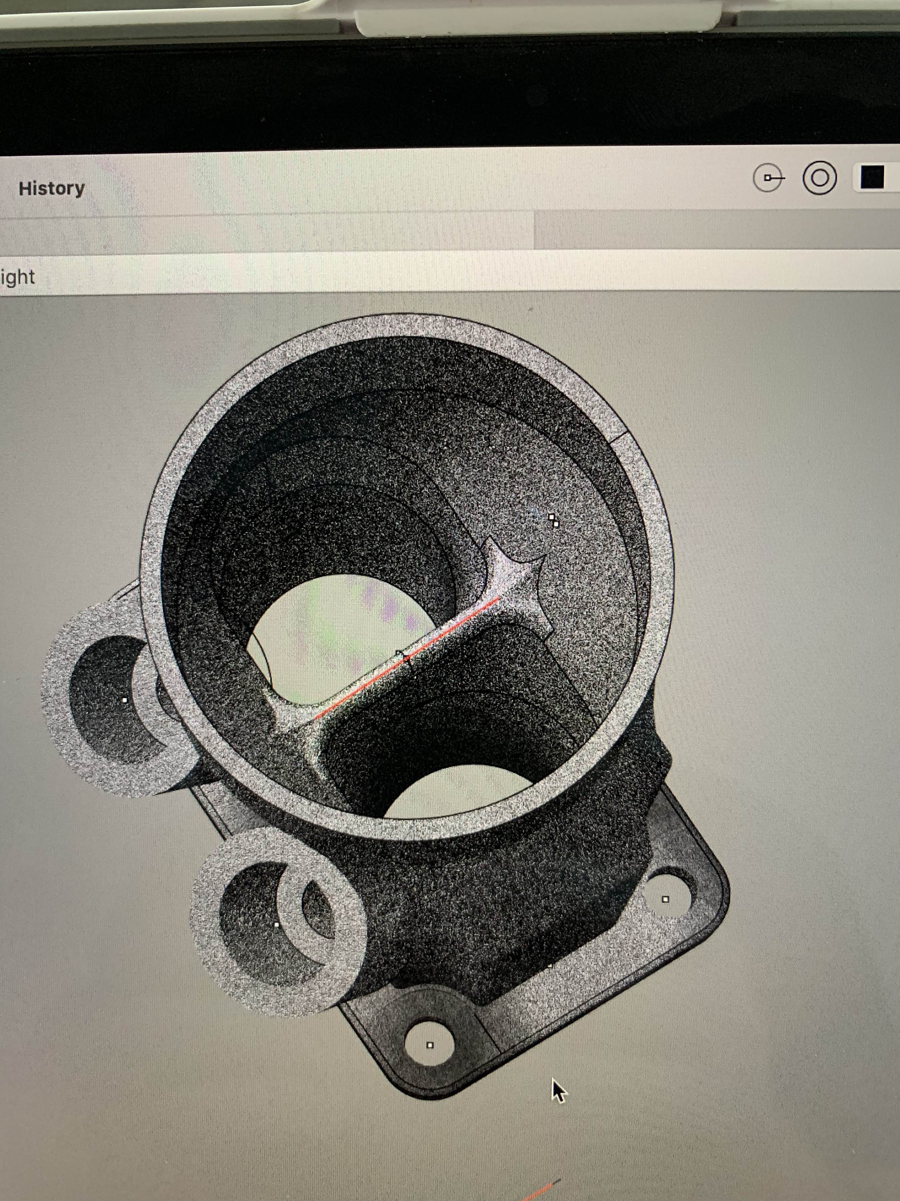

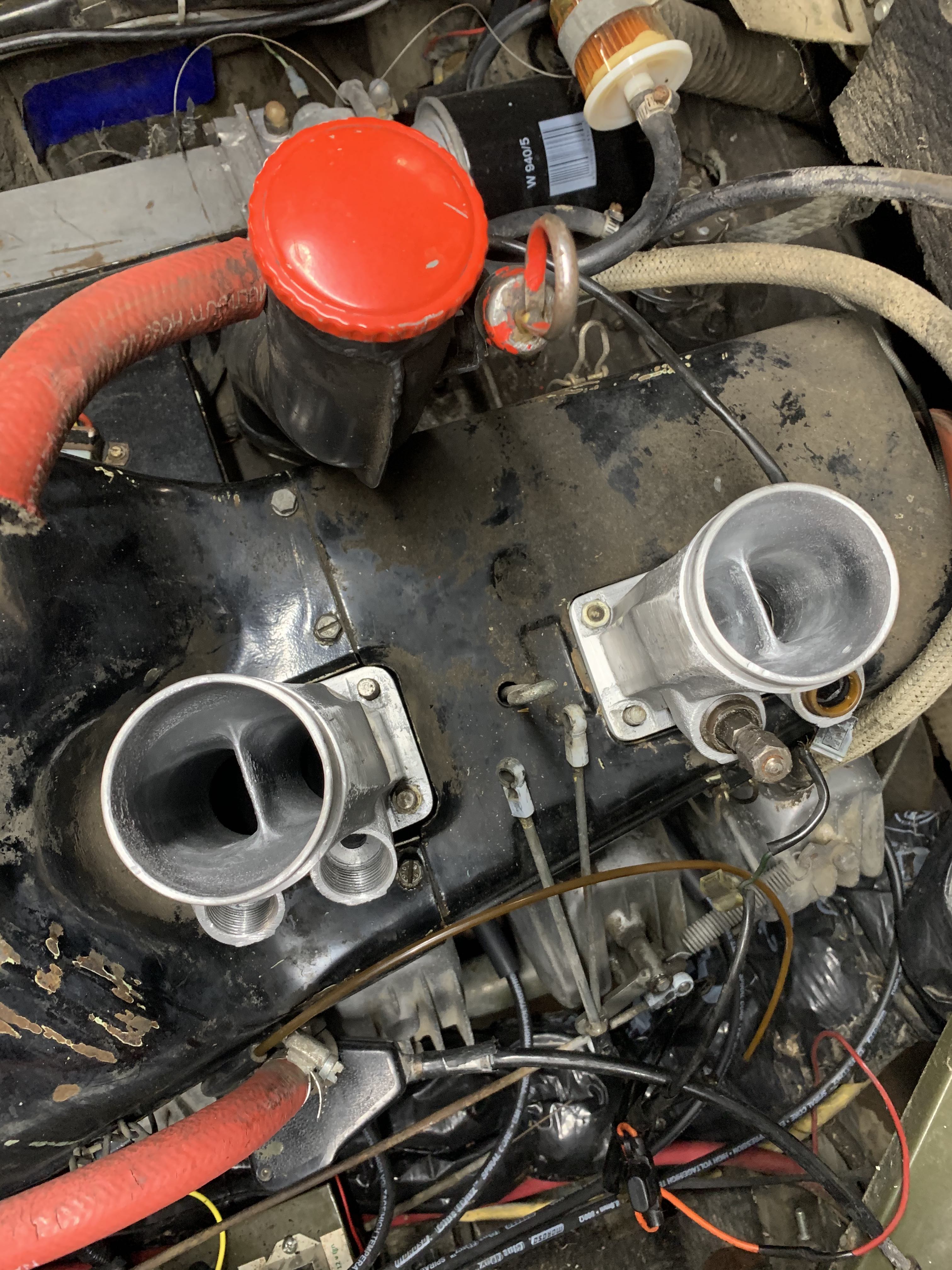

Attached are some pics of what's been done so far. Measurements were made of original carb and VW injectors and modeling has begun for prototyping one from plastic. My goal is to cast them out of aluminum later. I was able to get my hands on a good CIS basic system for fit testing. I printed a quick TB to intake boot adapter too, its a close fit if I'm going to clear the engine cover.

Full scale test print fits great. Now to modify the shapes for casting.

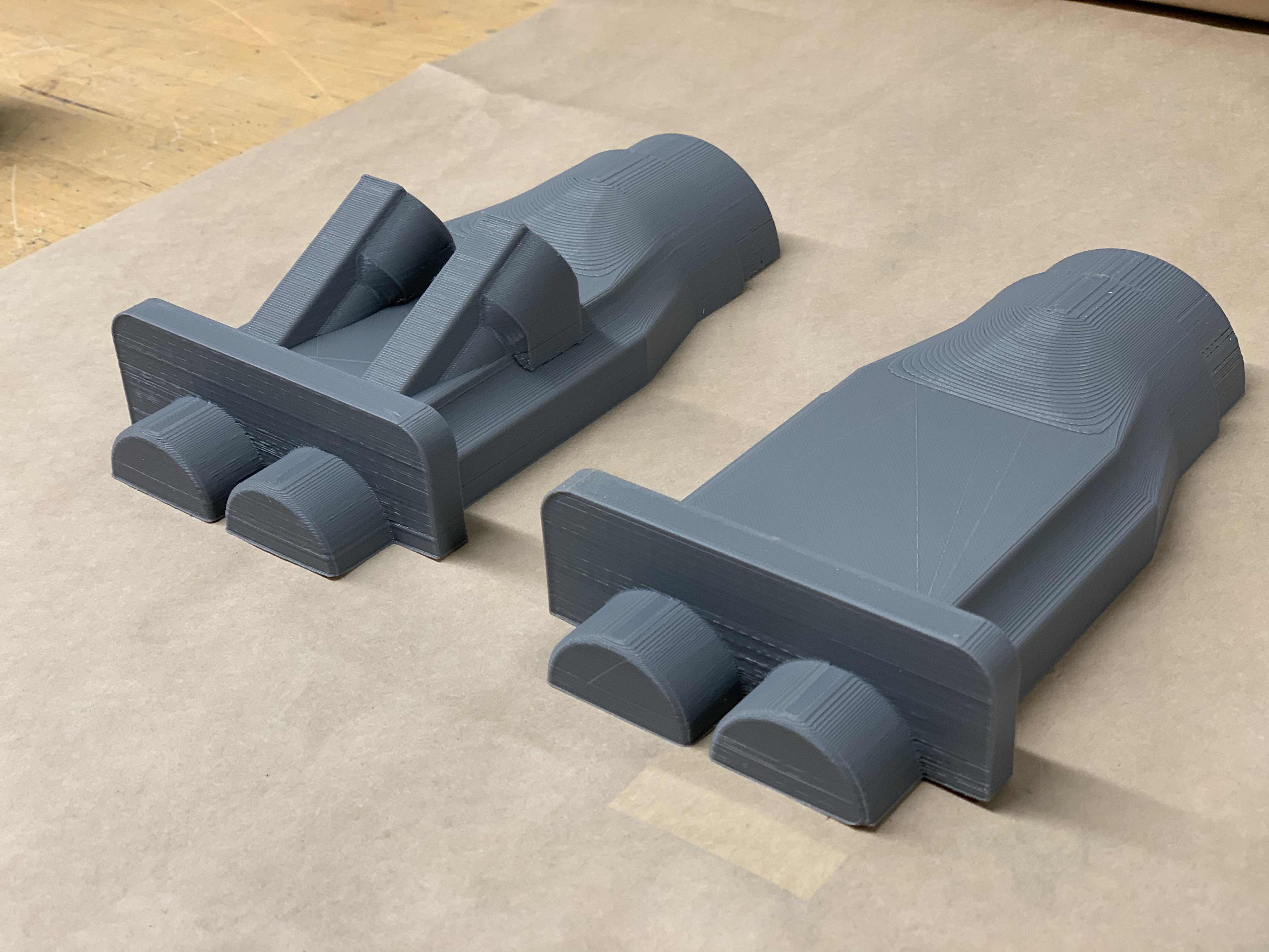

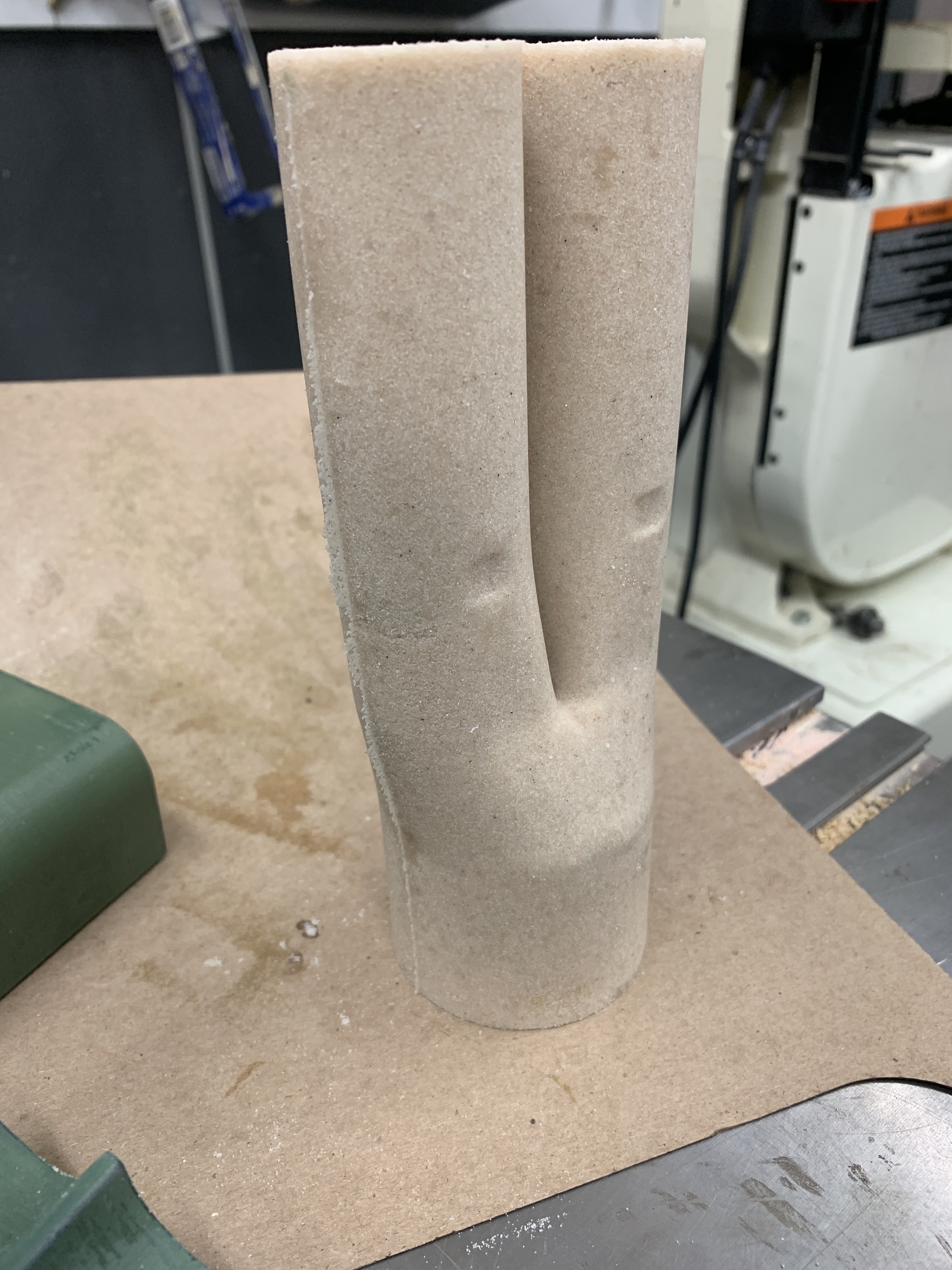

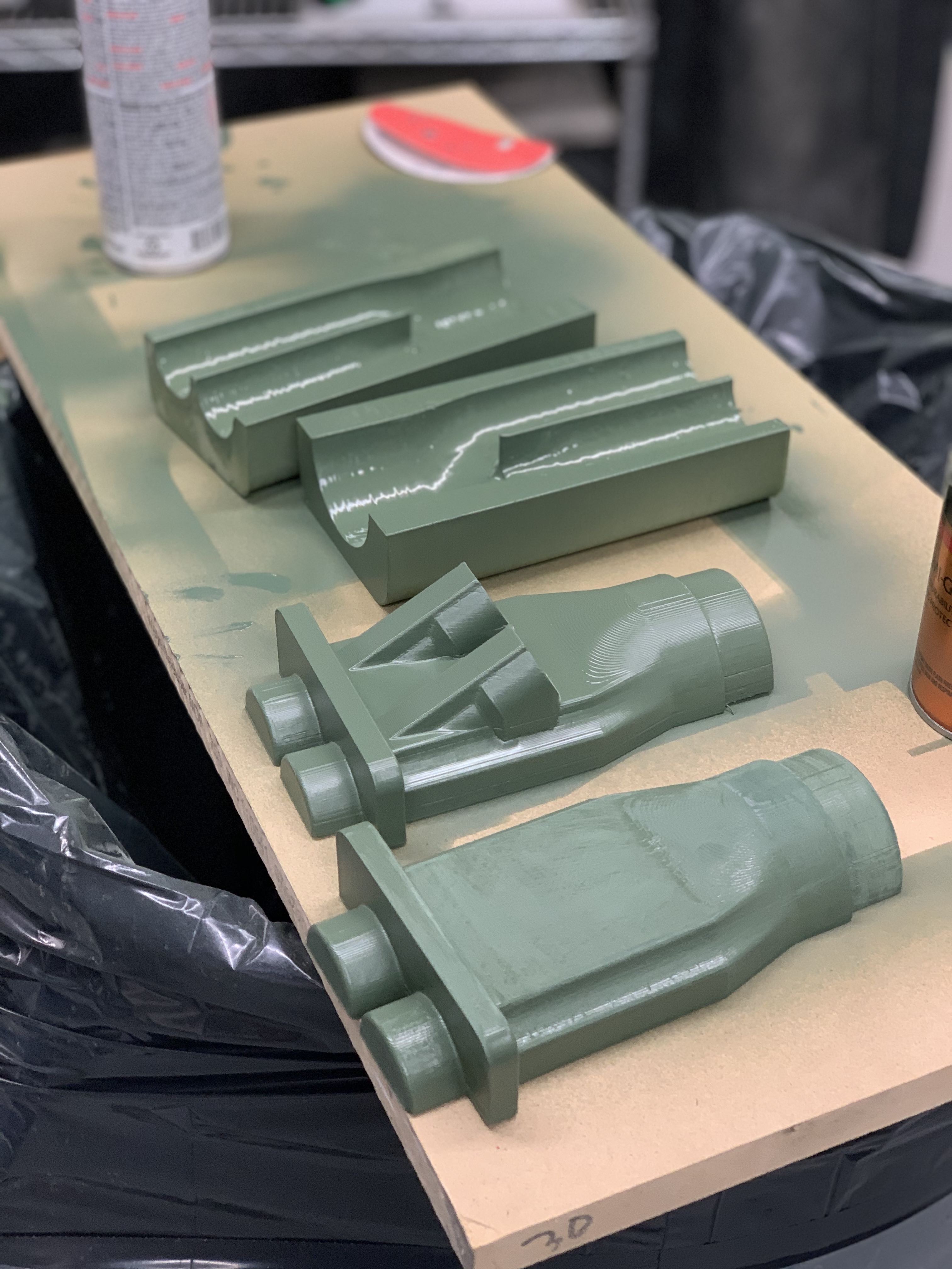

Got the patterns printed and tested the core with a mixture of sodium silicate and fine silica sand. This might just work out assuming things keep going as well as they have so far.

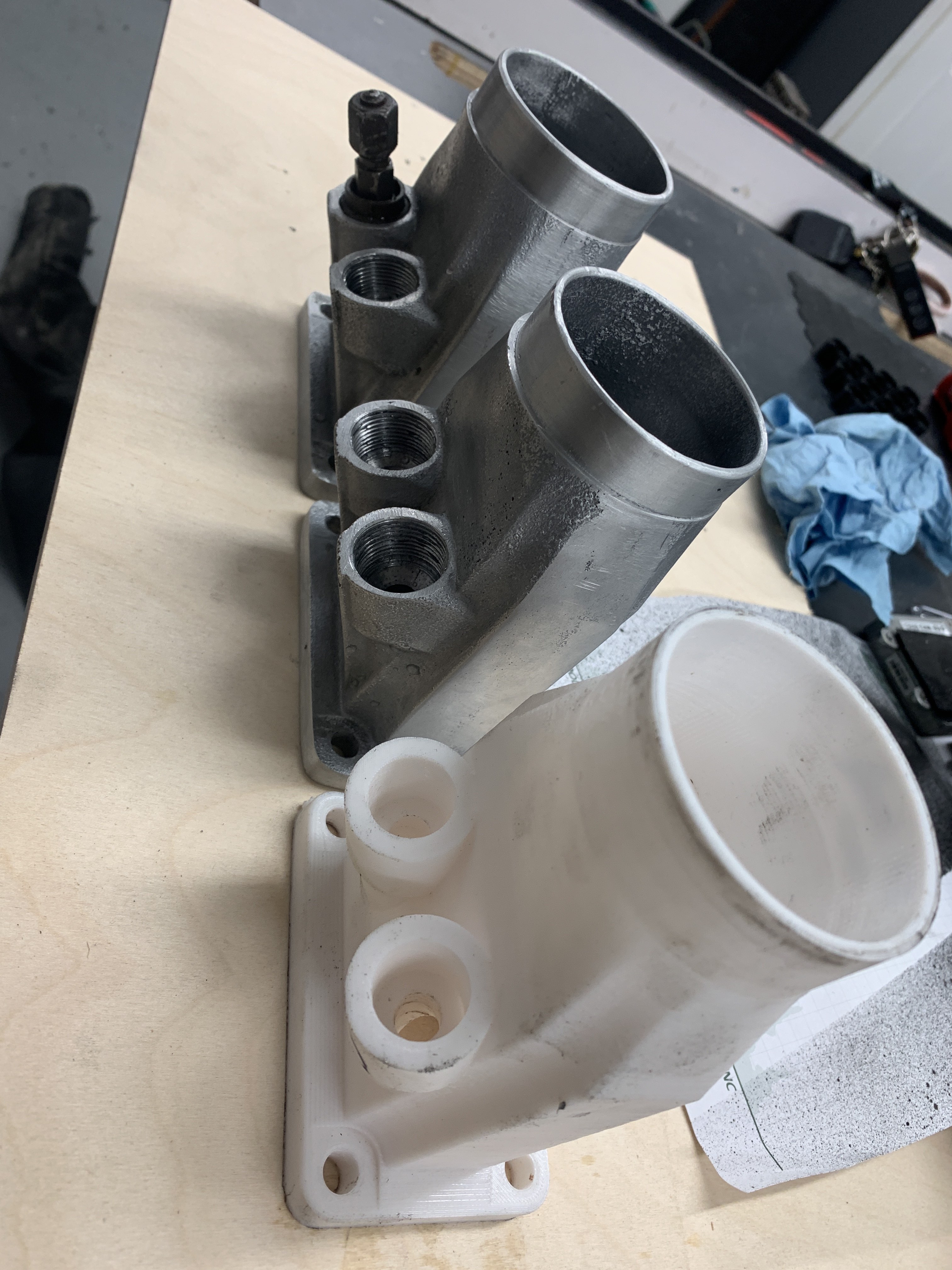

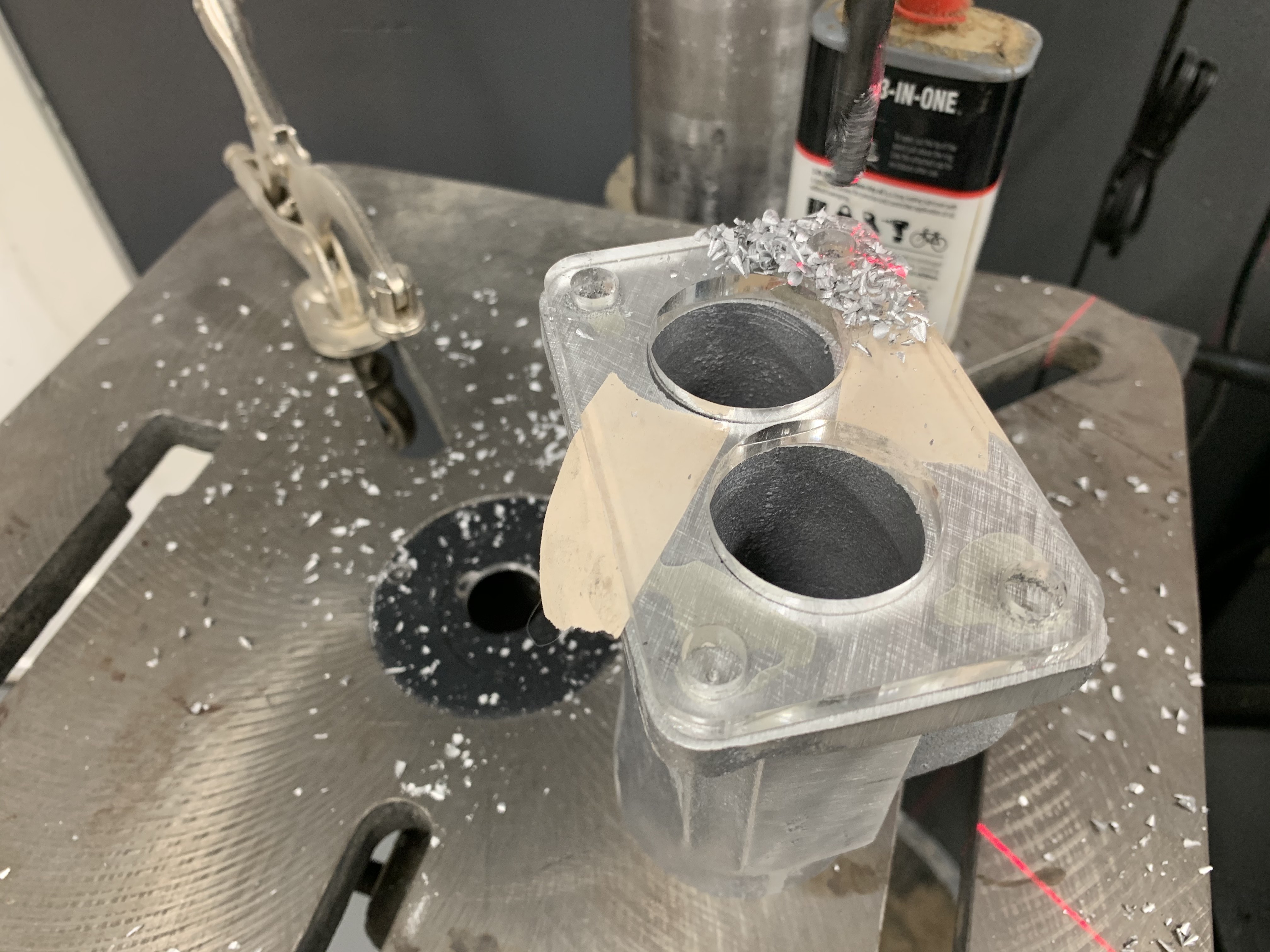

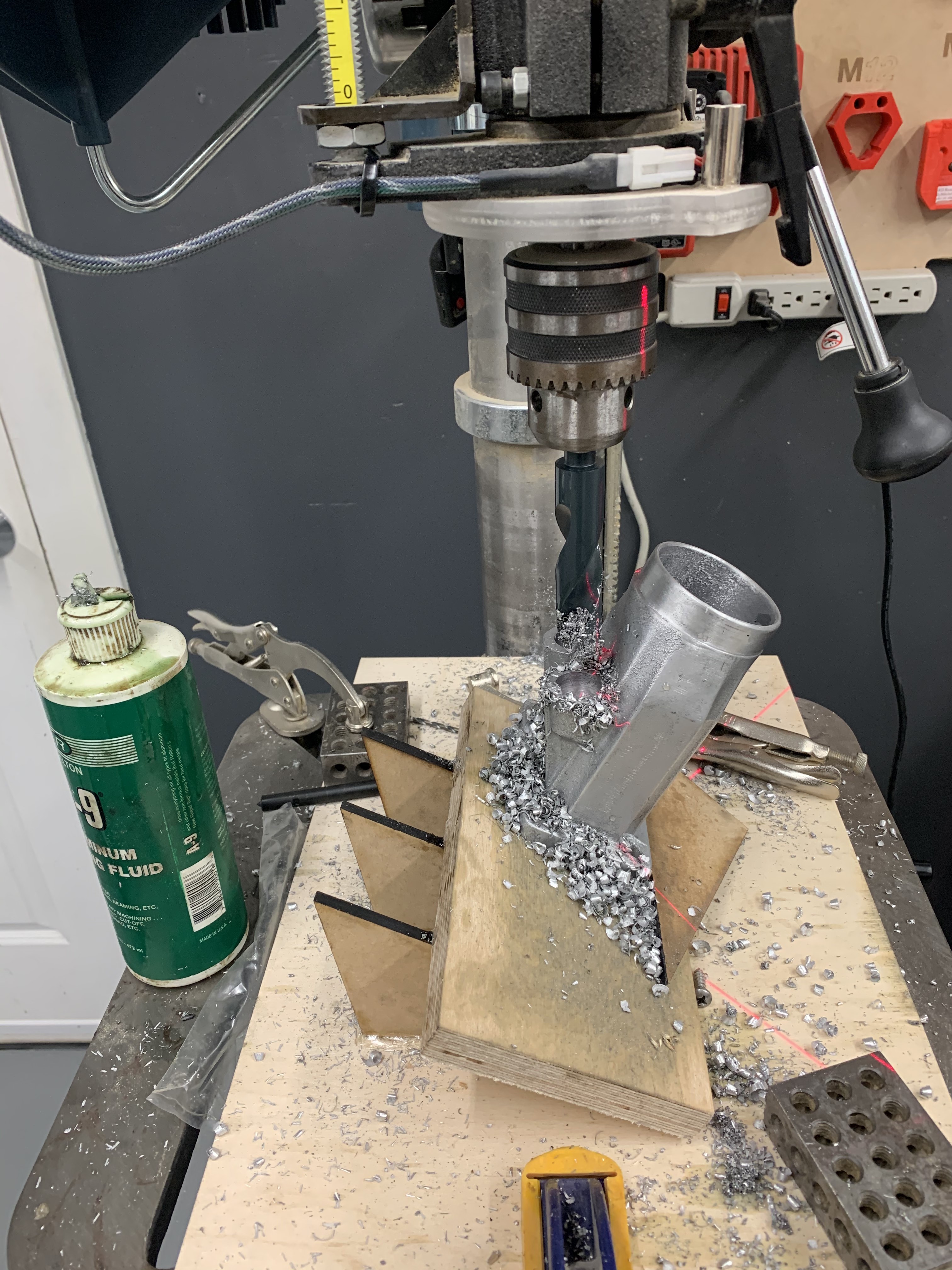

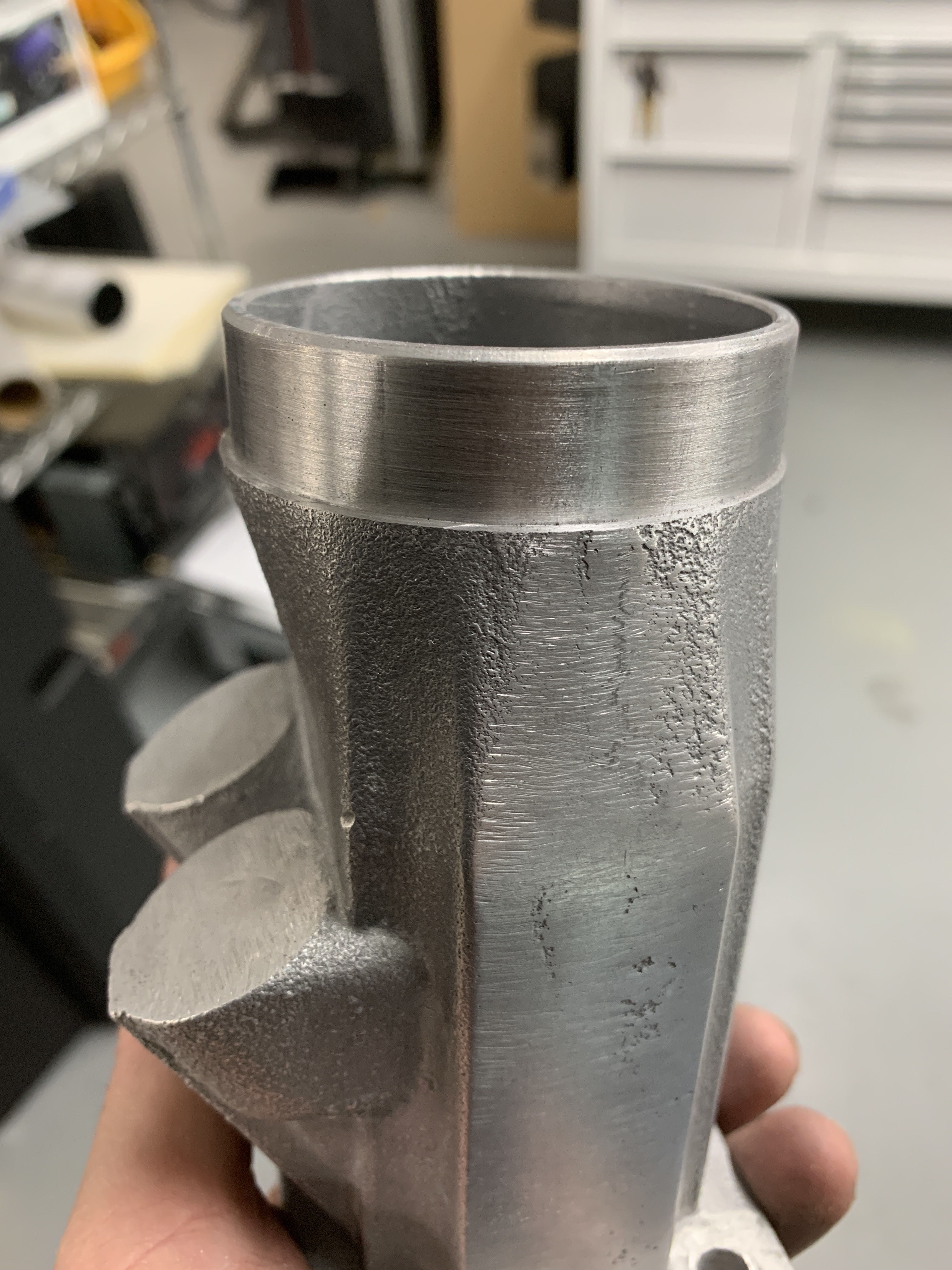

OK,I had some time to move ahead. Casting was fun. I first tried investment casting and failed spectacularly! Next I went with the sodium silicate method with way better results. I'm new to casting and still learning a lot.Oh how I would love to have a mill. Most of the machining was done with a router and a drill press. They fit with a nice and snug seal on the intake boots as I hoped. I am temporarily broke due to my business being closed for coronavirus vacation so progress will be slower where new parts are required.. Anyway, here you go!

Todays progress.

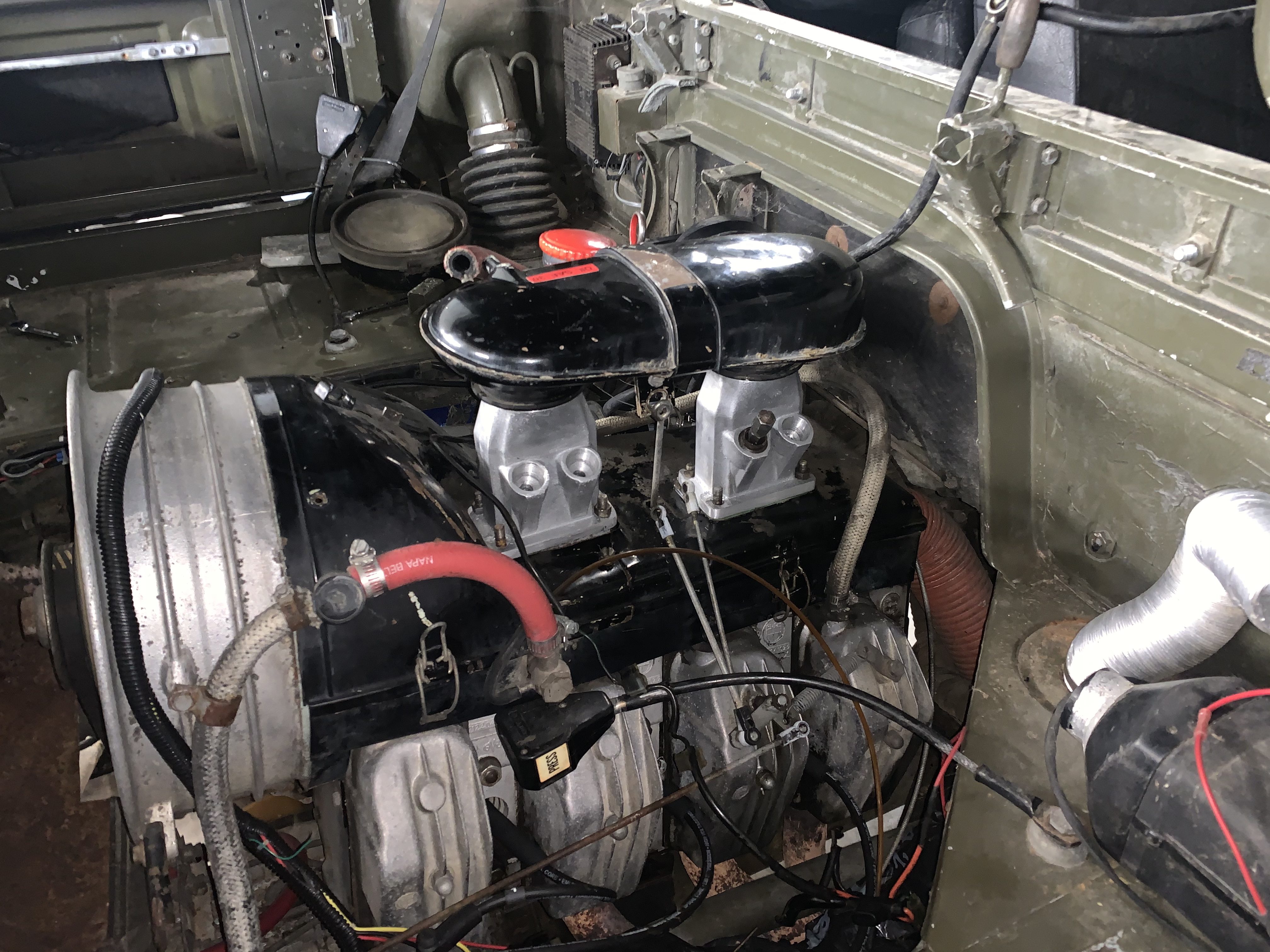

So far so good.Early this week I bench tested the system, cleaned the injectors, made a mason jar fuel tank, mounted up the manifolds and attached the TB with a plastic printed adapter to the oem accordion boot. It's not pretty or permanent yet in any way.
Today I recived the injector inserts in the mail and cobbled together the parts for a test. No cold start valve yet made idle on a cold engine difficult but that's ok. It runs! Now I'm off to make the TB mount and work out the bugs. Good thing I've got another month of COVID Sundays to work on it.
