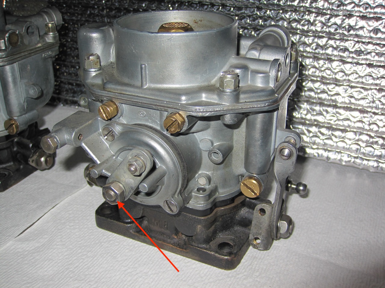

A close but a little off topic problem. The nut holding the fuel enrichment plate frequently comes loose on my front carburetor. You can imagine the result. Is there any predisposing reason for this to occur and is it ok to add a little thread locker? Thanks all!

The nut you're referring to is indicated by the red arrow if I understand correctly.
I've used a lock washer and had good results. You could also use a distorted-thread nut if you prefer. I don't see a problem with using thread locker either.

yes! That's it. Thanks!
