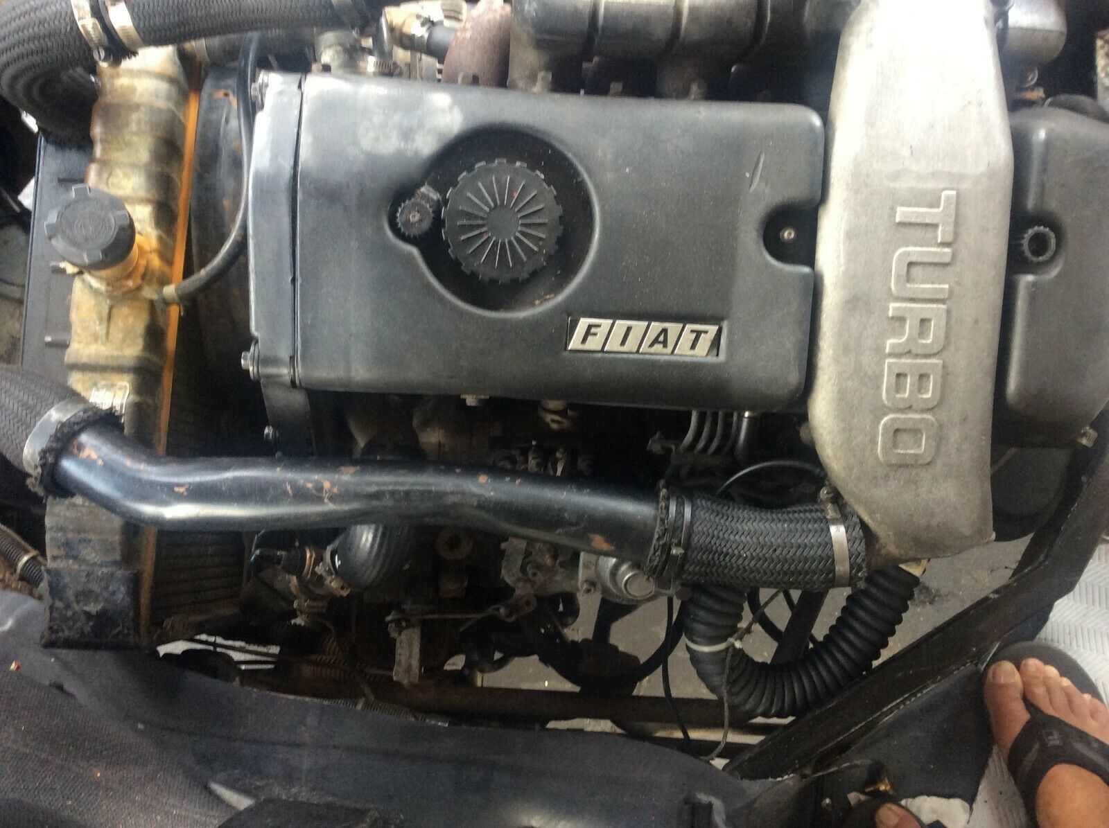

I will start working on 'Mad Iris', the Pinzgauer with an early Fiat Croma engine.

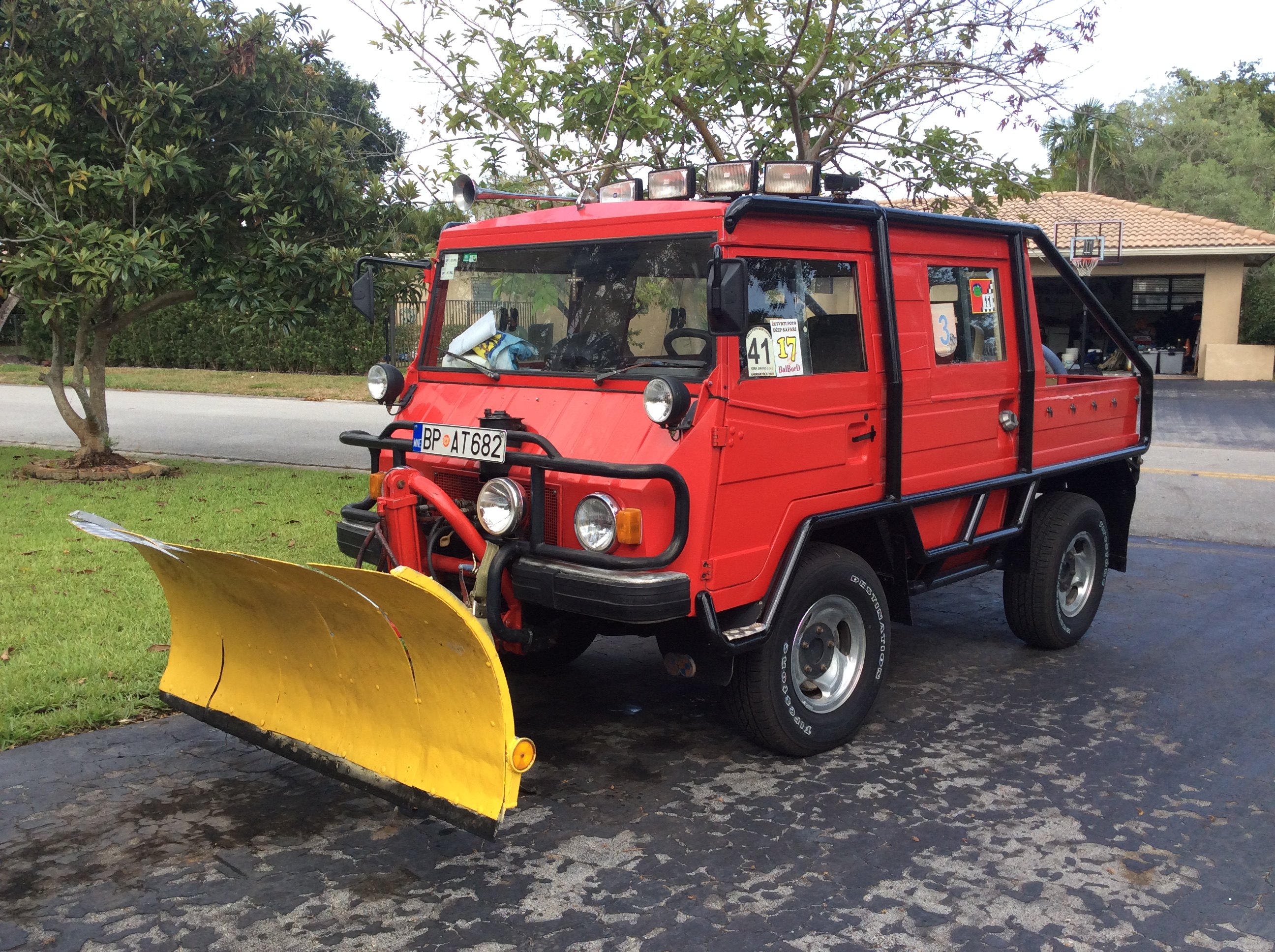

Vehicle: 1983 Pinzgauer - highly modified
Engine: Good folks on this forum helped to do initial identification. Guess is Early Croma 2500cc turbo diesel engine (Type 8144.91 | Version 154 AF 55 A)

@ChickenPinz, no, I did not hear the engine run yet. While transporting the starter bolt broke and I ordered it. I heard it and got a ride while purchase though.
The pictures are not current. The current state of engine is like a sieve with oil in it (exaggeration), but neverthess it definitely has leaks.

Same with wheels. If anything, I do not like the exo-skeleton and the wheels. I am thinking Transit wheels that were discussed on here.

And just my opinion, but I would drop that snow plow before the roll cage. And not the worst rims either, would probably look better with some off-road tires, if you can find some to fit.
I am biased though, I always sort of lusted after that truck. I hope you keep us posted on the progress!
