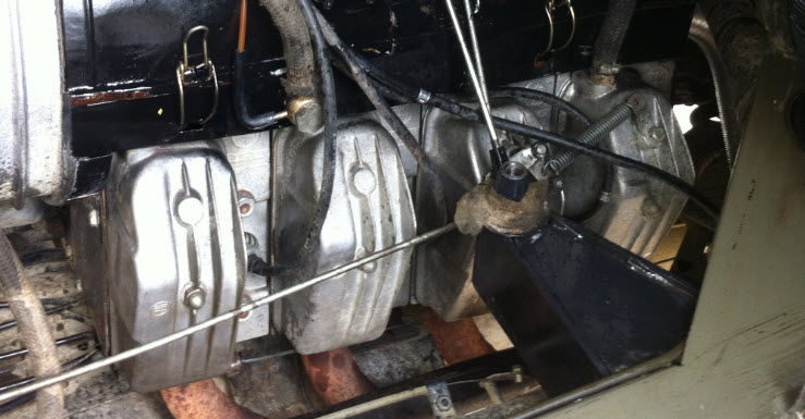

I do not have the original spark plug tools from the tool kit, and am curious what tools are available to remove and reinstall the standard military wires and plugs? I am not contemplating converting to a civ ignition at this point, just wanting to check and clean.
While I am not near the 710K at present, I think mine may have an Austrian updated seat belt mount that are not present on the swiss models, possibly complicating access. I have looked in my parts book and don't see these mounts listed. Are these on the Swiss models? The mounts require holes that go through the engine cover (doghouse) and look like they would make getting at #3 a challenge, or even possibly have to remove the mounts themselves to get access.
What tools should I have on hand to get at the plugs and unbolt the wires from the plugs?
- seat belt mount.jpg (63.89 KiB) Viewed 10698 times

Tough to tell via that angle. I can usually get a wrench in there from below to remove the plug wires, then use the spark plug removal tool.

Interesting seatbelt mount. Never seen that before. I think I'd just ditch the mount, and carry on. It only looks like a pain in the arse.
Re: Tools for spark plugs
Austrian refurbs got that mount, both sides. I think that is correct for all the refurbs.undysworld wrote:The original plug wrench is pretty handy for the job. I'm at a bit of a loss as to what might substitute.
Can't really ditch it, front seat belts are fastened to it.

That seat belt mount is not too bad getting in the way for #2 plug as it is hollow underneath so you can turn the plug wrench inside it.audiocontr wrote:THATS what that is. I couldnt figure it out! Weird and cool at the same time.

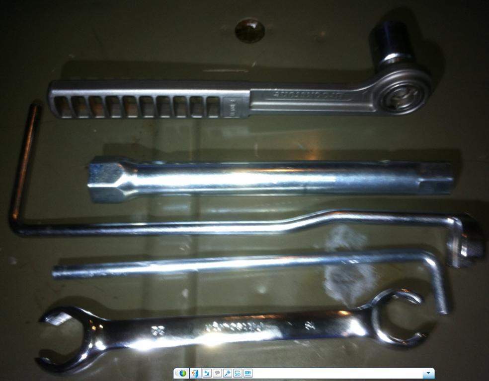

While Mr. Missing Pinz-Toolroll is awaiting an epiphany on a fan holding tool, I assembled a few finds to go ahead and check the plugs as they sit and only got to #1 and #2 (the easy ones) before dark.
1. The military tool for removing the spark plug leads is ok/slow going. Seems to me the right angle bend needs to be about 2" or 3" closer to the head for what I did so far, and especially so for #3 and #4 which I did not get to.
From the parts book it appears the Pinz tool kit does not seem to have anything like this so I have no idea how you normally would go after the plug wires??
2. The 13/16 plug wrench substitute is Briggs & Stratton Spark Plug Wrench 5402H that is a bit long but works just ok, better when you can get a 19mm rachetless socket wrench on the other end. It needs to be a hair thinner especially where it is near the valve covers, so I may take a grinder to the part at that point.
I had to call it an evening before getting to #3 and #4, those look harder to reach by far. #3 probably by hanging from the ceiling and maybe #4 from underneath?
Any tips on those more skilled at reaching #3 and #4 plugs appreciated.
Thanks.

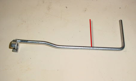

That wire tool is not a part of the original tool kit, but it does a great job on the mil wire ends. I came to the same conclusion that the handle was a bit long and cut the handle off and put in a new bend to make the handle shorter.

Modify like this. I never got around to it, but it was on the plans
ChickenPinz
- Posts: 442
djw wrote: Tue Dec 08, 2020 7:00 pm Modify like this. I never got around to it, but it was on the plans

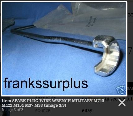

That bottom image is the kind of thing I've been thinking about. I just need some strong wire stock, a ground off crow's foot, and some time on the welder. Or does that thing already exist off-the-shelf for 19mm? I've seen images of them (below), but none for sale quite yet.

https://www.ebay.com/itm/M38-M38A1-M151 ... SwMSxfzUk5
You may have to cut the handle down to make it fit the pinz space (or lack thereof). 19mm = 3/4"

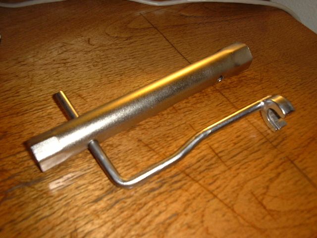

As far as pulling the plugs after you get the wires off, the only tool I found that works on all the cyls is the original pinz tool or the one that Willi had @ SAV, in my pic above. Long enough to reach and then turn with a box wrench or the key. Austrian rehab pinz seat belt mounts really, really get in the way but should be easier on anything else.
I had zero issues with the OEM spark plug wrench adapter, and was easily able to put my torque wrench on the end of it to ensure proper tightness. Even the rearmost cylinder wasn't an issue. Uncle Steyr thought about this it seems.
