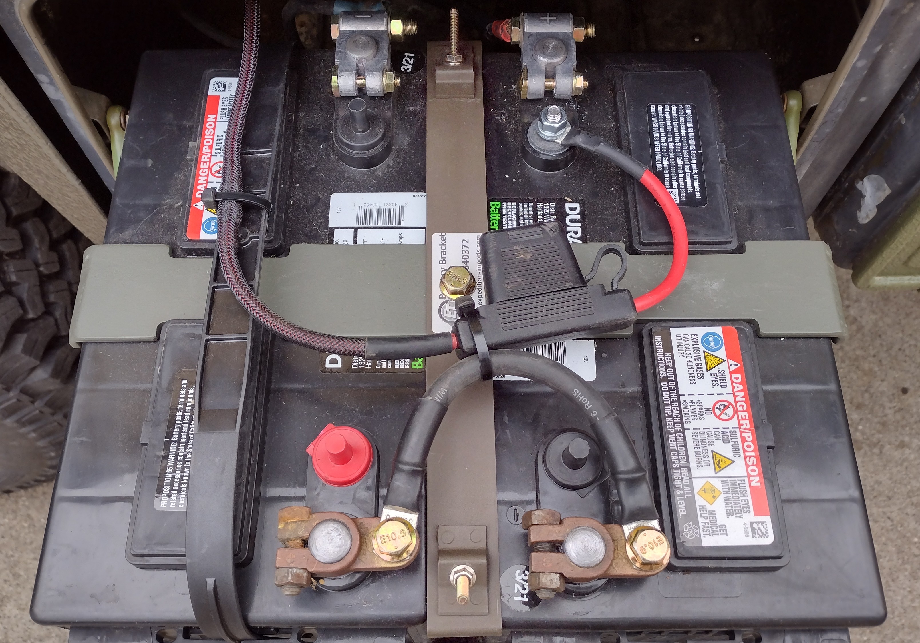

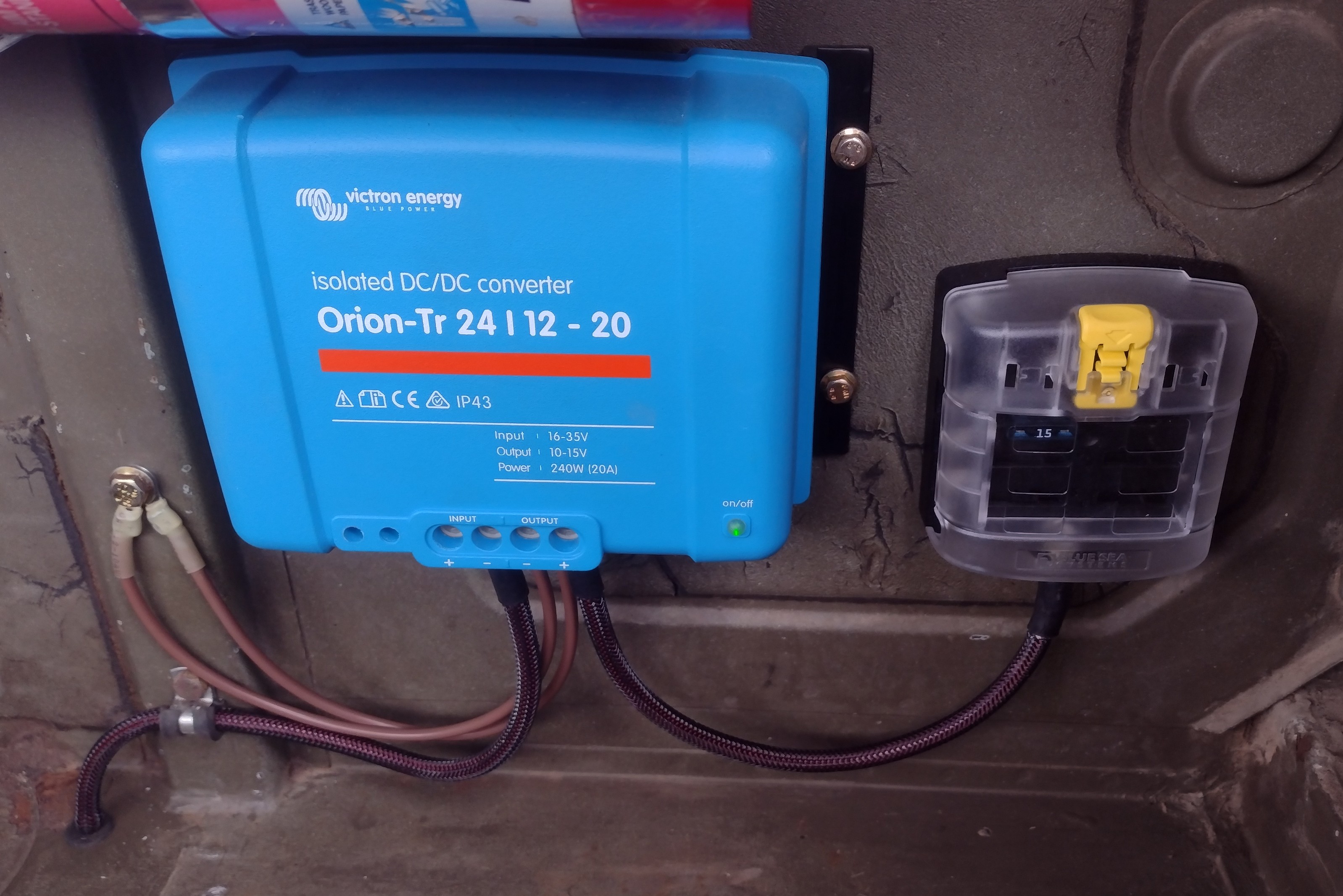

Made a little progress on my converter install recently. I've got the main power run from the batteries using 8ga marine wire, with some braided sheathing over top. Overkill for a 20 amp converter I know, but I had it on hand, and if I ever need to bump up the converter size I should be good for another 30 amps or so.
The one thing I wasn't entirely sure about were the grounds and if a shared location would be troublesome for any reason. Part of me thinks that the body is all the same ground so it shouldn't matter, but then again, the converter has two separate ground connections so maybe it does?
A Maxifuse protects the whole aux converter circuit.
I also added a cross sectional bracket to the batteries to keep them more secure. I really can't see how the factory bracket does much to secure them. Every time I opened the box door it seemed like the factory brace had slid off one of the batteries, but now it all stays put. Maybe different battery shells from the original to the current or something. A new 2ga tie cable replaces the old haggard one and cleaned up terminals round out the refurb...for now. A new 2ga main cable is on the list.

Your Ground connections are perfectly OK.
