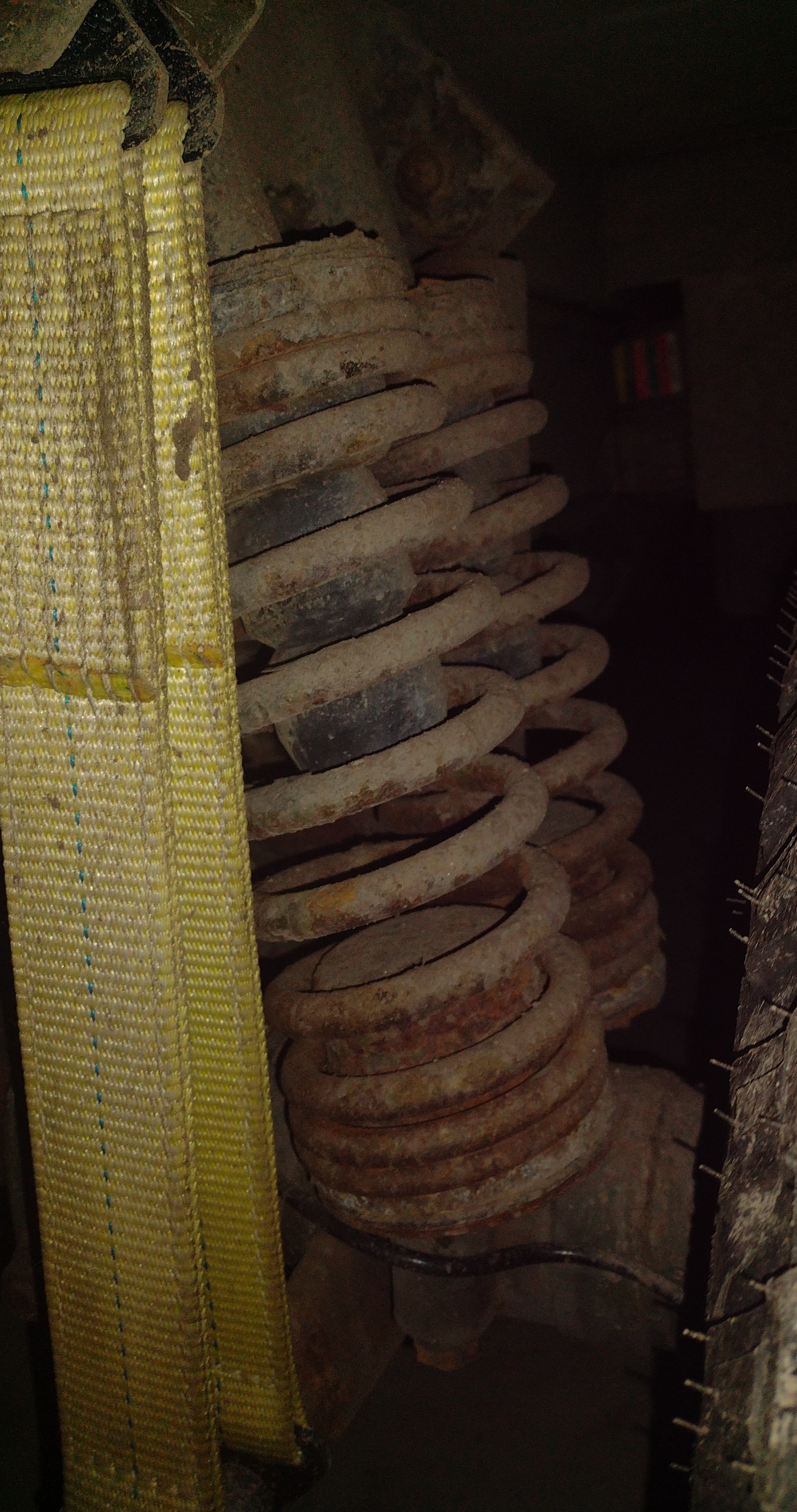

There were no discerning marks on the rear springs but the spring cup pins measure out to be around 135mm from the top of the bolt to the tip. This seems about right as my spring cups are fairly close to the axle, but that could also be because my cups are severely corroded!

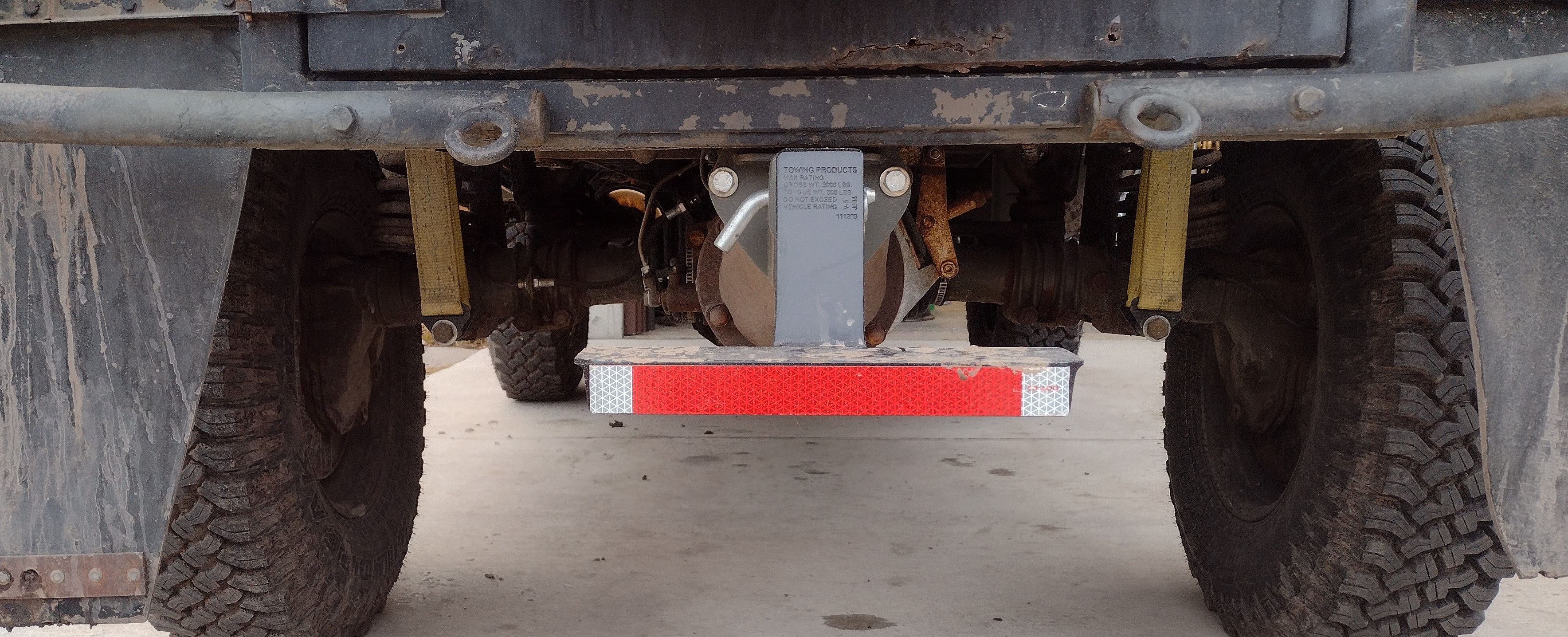

Here's a pic of what I'm working with. The replacement limiting straps are the same length of factory straps I removed...I believe they were 17.5" eye to eye.

Hmmm, Ah Ha !! Well clearly those aren't OEM limit straps.
Looks like OKoffroad Nylon webbed. For the Pinz, these straps
are sold with a recommended length of 17.5" C-to-C. They can
be ordered to lenght, sooooo....if yours are short they can be
replaced with the recommended 17.5" or if that's too short then
a custom build can be ordered.
Here's a link to their site https://okoffroad.com/stuff-susp-limitingstrap.htm
BTW that duo of garaged Pinzie's is yours truly -- I DO NOT use synthetic straps.
I do get my recovery gear from OK including Ramsey winches. Didn't know this PIX
was on their site in that section 8)

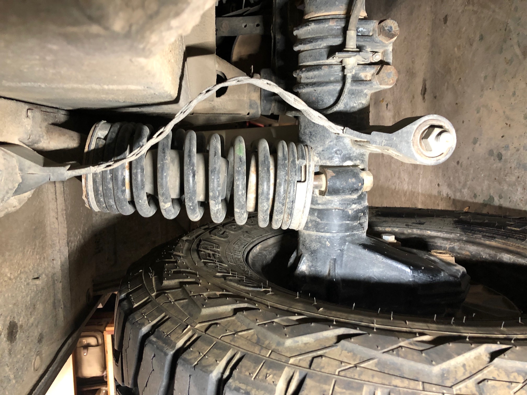

I have included a PIX of my 710K rear end, no significant load in the rig.
Also of note my springs are new, mid-strength. Total of 11 turns.

So the OE rear limiting straps were snapped in half when I first got the Pinz, so I went ahead and replaced them with those OKOffroad ones. I verified the length of the old to what OK offered and they were the same. No complaints with them so far, they seem to be doing a fine job.
My Pinz is nowhere near as clean as yours, nor will it ever be lol, but here's a better shot of where I'm at.
You can see the distance between the bumps and lower cups are greater on mine. It also seems like the coil count is the same...hmmm. You can also see that my lower cups are kaput! But look at that shiny new hardline, oh yeah!

So the straps are indeed 17.5" eye to eye. The springs, measured from the top of the cup to bottom of the cup come in at 11.5", so 1.5" longer. This would explain the difference in ride height that I'm seeing from front to back.
If my pins are about right, the straps are right, but my springs measure different, that can only mean the springs are too long correct?
Are the springs on a 716 different lengths and swap in? The history is vague on this one so who knows who did what.
