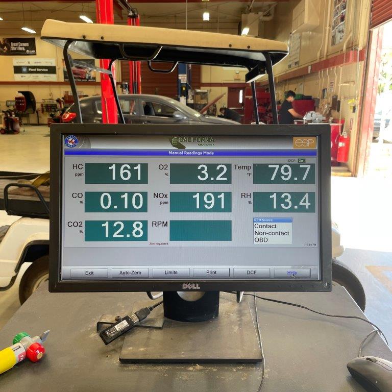

I checked the exhaust on my 710M and got these numbers. It is important that the engine is at operating temperature.
This engine has PinzSSI, so there are 3 sparks at the power stroke and the exhaust stroke. If the mixture is really rich there can be an exhaust backfire,
which is a carburetion problem, NOT an ignition problem.

Posts: 937
Location: Indio, California
Re: 710K failed emissions
Post by pinzinator »
High hydrocarbons indicates a rich mixture or not enough air (plugged air filter). The float(s) or a needle valve could be sticking. Timing at TDC can cause higher HC due to less burn time. Advance the timing.
