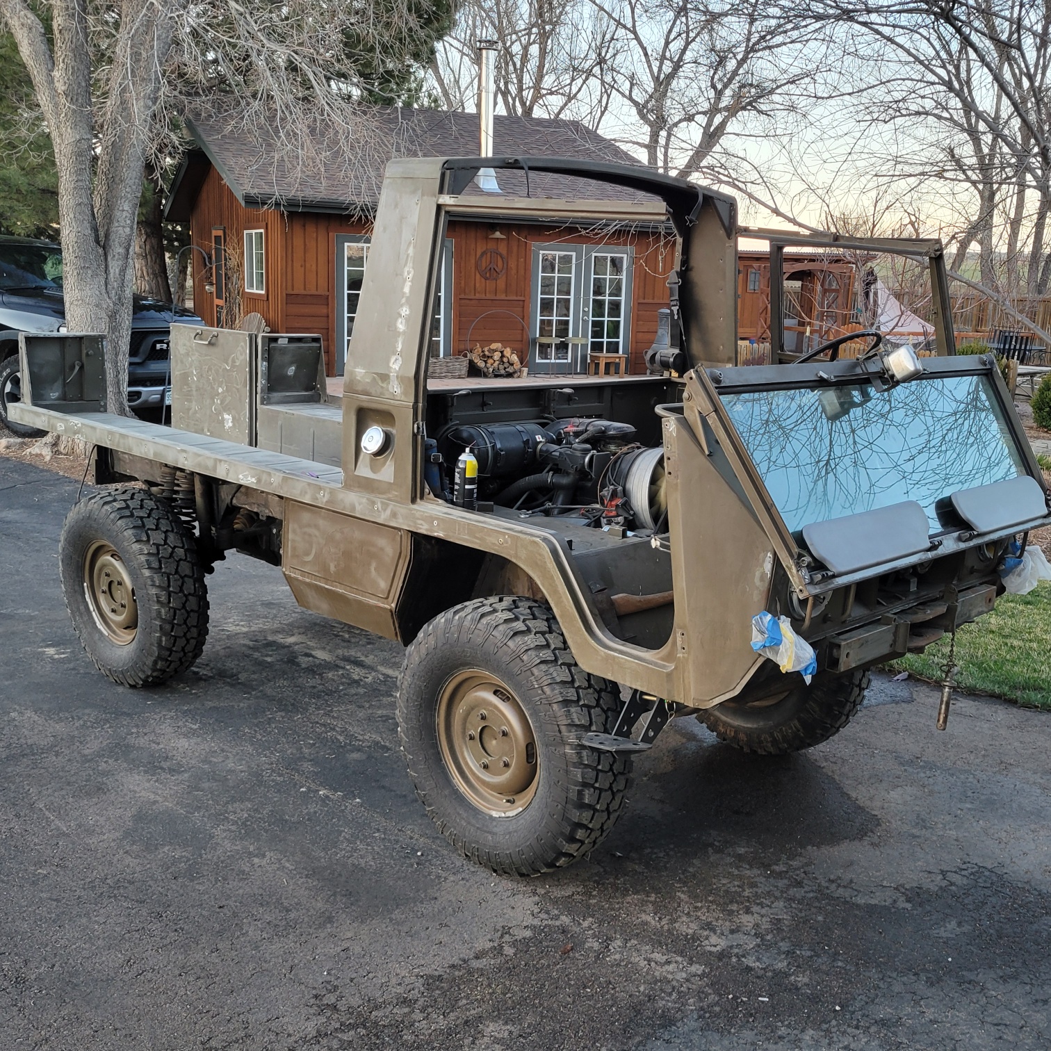

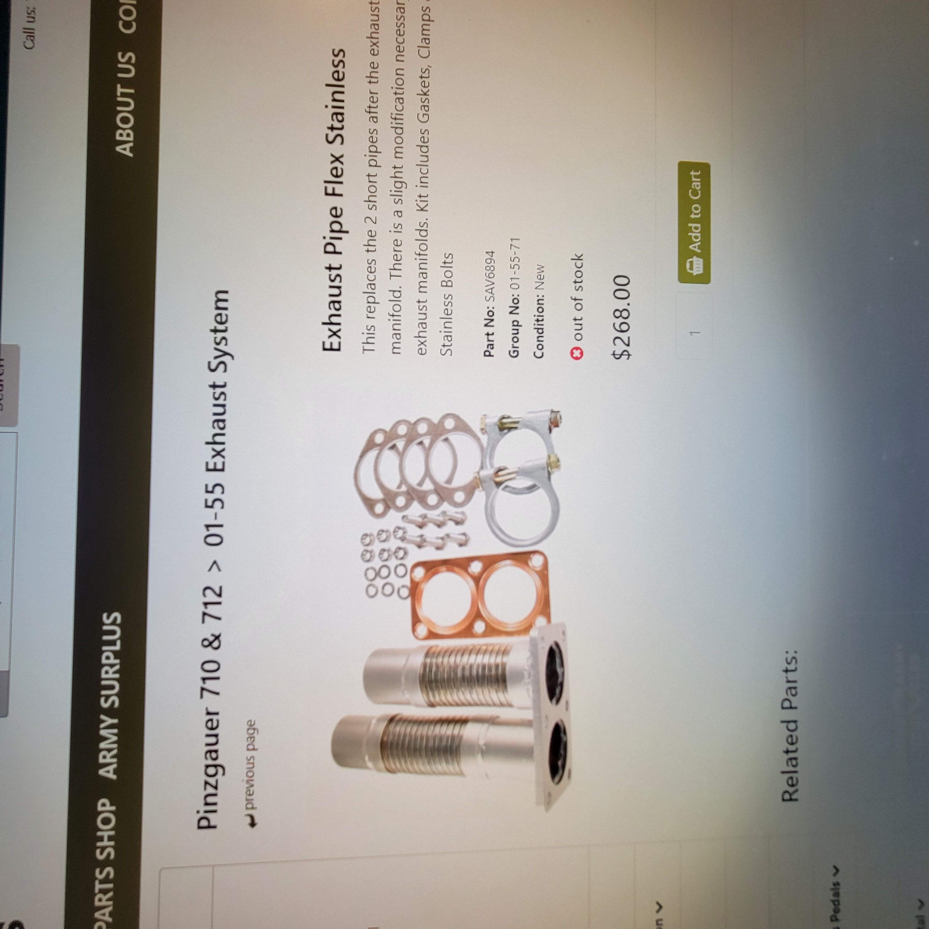

Got one of these stainless steel exhaust pipe flex kits from SAV. Just wondering if anyone else had this rig and if you painted it? It looks great now lol, just wondering how long it will look good in its original form or maybe I should put some high temp paint on there before I install it. FYI, getting some of those bolts off on the headers made me question my will to live..... Many thanks.....Ron

Should be Stainless Steel -- no paint necessary.
At least mine are..
