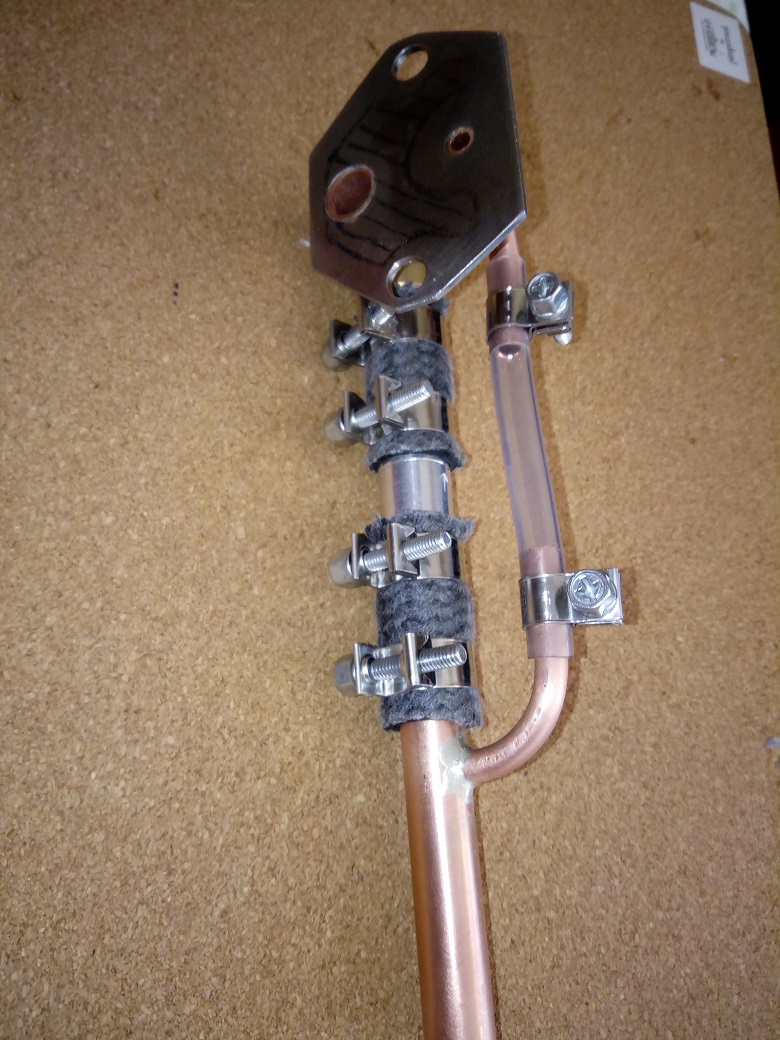

OK one picture...
It attches underneath the throttlebody, the 12 mm breatherhose is via a one-way-valve going before the butterfly-valve and the 'smothered' small 6 mm hose after the butterfly valve to "better airflow over the throttle body"
Weather it all helps... I also have a small oilcather-can installed, no picture as yet, but if wanted I will make a picture and show how to install that one.
Remember this is all for the EFI setup, with the carbs I would leave everything as is... and also believe the oilfiller tube works as a oil misty catcher...
Jules

- IMG_20240423_091632.jpg (317.26 KiB) Viewed 4323 times
