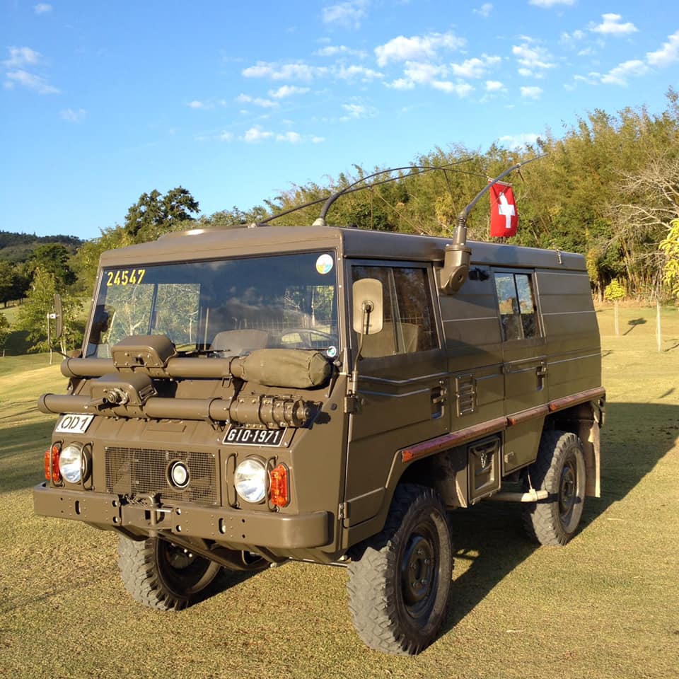

I'd like to find or replicate the original accessories that would be clamped on the front of a 710K. Some folks just put PVC tubes there, but I want to match the original parts as best as possible, presuming they don't exist.
Can anyone help with pics, dimensions, links, etc?
I see these https://swissarmyvehicles.com/pinzgauer ... ic-6-meter also, but it seems unlikely to me (maybe I'm wrong) that a truck would have two of these clamped in up front. Thoughts?

They are not "tubes". They are a telescoping crank up mast. Not very tall, 6meters and I believe they were made by Geroh. SAV has one in stock.

I now have one of the antenna masts from SAV. They're pretty sweet, actually.
Model is Geroh 5985, 6m
Manual attached.
19ft4in from bottom to top when fully extended. Takes a 1.0in mast of up to just under 4ft into the top section, so in the end it'd be about 23ft tall if you kept the whole thing collapsible.
