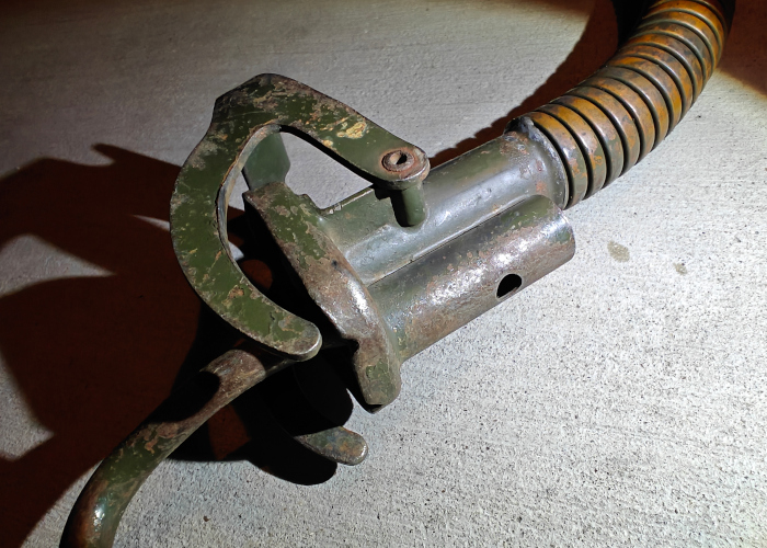

I have what I believe is the original spout for the Jerry can. It has worked well for many years, but I used it the other day and gas poured out of the breather valve and made quite the unexpected mess. Gas was coming out of the breather. I took it apart and waited a few minutes. I tried it again and got the same results. Can someone explain to me how this breather works? Why would it suddenly fail so poorly (pun intended)? Is there some sort of rubber gasket or something in there that could have worn out? Maybe something got stuck in there? Thank you.

You sure the breather spout is still facing up when its inside the can? Cant tell from the pic which way its facing.

Yes, facing up when in the can (not in the picture).VinceAtReal4x4s wrote: Mon Oct 07, 2024 3:11 am You sure the breather spout is still facing up when its inside the can? Cant tell from the pic which way its facing.

Without breaking down the the physics of the spout's function, my experience is that it works optimally with an aggressive pour. When attempting to pour just a small amount of fuel from a full can I'll often experience the behavior that you described. However, when dumping a full can into the Pinz, spout in and immediately bottom up, it rarely leaks any fuel from the breather. It all probably has to do with the flow rate out of the can generating adequate vacuum to draw a steady flow of air through the breather against/through the fuel within.

Are you aware of any moving parts within the breather? Anything which could wear out? Springs, flaps, seals?Mr Zero wrote: Wed Oct 09, 2024 8:22 am Without breaking down the the physics of the spout's function, my experience is that it works optimally with an aggressive pour. When attempting to pour just a small amount of fuel from a full can I'll often experience the behavior that you described. However, when dumping a full can into the Pinz, spout in and immediately bottom up, it rarely leaks any fuel from the breather. It all probably has to do with the flow rate out of the can generating adequate vacuum to draw a steady flow of air through the breather against/through the fuel within.
It's just baffling to me why this would suddenly become an issue after so many years without an issue.

I'm not. I believe it is a static air inlet, but I could be mistaken. I just examined/blew through one of mine and there is zero indication of any valve components. Is it possible that the breather tube that goes into the can may have been bent such that it's position when fitted is misaligned from it's intended design? For reference I've included a pic below of a properly functioning nozzle. The angle of the breather tube into the can is a little greater than 90 degrees from the external inlet part of the breather.dbixby001 wrote: Wed Oct 09, 2024 10:10 am Are you aware of any moving parts within the breather? Anything which could wear out? Springs, flaps, seals?
I'd get a second one while they're still available. They won't be around forever and not entirely unlikely that you'll lose or damage that one eventually (if not already the case).

I'm going to chalk this one up to the can being too full. I attempted it again and got more spillage than I would have preferred, but after a while, it worked as intended. I guess I filled the can more than I ever did previously. Lesson learned (hopefully).
