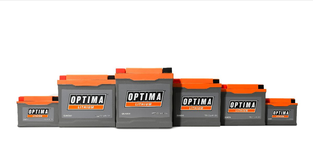

So these are being marketed for power sports vehicles so far but then the Optima rep says they tested it in a Ford Raptor. How far is this from the requirements of a 4x4/car? The Ah is low on these. I also wonder about really cold weather and the possibility of the low shut-off feature causing issues.
Seems like the biggest issue for them marketing these for cars will be charging since alternator circuits have been designed for lead.
The biggest one weighs only 7lbs and has 800CCA!!! That's a big deal.

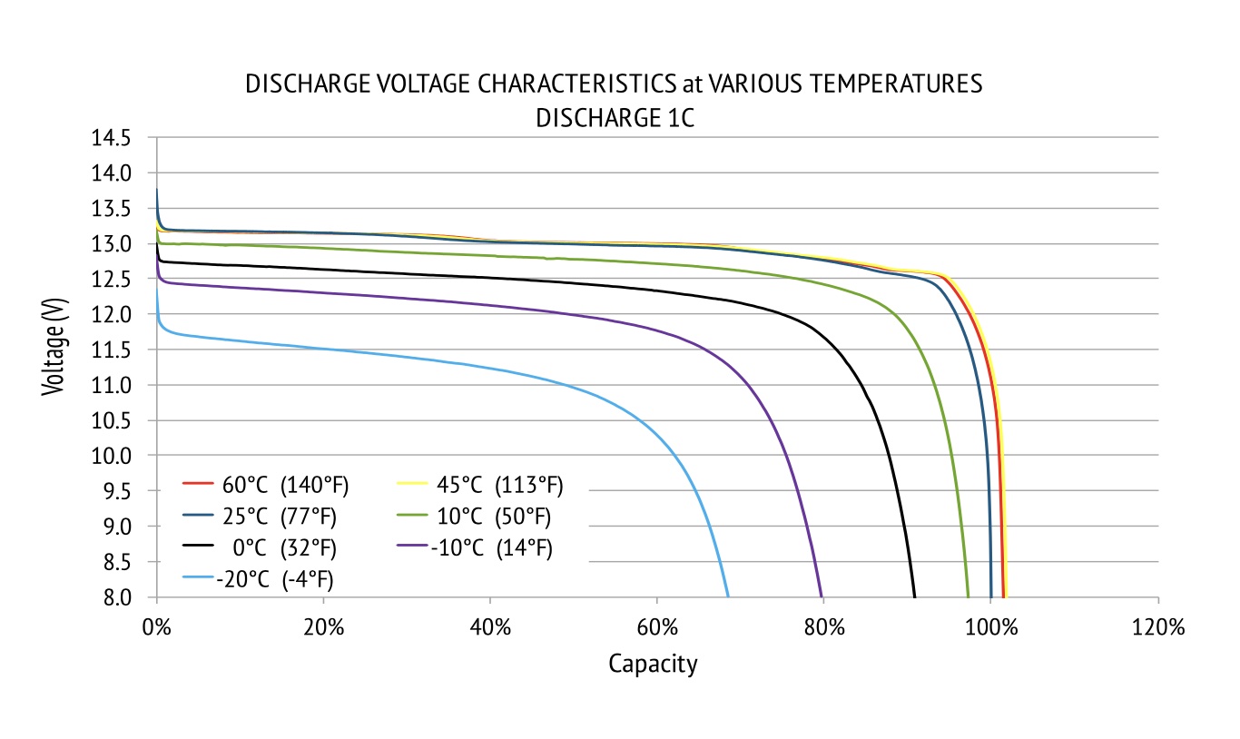

Output voltage and effective capacity drops with temperature, it's certainly
noticeable at 32F but sufficient for most applications, but at Zero the output
and capacity take a nose dive. So it all deepens on where you live. Below is a
chart from Relion for their LiFeOP4 batteries which will be pretty much the
same for this chemistry for all manufacturers.

1C discharge voltage vs. temperature is interesting, but only relevant if the engine starting current is comparable to the 1C discharge rate in the graph. I've not measured a Pinz starter in cold conditions to know what current is representative. CCA is what we need to know.
Another issues is charging, which needs to be carefully controlled (or avoided) at cold temperatures to prevent lithium plating.

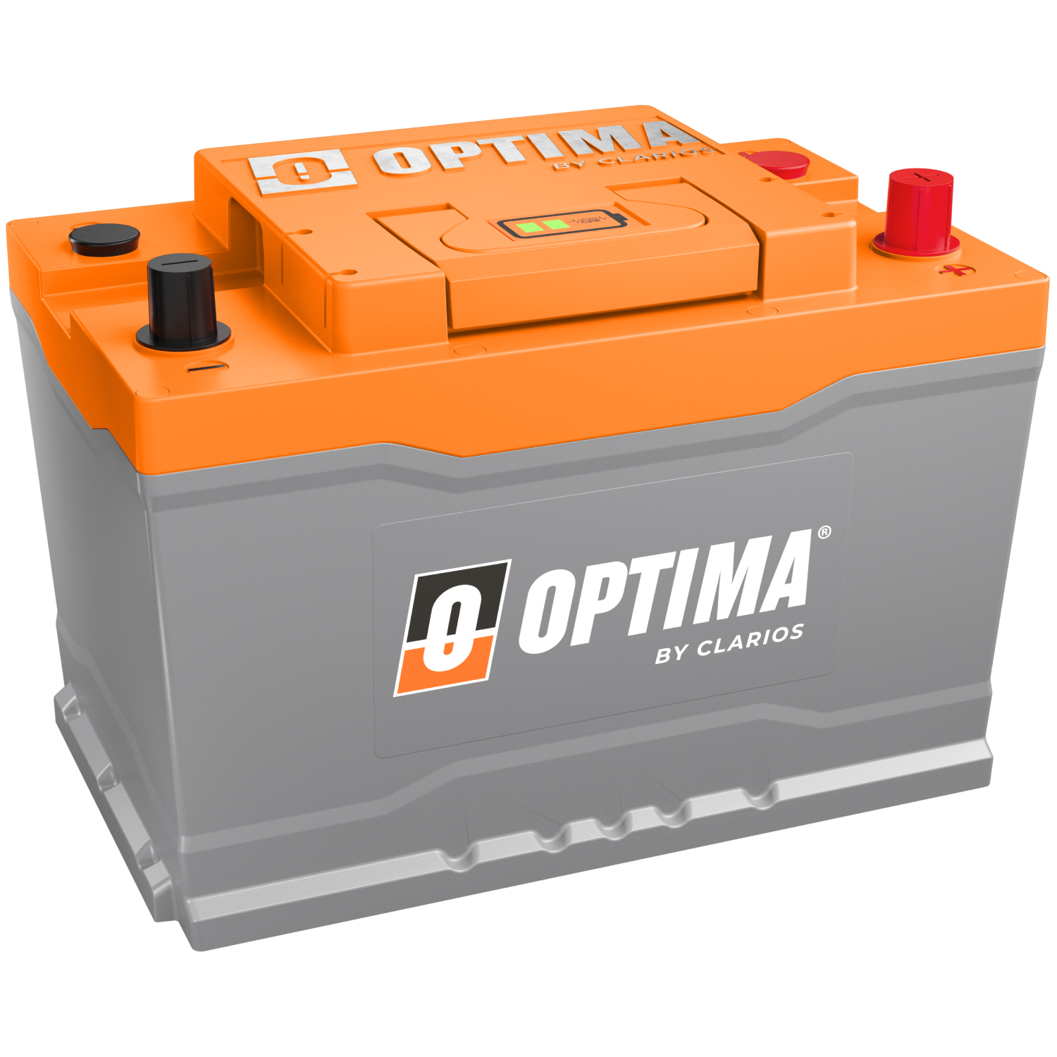

Looks like a full production "car/truck" version is now available.
https://www.optimabatteries.com/products/orangetop-qh6
OPTIMA ORANGETOP™ Lithium Dual Purpose Battery
Dual-purpose battery for both engine-starting and deep-cycle applications.
Market-leading 880A cold cranking power at 0°F, with extreme performance down to -20°F.
Built-in jump start (OPTIMA CPR) automatically disconnects your battery when it's being drained and reserves enough power to start your vehicle, and can be automatically activated with the OPTIMA Bluetooth app.
Industry-leading communications via Bluetooth app to displays battery status including health, state of charge and usage, current, temperature and alarms for BMS functions.
Advanced microprocessor-controlled battery management system (BMS) automatically monitors and controls all functions.
BMS-balanced cell state of charge for improved performance and extended life span.
On-battery controls and status LEDs.
QUAD terminals for easy installation of accessories.
Robust design with industry-leading vibration, dust and water resistance.
Integrated protection from alternator "load dump" in the event of BMS disconnect.
Optional POWERLINK system for convenient battery control, state-of-charge indication and an easier way to connect your charger.
A lithium charger, or lithium charging algorithm, must be used for charging lithium batteries.
Normally, no charging system or other modifications are required for use in cars and trucks.
Fitment Cross Reference: H6 / Group 48
