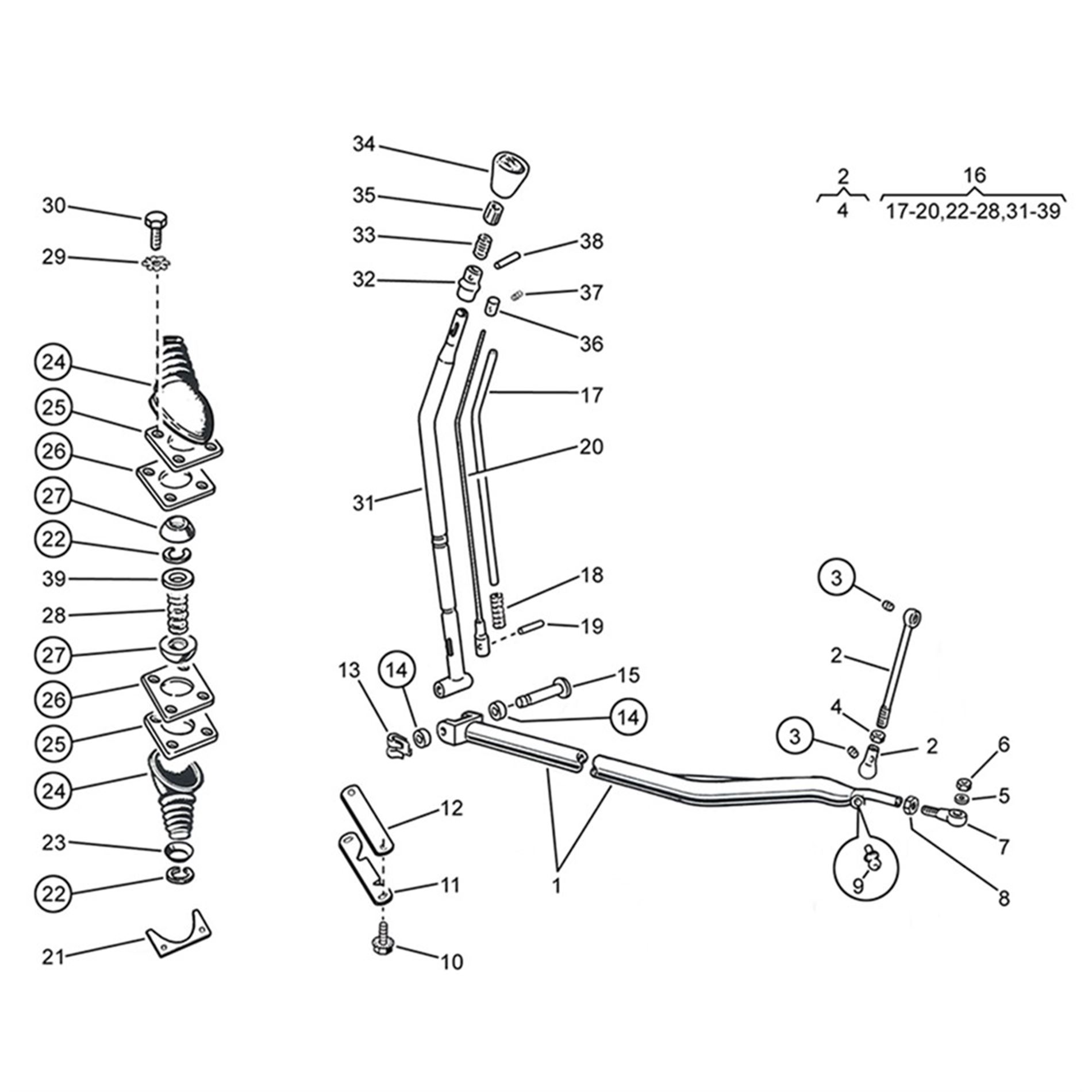

These are the parts you should see on your 710, Austrian army version.
https://www.puch.at/en/products-&-spare ... ift-lever/
Did you just buy it and it never worked ?
Or was it working before and it stopped ?
Maybe share some pictures.

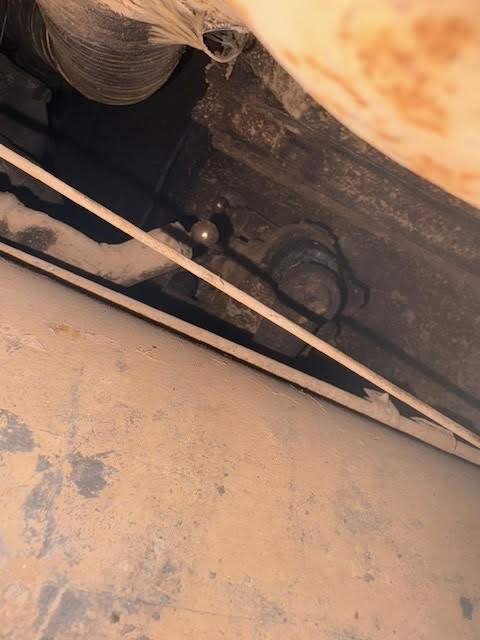

I'm trying to put the pic in. Computers are a problem for me. Sorry

difficult to judge from your picture,
but i just made a short video showing how my 710M is attached
show this video to your mechanic with the exploded view above, then he wiill be able to tell you if something's not right.
