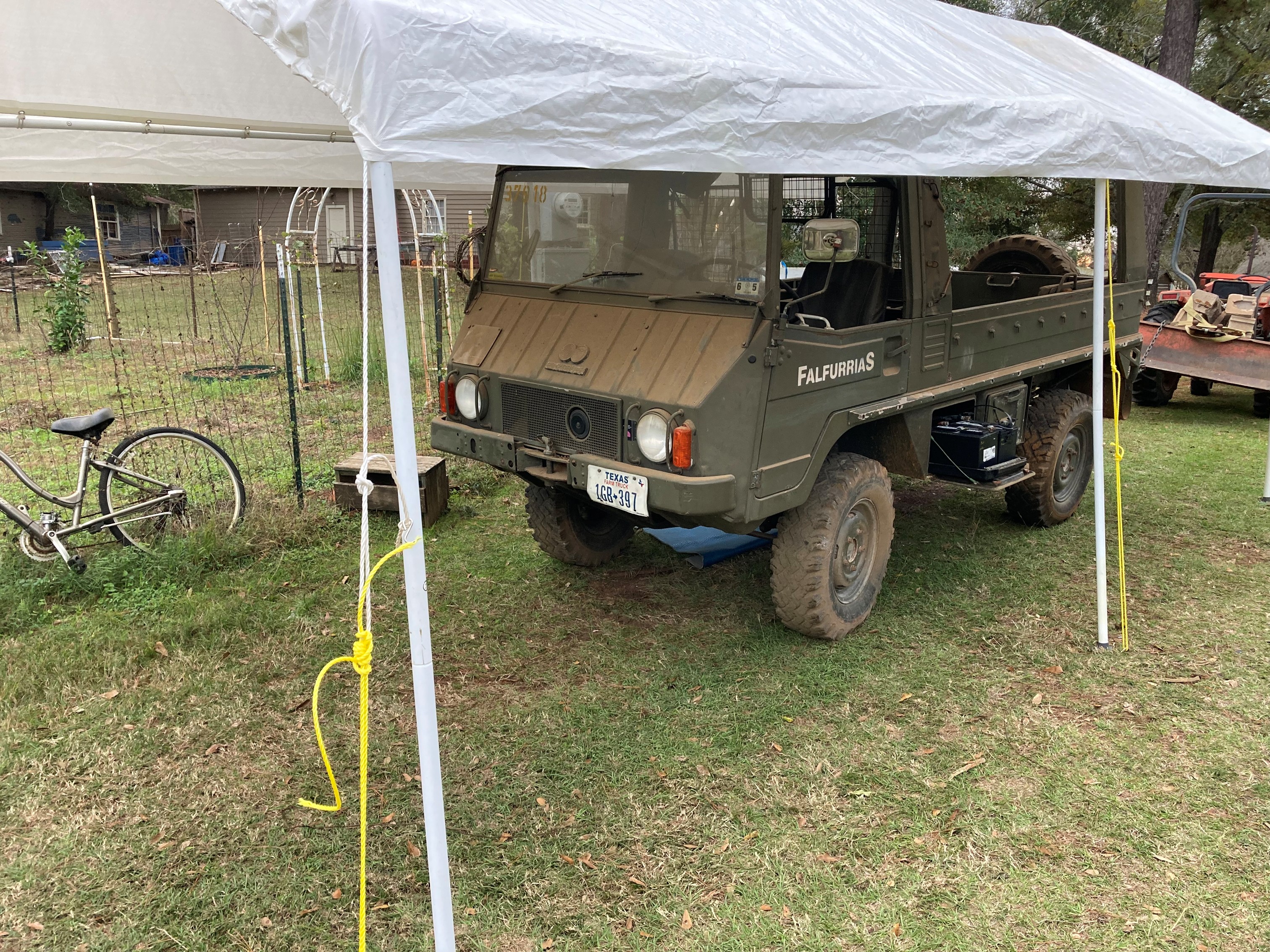

New to the forum. In 2003, my dad purchased a Pinz 710 M from a friend of mine, and it ran great for many years. We drove it all over the ranch in Falfurrias Texas, and it was unstoppable even in the deep sand. After my dad passed, my mom did not want to pay for a dual carb repair and the Pinz sat. After five years in the barn, I have started to rehabilitate the Pinz 710. After replacing the batteries and fuel, miraculously, I was able to get the engine running but with a heavy blue tail pipe smoke. I'm going around and cataloging problems, and my next big issue is the stuck clutch. Parked on a downward slope, I started it in first gear and was able to drive it around but unable to change gears. The clutch peddle is very soft. I purchased a manual from Expedition Imports and saw the great posts viewtopic.php?t=12011 and viewtopic.php?t=10780 on clutch replacement, but I really want to try every other option before dropping the clutch. Any suggestions? thanks alot! The photo is my outdoor tent workshop I've setup for this project.
