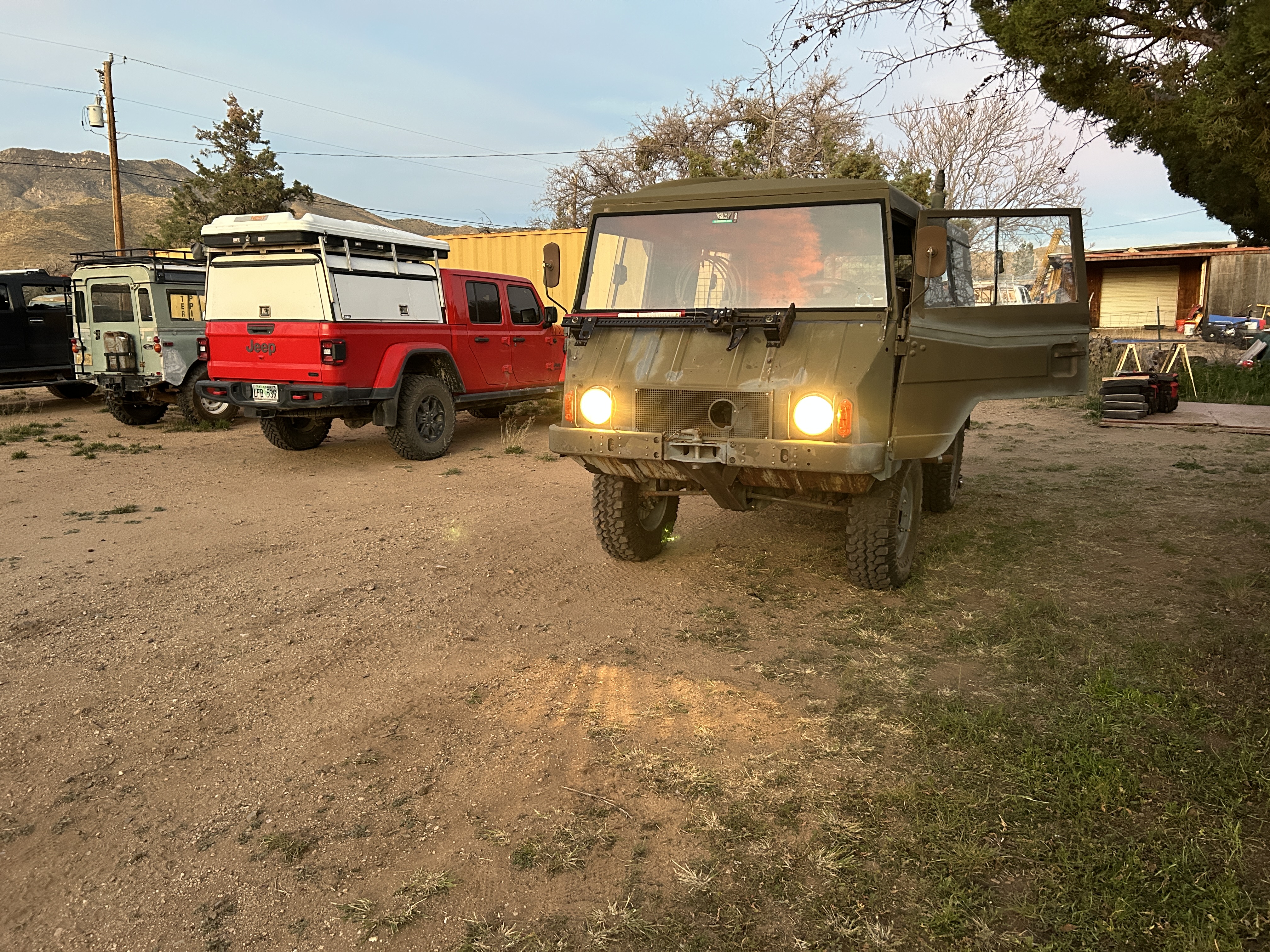

Re: The project 710K Begins.
Still lots to do while waiting for brake parts to arrive.
Today, I installed and wired the headlights and got started trying to sort out the taillights.
