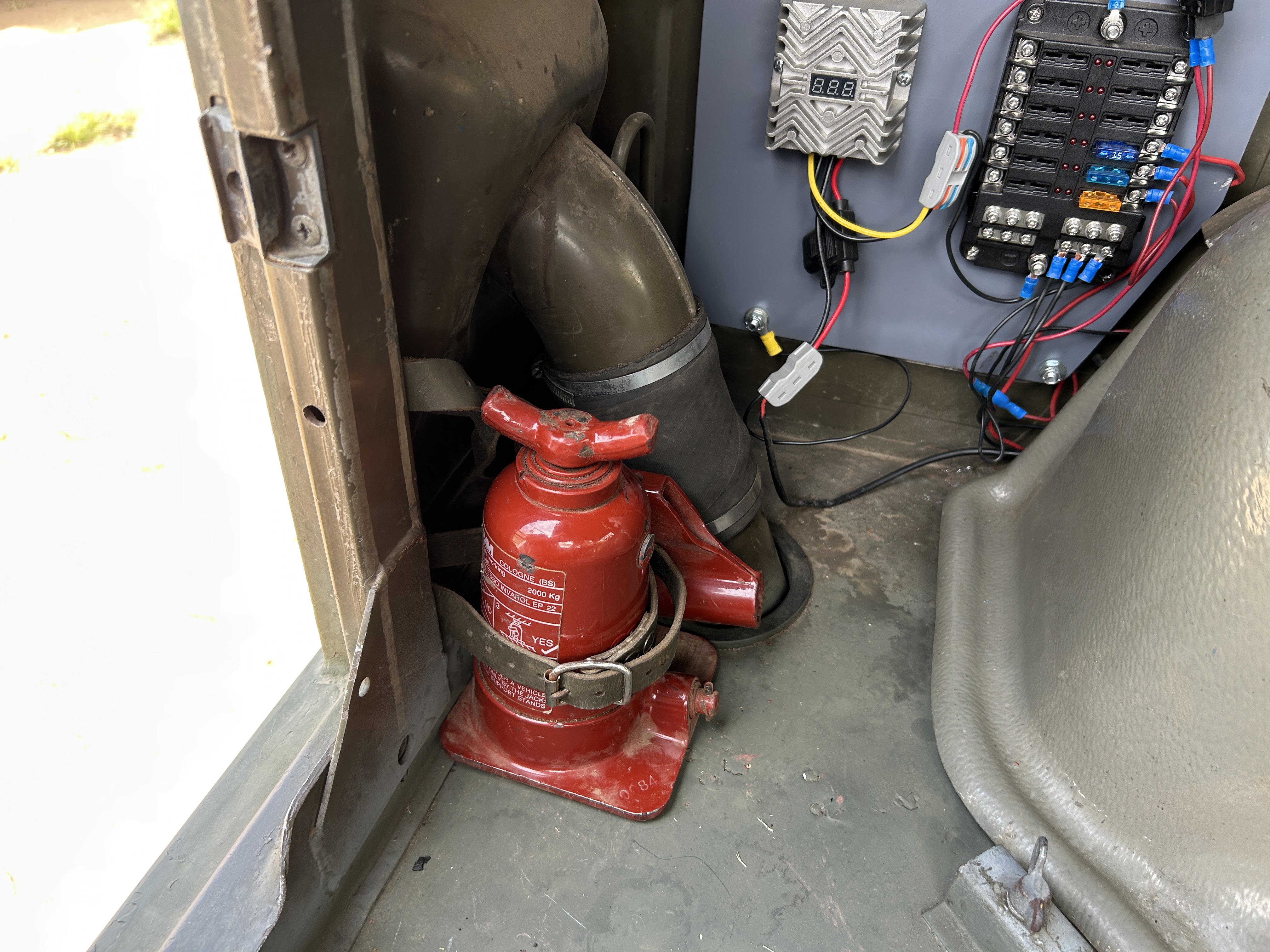

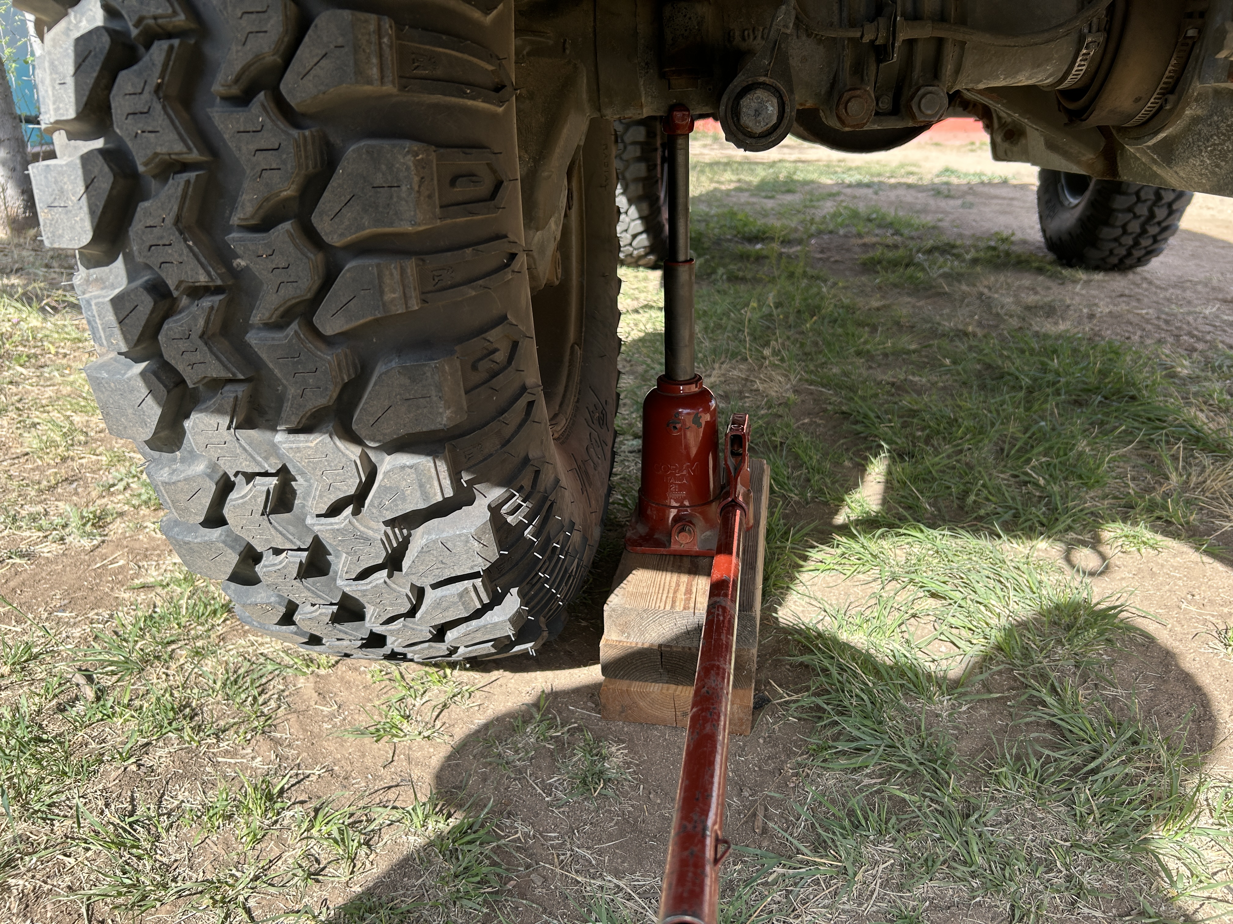

Looks like my 2 stage defender jack will do for now, with the help of some 2X6's.
Its a little short for the stock mount straps, but it will do until I decide to spend the cash for a better Jack.
Regards,
