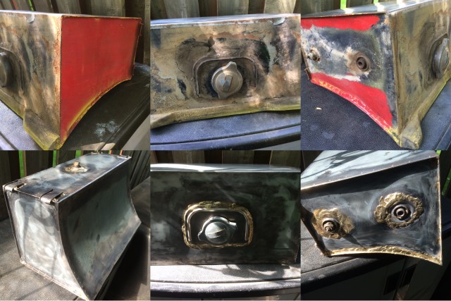

Thoughts - Original, Aftermarket or repair job?

Aftermarket!
The original tank would have bossing pressed in to the side panels. Yours are plain so can't be original.
Is the brazing on the bottom holding the drain plug in place nice and smooth? If not then definitely not factory.
John

Good quality replacement tank, it will last years.
