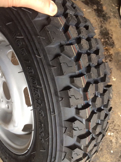

New tires mounted
165/80R13
Posted: Mon Jun 08, 2015 2:49 pm
by Jimm391730
Looks nice!
Posted: Mon Jun 08, 2015 4:26 pm
by Haf-e
Very nice - what is the brand of those?
Its hard to find aggressive tires in the small 12 & 13 inch size other than ATV type tires.
If you don't mind telling - what was the price for them?
Posted: Mon Jun 08, 2015 5:40 pm
Will have to look up info on brand and price
They are rally tires that I had to import from England - so price was steep for 13" tires :evil:

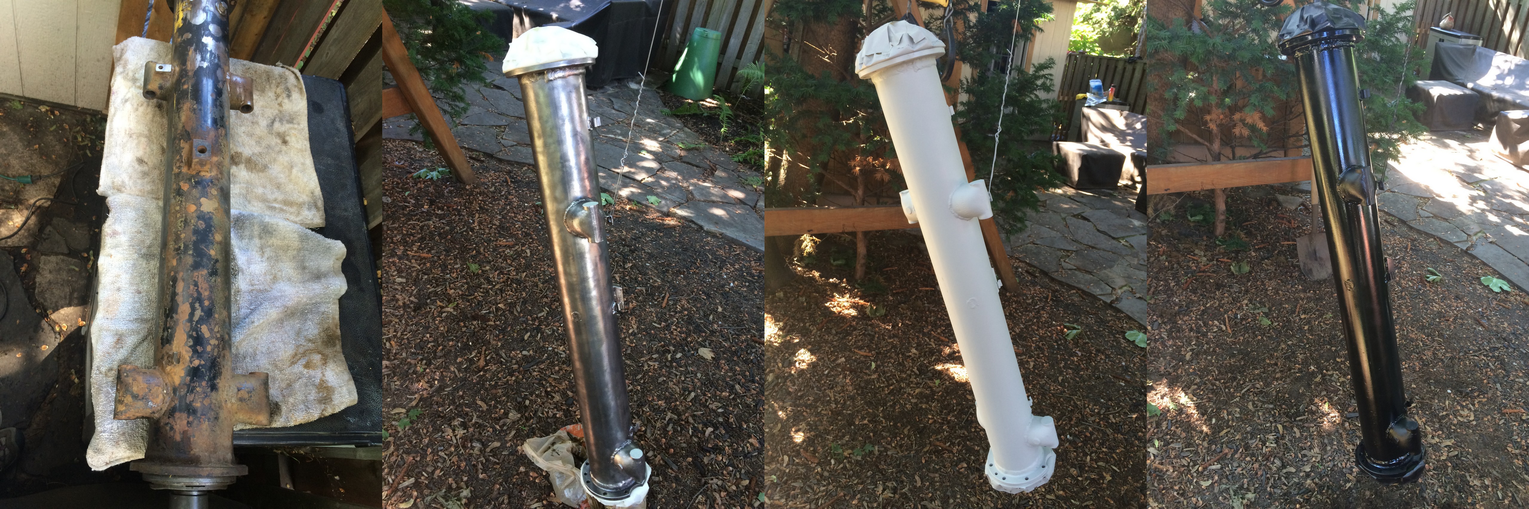

OK - so for the last 3-4 weeks I have had limited time to work on the Hafi.
This was to be the summer I got it all back together!!!
Between work, a new construction project, a puppy, bbq comps and then getting the flu the work on the Hafi has suffered.
Finally got a bit done yesterday with the hopes of getting more time at it over the next month. Weather was good and no wind so did not setup my temp paint area
Center tube - check :D

Posted: Mon Aug 24, 2015 11:56 pm
by Garrycol
I was considering putting in a sump/drain plug in my tube to make changing the oil in it easier - at the moment I have no idea how much is in there and what its quality is.
With yours as it is, now would be a good time to do it if you were so inclined.
Garry
Posted: Tue Aug 25, 2015 1:37 am
by Heinkeljb
Just need to make sure it's not proud along the bottom edge as it will get damaged when sliding over rocks etc.
Gary, jack the rear end up - all the oil will drain down to the front end where the filler plug is. use a vacuum oil sucking system to suck all the old oil out, then replace with new.
Like all other oil issues - what grade and how much will be your ever present questions as I don't recall seeing any mention of what goes in the main tube or if it differs between short wheel base and long wheel base or even if it differs due to year!
John
Posted: Tue Aug 25, 2015 2:56 am
by Garrycol
Heinkeljb wrote:Gary, jack the rear end up - all the oil will drain down to the front end where the filler plug is. use a vacuum oil sucking system to suck all the old oil out, then replace with new.
John
For sure you could do that but I dont have a sucker but we shouldnt have to suck it out - the other oil reservoirs have sump plugs and I really dont see why one was not put in there - another example of poor thought in the design of aspects of these vehicles
But we diverge from the thread topic.
garry
Posted: Tue Aug 25, 2015 10:41 am
by Jim LaGuardia
I would guess they did not want it tamperred with as it is sealed at both ends. There is no service interval listed, just instruction to check for oil and add as needed. This also prevents forgetting to fill it :roll:
Do yourself a favor and just make a oil sucker from a 1 qt mason jar. drill 2 holes in the top and solder or epoxy tubes in place(one reaches to bottom of jar, 1 just into lid a little). After that is done put the sucker hose on the long tube and hook the other to a vaccume source. Works like magic. Tube holds .5L of 90wt :D
