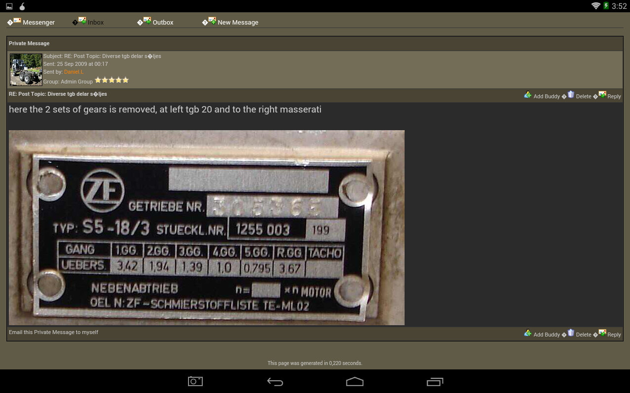

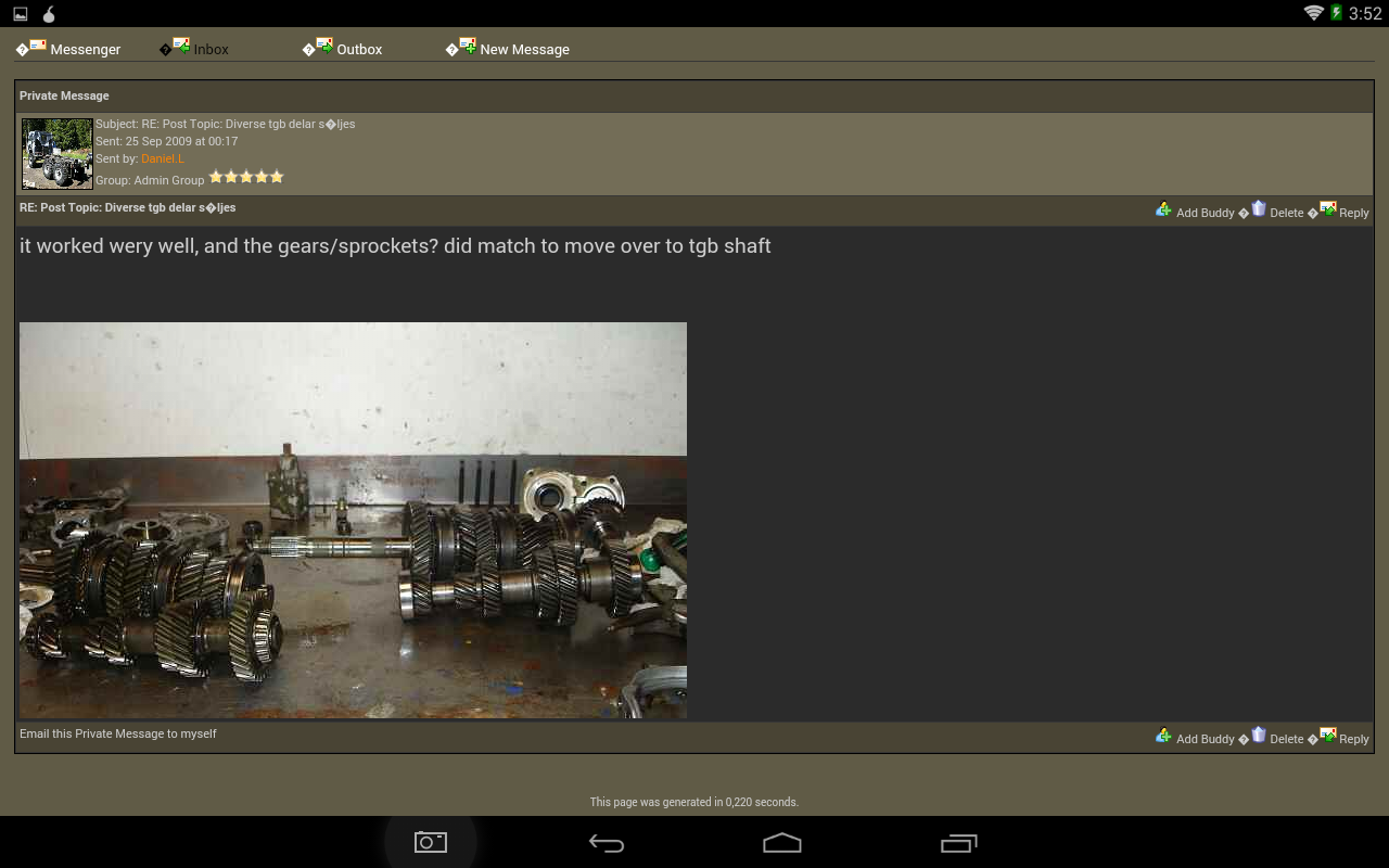

Some food for thought...the guy who did this with his Volvo used a mix of gears from the maserati bi turbo s5-18/3 variant and his 5 speed tgb20 gearbox and shafts and put it all together in the Volvo gearbox cases, he was however building a box to suit a diesel conversion. I think the shaft sizing in all the s-5/13 variants is the same...if so there is no reason this wouldn't work in a pinz box but I don't believe this would be a worthwhile exercise with the air cooled motor. As others have already stated it just doesn't have the torque at the lower RPM's achieved by an overdrive top gear...at best one would find themselves constantly hunting between 4th and 5th but probably find 4th being 1:1the most usable of the two. And I think the truck would be ruined for off road because of the changes and gaps in the first 3 gears.
For me it was just put some bigger tyres on and use it because it really does do what it was built for very well.
Scott nailed it when he said these trucks are very integrated in their design for what they were intended and that we should just use and enjoy them that way. We are all very lucky he finds the time to share the benefits of his experiences of these vehicles with us all...thanks Scott.
Not for me (why I bought a tgb 1315) but if one really wants the best of both worlds out of the aircooled pinz I believe you need to throw away its best attribute which is the very well designed, robust and simple air cooled motor (and its gearbox) and swap it for a compact diesel unit such as the 150hp merc om605td (with mech 602 IP pump) and 717.430 (or similar) 5 (or 6) speed, approximately 1300mm from fan to gearbox output. This is a whole different can of worms and off topic so I'm gonna leave it at that.
