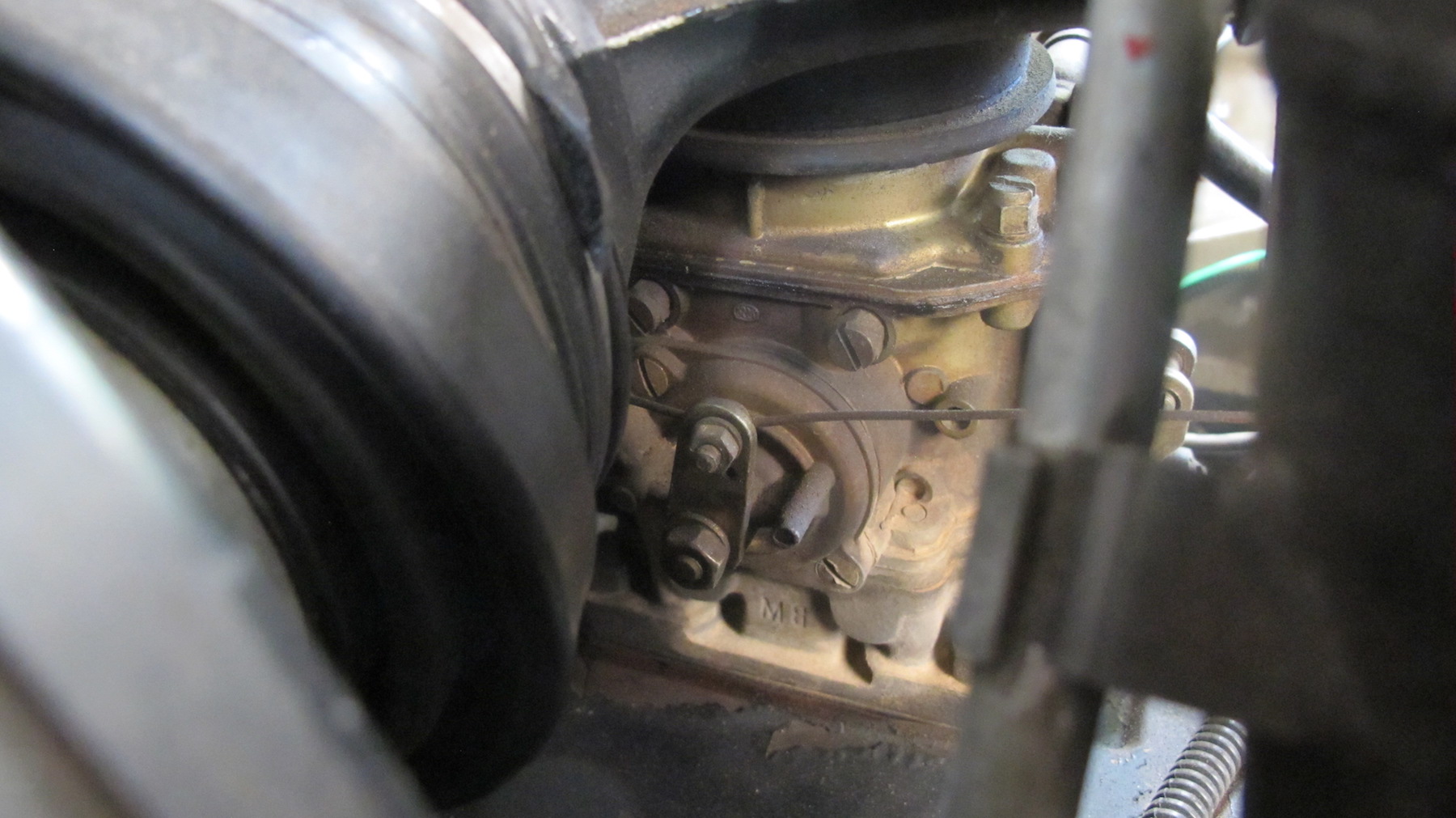

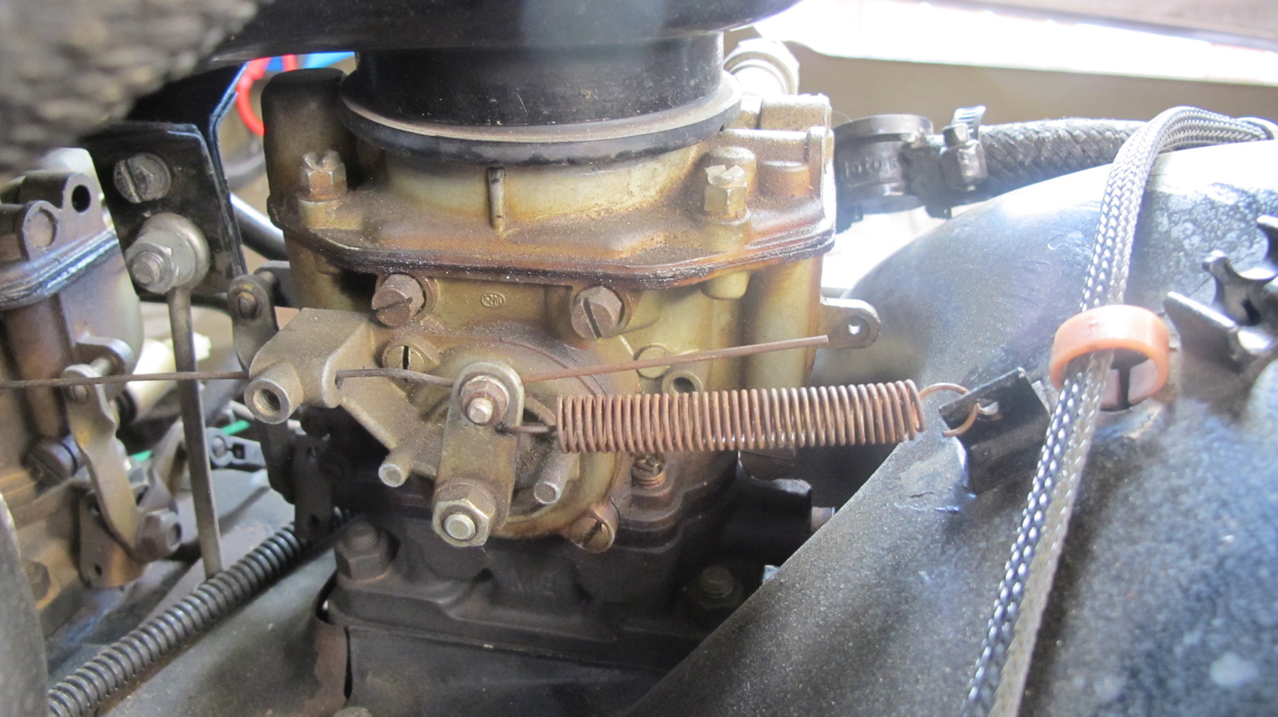

Changed to new oil a while ago, have only driven on one trip and day of four wheeling since, maybe 180 miles. Engine oil level is now again about 1 quart high and smells like gas. We're going to rebuild the carbs soon, but today I noticed the chokes aren't hitting the stops so it's running rich all the time. These are choke pictures today with the choke pull knob fully down, supposedly closed - a new cable assembly and return spring are on the way.
Fixing the choke to stop should solve a lot of issues I hope.

Re: Engine Oil Level Too High
Posted: Fri Mar 24, 2017 11:58 pm
by edzz
If you are getting gas contamination of the oil I would be looking at the fuel pump being bad. I would have a hard time believing that choke problems would cause gas to accumulate in the crank case.

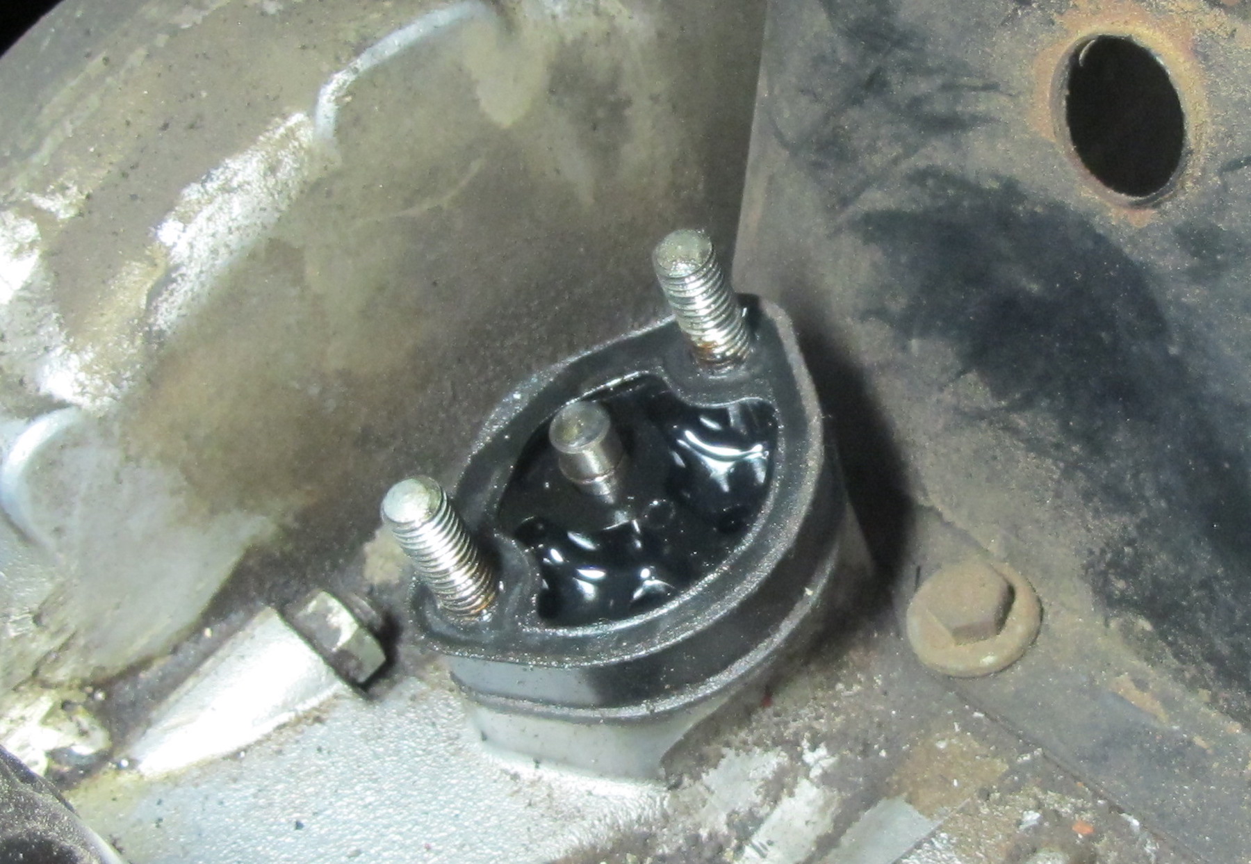

We're doing a carb rebuild and replacing the NAPA 60175 fuel pump with a SAV OEM pump. We did find that the rear carb was dripping fuel at idle even after we corrected the choke to fully close, and will be correcting that with the rebuild.
We think the culprit for the fuel getting into the oil is mainly the fuel pump leaking as you've suggested. When I removed the NAPA fuel pump the underneath side of the pump was coated with fuel, and puddles of fuel were sitting in the plastic fuel pump base below the pump.

So it's likely with the new fuel pump and the carb rebuild our fuel in the oil problem should be gone. Thanks for everyones input.
