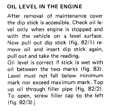

From the Operators Manual:
11-4-2016 10-02-02 AM.png (106.4 KiB) Viewed 10662 times
