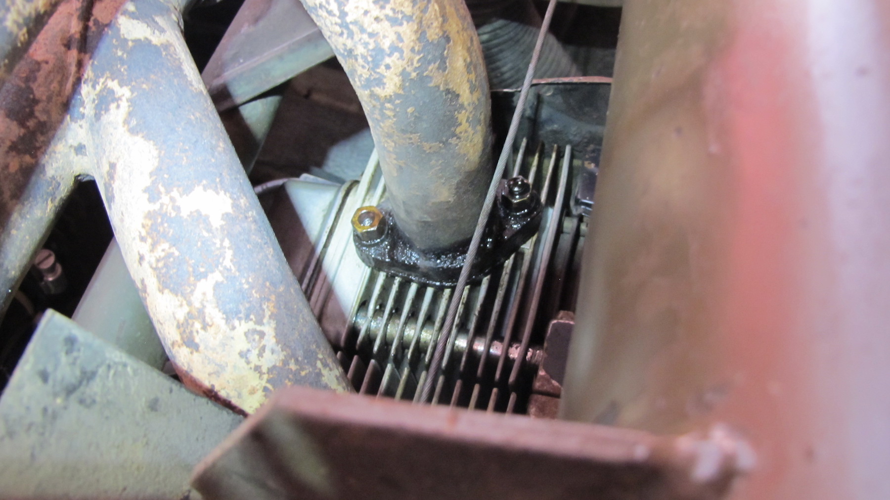

Update. I cleaned off the #4 exhaust flange studs and then ran the engine and watched. The main oil leak is coming from the exhaust flange stud on the right in the picture. I can hear and see puffs of an exhaust gas leak near the stud on the left side.
I'll see if I can tighten the stud nuts to stop it.
I have new exhaust gaskets. Any tricks or problems to deal with in replacing them.
Why would so much oil be getting into the combustion chamber?
The picture is with the engine running after having cleaned the oil from the studs before starting the Pinz.
IMG_1272 running copy.jpg (383.14 KiB) Viewed 7312 times

I would not recommend tightening the exhaust stud to stop a oil leak.
Oil should not be there in the first place. If it's coming from the combustion
chamber then it may be from a leaky intake valve guide, but you should see
blue smoke in the exhaust, and it would have to be pretty bad to also see it leaking.
Perhaps more likely from the exhaust valve guide, that would leak directly into the
exhaust port. This may be due to a plugged return oil pipe, you may want to remove
the valve cover and make sure the Oil return tube is not blocked causing excessive
amounts of oil at the top of the head -- potentially leaking more past the valve guides
than normal.
The other thing I can think of is a leak in one of the top push-rod tubes at the
head/cylinder or bottom return oil tube. But I don't see any indication of that in your
PIX as oil would be running down a bit closer to the block, further away from that
exhaust stud -- but then again oil is sneaky. Sii if there is any indication of oil on the
fins of cylinder #4.
Might try pulling the plugs on #3 and #4 and looking at what the plugs look like and
do a compression test while your at it.

Re: Engine Oil Leak on bottom of cylinder head nearest drive
Posted: Thu Dec 15, 2016 9:52 pm
by bbolander
I noticed when I've been doing all the looking at the leak, that I have the rubber valve cover gaskets! I believe I see a little seep at the bottom on #4 where it looks like there is a little chunk out of it. The other three look perfectly dry. I'll be replacing them with the cork and Permatex Aviation sealant on the cover when I remove any. I'm sure my previous Owner didn't put them in and he had it for 4 years and only drove 100 miles.
