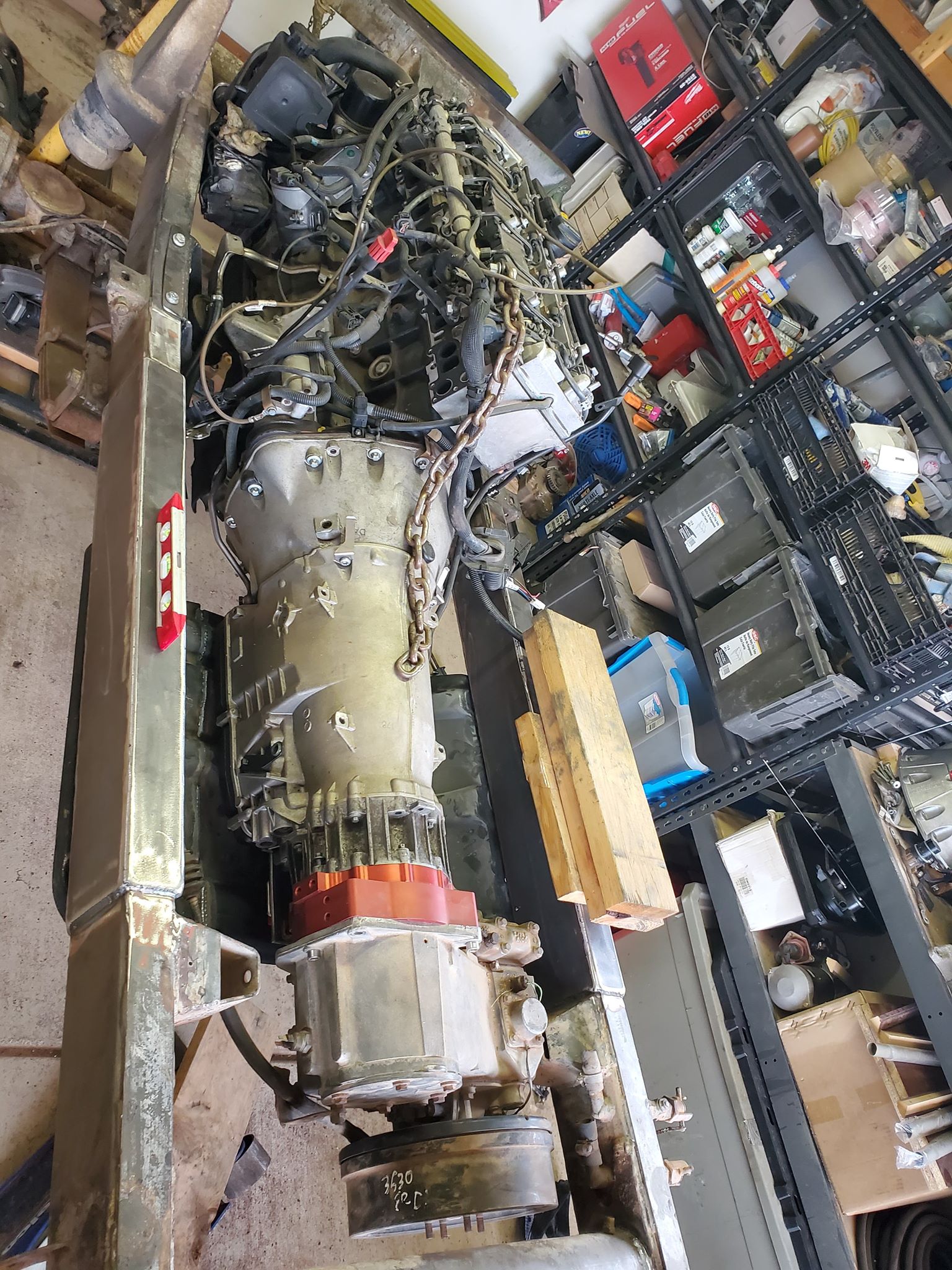

Got the frame stretched and the engine mounted! Working on steering currently I will do another big update in a few weeks!

So far I have mounted the engine and transmission and I have completed the steering setup (still need to make the power steering lines) I will go into more detail with each picture I post. It will be in a few separate posts.
The frame is stronger than original as it is now 3 layers deep of steel. There is in an inner box that sleeves inside the original frame about 12" on each side. Then there is the plating around the outside that you can see. (this is not the way I would have stretched the frame I paid to have this done, however I am not worried about the work in the slightest.

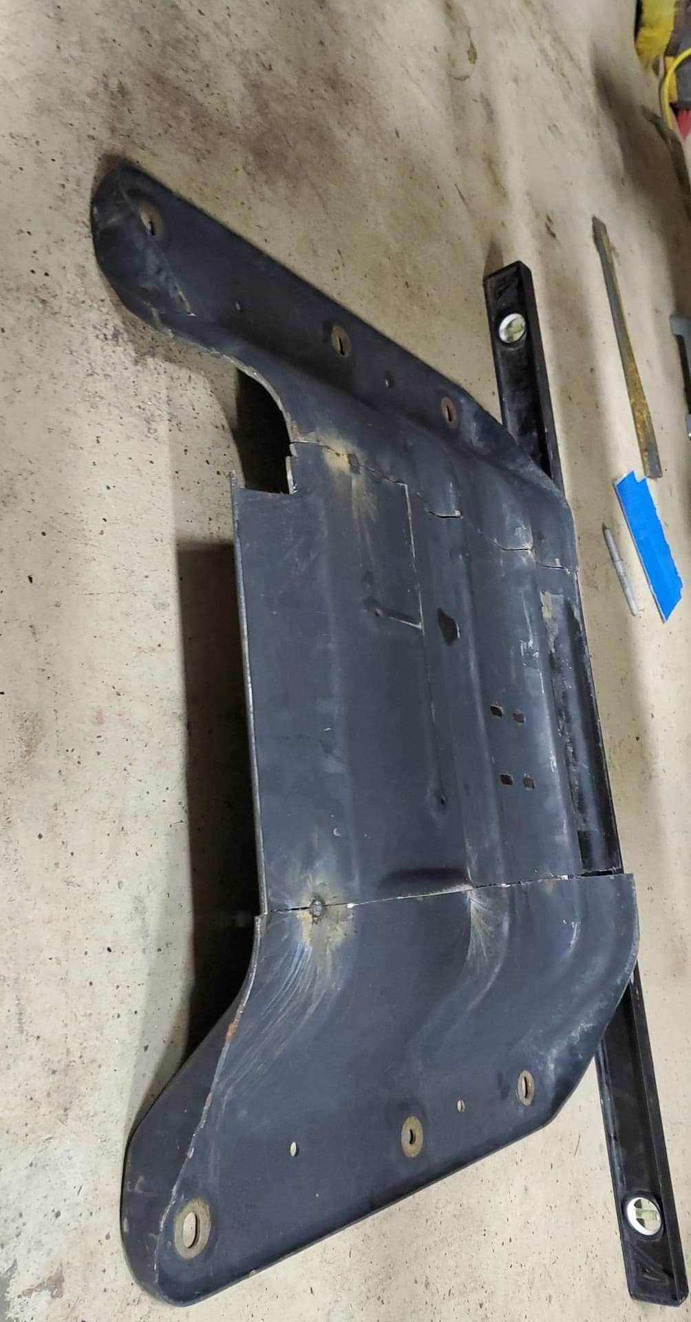

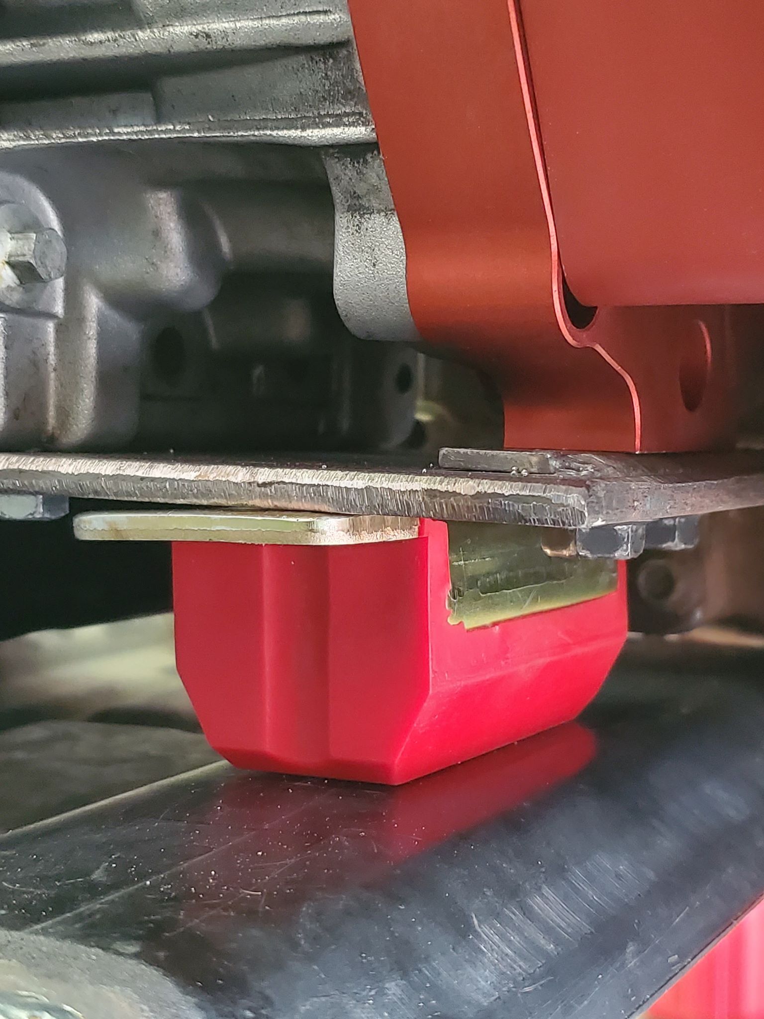

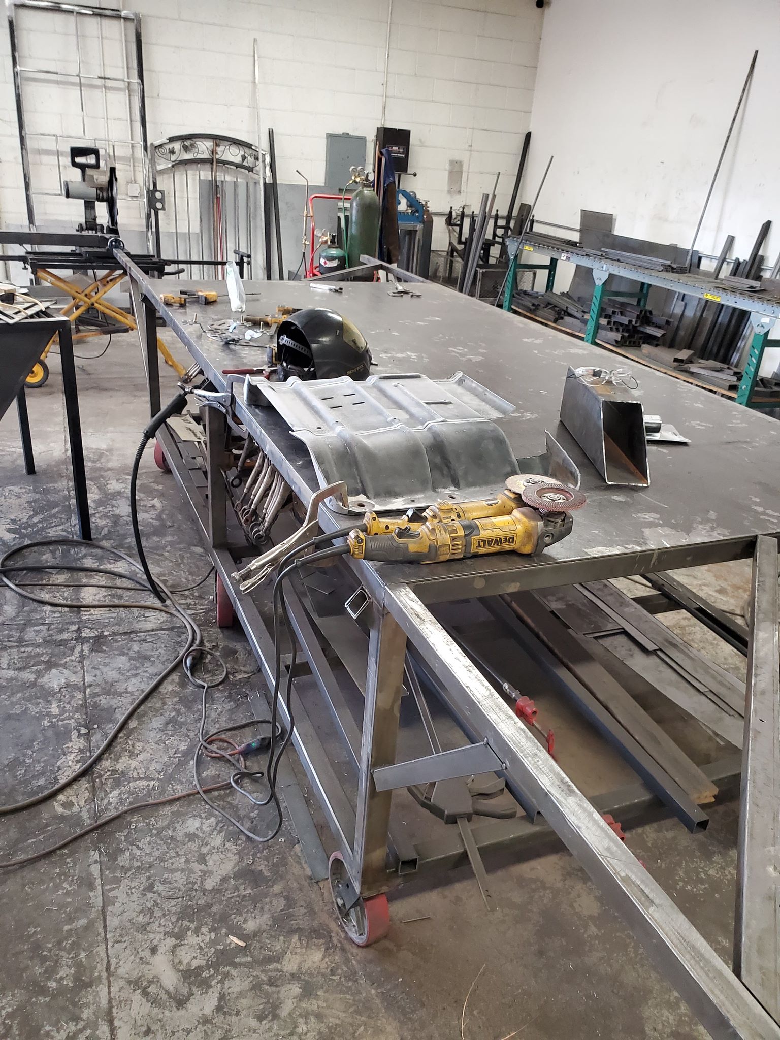

I modified this jeep skid plate to fit the TGB frame rails and it was the basis for my transmission/transfercase mount.
I did end up making the upper mount for the transfer case flat with the skid plate to avoid any premature wear in the rubber mount. There is a 3 deg slope in the drivetrain to make it line up with the pinion angles. So in the last 2 pictures the skid plate is flat and the drivetrain is 3deg downward.
