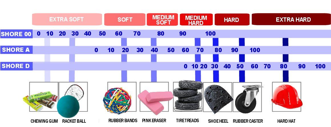

My OEM gasket feels rubber-band soft, so maybe Shore 20A.
