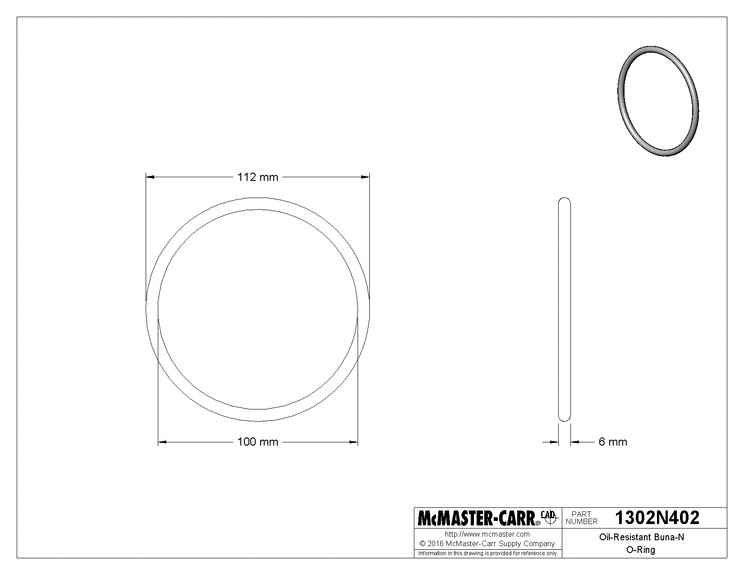

I thought about going the O-ring route, but both the lens and the back of the tail lamp box have thin sharp ridges that are meant to dig into the flat gasket-- to be sure it seals, I suppose. Used gaskets have an obvious line where the ridge was (see attached)... so I think staying with a flat gasket would be best. I'd go O-ring if I can't find anything else, tho...

I don't think an o-ring is going to work well for the reasons already stated. I think it needs to be a flat squishy (low durometer) gasket.

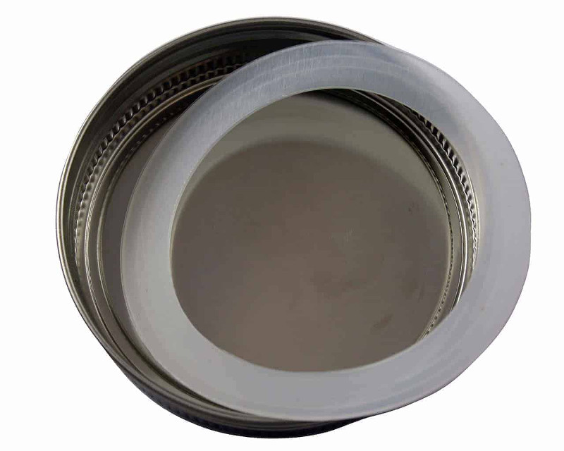

Silicone seems like a good material choice, so I asked the Mason Jar people where they had their gaskets made, and it's China (color me surprised). The contact they gave me said they mold gaskets, so a custom mold would be needed and the minimum order is 2000 pieces.
For smaller orders there are many custom gasket houses that die cut, water-jet cut, etc. I asked SAV if they would be interested in joining a group purchase (maybe a hundred or two?) to keep unit cost down. Will report back.

SAV says they sell/sold so few of the OEM gaskets that they are not interested.
Will look around once more for an off-the-shelf solution before pursuing custom....
