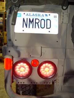

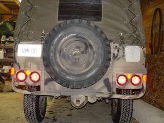

WELL HERE ARE MY NEW LED TAIL LIGHTS
Post by AK NIMROD »
Image[/img]
RUNNING LIGHTS ON
FLASH WASHES THEM OUT SOME :cry: :x

Looks great, I see I used the same housing that you did.
My LEDs are almost too bright. But better seen than not seen.

truck lite housing ....local shop had them and took original lights out and then i used my ASL LED lights, clear until on then red......not what i ordered but a pain and alot of time to return them. still working on aux. heater. getting pretty close to finished

we installed boxes upside down ( so they would be flush and less visable holes)and plugged drain holes and added paint as the only mods ASL LIGHTS fit without problem . have both doing all three functions
