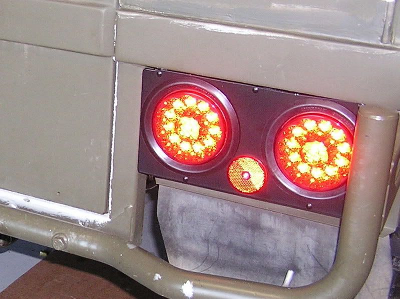

Truck-Lite LED modules on my 710K:
Jay
W3PNZ

Truck-Lite parts are available through any NAPA dealer. You want
one (1) Part #45421 Right Side assembly and one (1) part #45422
Left Side assembly. By the way, they ain't cheap...
These are Euopean approved lights running on 10 to 30 volts. They are
not DOT approved, though.
The red lamp on the right side (in the photo) is a fog lamp, but I have it
wired together with the brake light so you will REALLY know when I am
braking. I also separated the brake and turn signal functions
Jay
