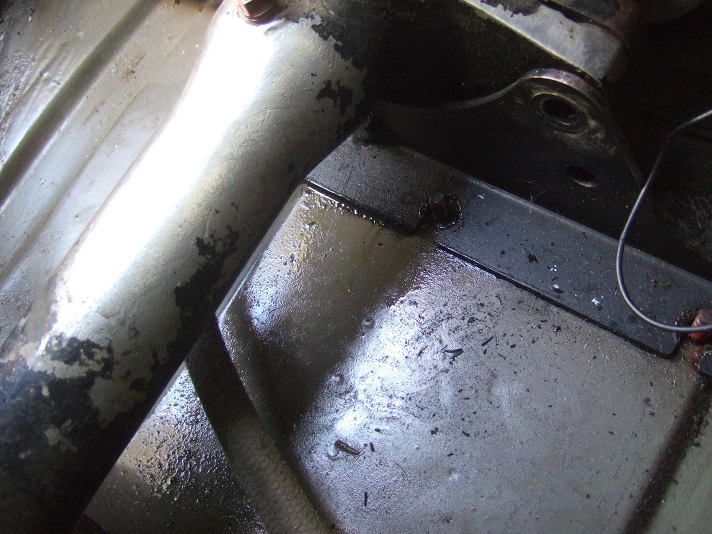

Hi Gents,
I cleaned up the area really well and filled up with gear-oil (90W is all I had) the top-part of the steering-column, where the worm-wheel is. Strangely enough I have not seen anymore oil leaking. Possibly when I hit the speed-bump, it 'threw' out some oil where the horn-wire goes in ???
Anyway for the moment I see no more leaks...

Gents,
It turned out that there was no more oil leaking, because the small reservoir was basically empty... I filled it up and thought all was OK, until 2 months later I detected a 1/2 coffee-cup of oil in the area below the Alu-foot-plate.
I would really like to avoid taking off the whole steering column and the connection to the actual steering-rod. If possible only the steering wheel column... I see 4 screws or so, some very hard to get at (bottom), but would that be enough ? I mean install a new O-ring (nr 20) or even the bushing (nr3) and screw it all back? Did anybody have this problem before and what did they do ?

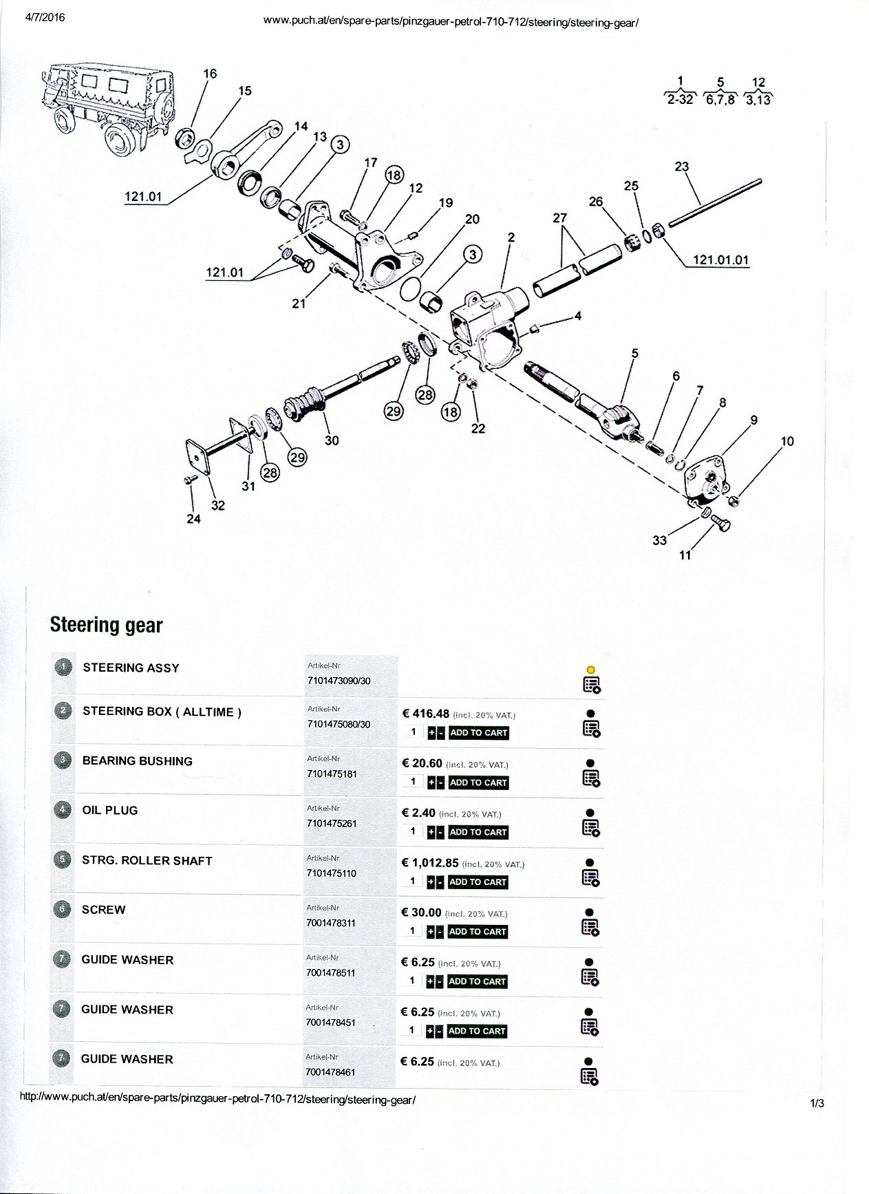

PS The exploded-view-picture is a scan from a print of the www.puch.at site, where you can order parts, but also have pretty pictures of assemblies...

I've replaced that o-ring before and you do have to remove the entire steering assembly to get at it. The aluminum casting (#12) has to be slid off the short steering shaft (#5) and it's also a good time to replace the seal (#14) at the other end of the casting. As long as the large steering arm nut (#16) comes off okay the rest of the process is fairly easy.

If the upper section is draining empty, I'd suspect the joint between #31 (the end cap with the horn wire tube), #32 (all the thin shims) and the main casing (#2). When I rebuilt my column I carefully cleaned all the shims and put just the thinnest film of aviation sealant between them to prevent leaking. Your leak might also be at the #9 to #2 joint, or the #20 o-ring. Realistically you need to remove the steering box to work on any of this (PITA, but there are worse things to get at). If you can get the steering wheel off and the pitman arm off then it is just six easy bolts. You might try cleaning EVERYTHING really well first and try to find the source so you know what to work on when you get it out.
