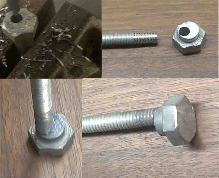

OK I just had to give it a try.
Didn’t photograph welding it together.
Took longer to take pictures and edit them than to make the cam bolt.
The bolts are not the correct size and the thread portion should have a smooth section on the shank, however for a proof of concept… if I’d had the correct size bolts all I’d have left to do is slot the head.
I may have to make a trip to the bolt store and make a real one. 8)
Or you can go the Rube Goldberg approach. :roll:

Yes, that's it exactly. Nice work.
