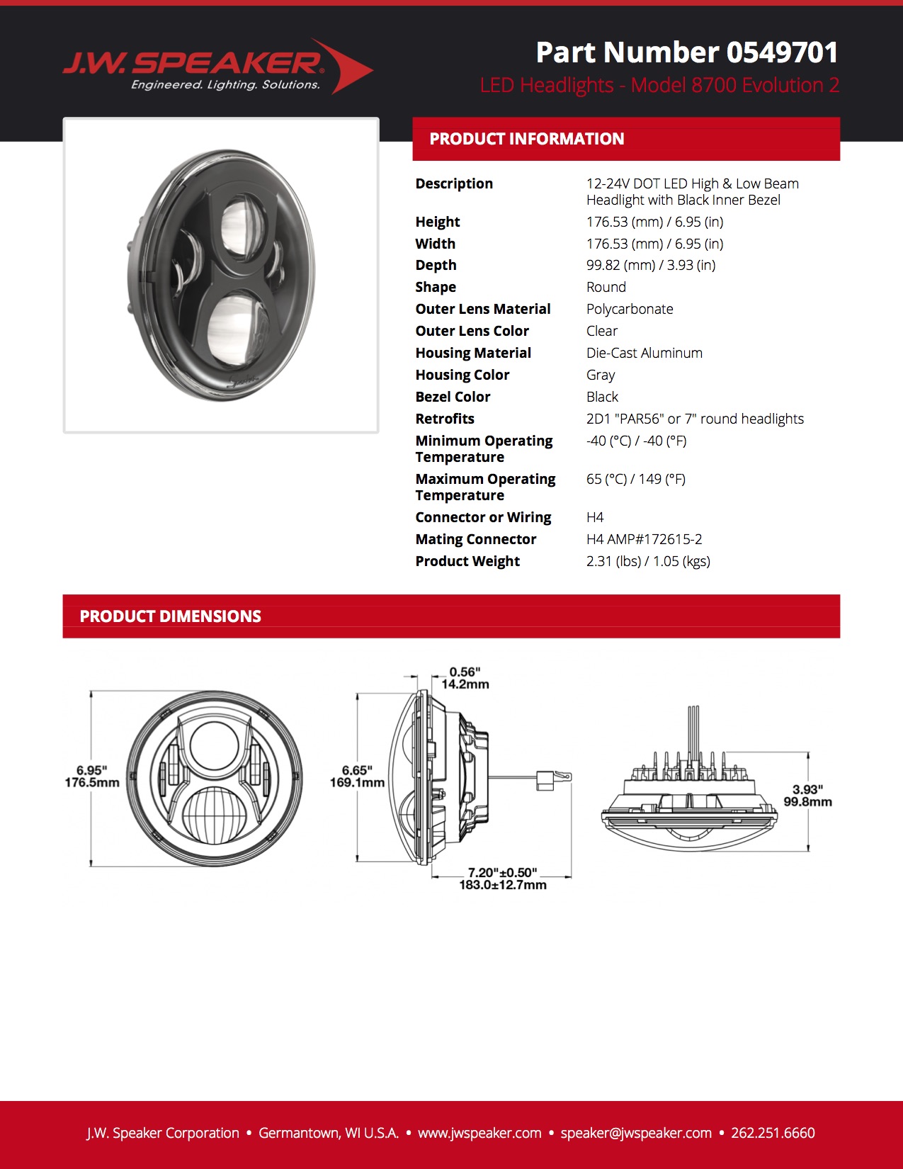

Re: LED Headlights
You may have already seen this:
Model 8700 Evolution 2 .jpg (299.38 KiB) Viewed 4454 times
It may not provide quite enough information.
Posts: 1558
Re: LED Headlights
Yes, I found that as well. The detail that is missing is the potential interference at the edge of the top part of the
heat sink at the plane of the connector. The EVO 2 "relieved" that edge back (smaller radius) from the 1'st gen,
don't know if that's enough. Y'd think there wouldn't be a problem if the back end was 100% physically compliant
with PAR56. At $250 a pop, I'm hesitating :? I really like the Black ones though.
Posts: 1558
Re: LED Headlights
No response from JW Speaker on the question of the 8700 Evo 2's physical compliance to PAR56 :(
As a last resort, I took the drawings of a Truck Lite 27270C and a JW, then sized and overlayed the images.
Assuming these drawings represent the true shape of their product, the JW does appear to have the
potential for more interference in the bucket than a Truck Lite. Guess it's the Truck Lite's for me.
