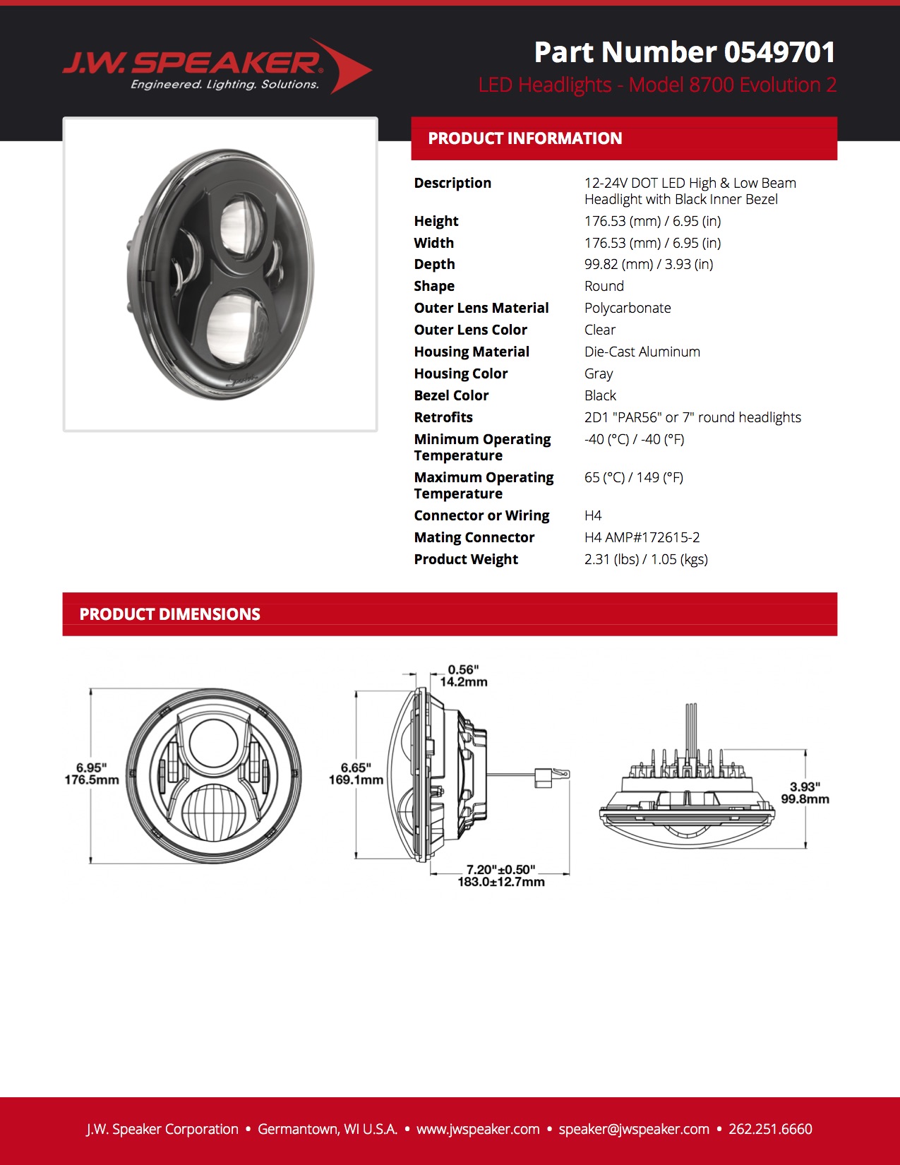

Has anyone had any luck installing the new JW Speaker Evo 2's in the standard Pinz headlight bucket?
The Evo 2's have tapered the back heat sink area to accommodate more buckets with this version -- so I'm
hoping someone has already tried :wink:
Yes! They are significantly more expensive than Truck Lite 27270C's but JW's get better overall performance.
Hate Winter! When I can't drive off-road then I can't seem to stop the damn improvement projects :P
ron

Yup! Saw that one. These have to be EVO 1 generation with a date code of 2009.
These definitely have a larger heat sink than the EVO 2's and know to interfere on some buckets.
Hoping someone sprung for the EVO 2's and tell us if they work or not. Failing that I'll give JWS a
call and see if they can send me a detailed mechanical drawing. I knind'a like the idea of a lens
based optical system than mirrors with some holes and artifacts. Ya, I know the Truck Lites are
darn good.

You may have already seen this:
Model 8700 Evolution 2 .jpg (299.38 KiB) Viewed 4456 times
It may not provide quite enough information.

Yes, I found that as well. The detail that is missing is the potential interference at the edge of the top part of the
heat sink at the plane of the connector. The EVO 2 "relieved" that edge back (smaller radius) from the 1'st gen,
don't know if that's enough. Y'd think there wouldn't be a problem if the back end was 100% physically compliant
with PAR56. At $250 a pop, I'm hesitating :? I really like the Black ones though.

No response from JW Speaker on the question of the 8700 Evo 2's physical compliance to PAR56 :(
As a last resort, I took the drawings of a Truck Lite 27270C and a JW, then sized and overlayed the images.
Assuming these drawings represent the true shape of their product, the JW does appear to have the
potential for more interference in the bucket than a Truck Lite. Guess it's the Truck Lite's for me.
