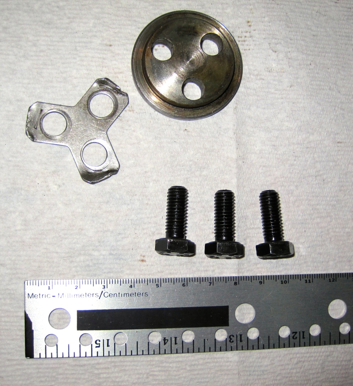

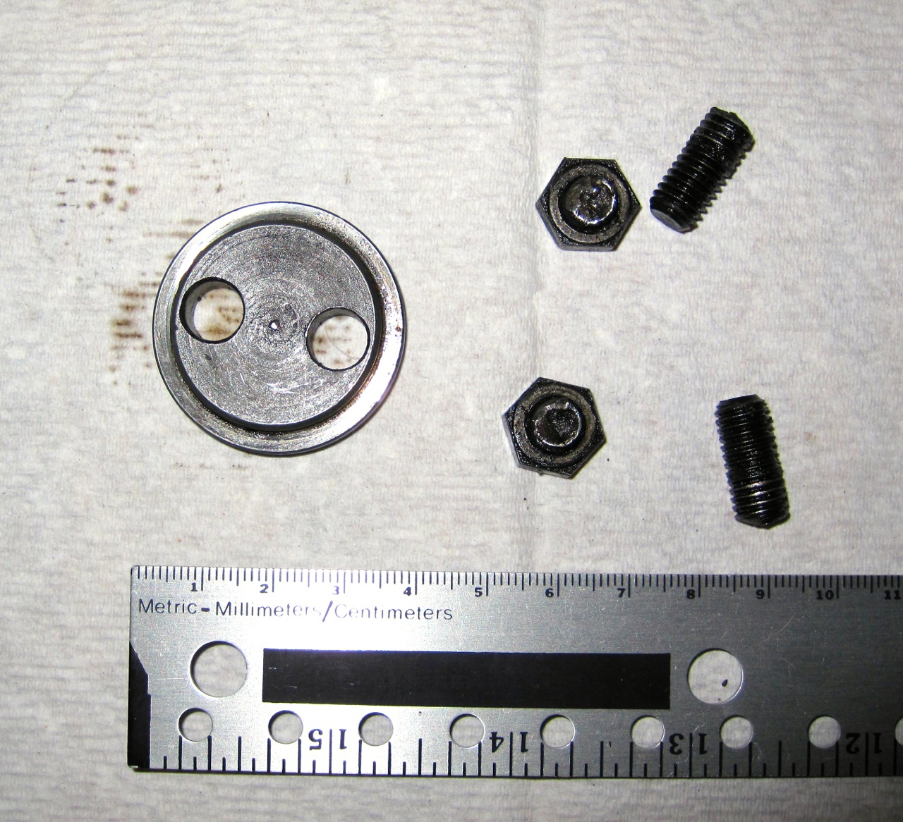

I found the old parts that he removed and took a couple of photos:
The locking plate for the upper (2 hole) fitting had broken and pieces were found in the gear oil and on the drain plug magnet. The lower locking plate was intact. There was no sign of Locktite residue on any of the old bolts so apparently none was used.
If either of the locking plates has broken it might be a good idea to consider if the bearings or seals were damaged by the metal bits. Paul U. and I decided to replace the bearings and seals for as a precaution.

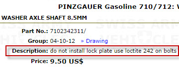

SAV site also says this when you go to part #11
She gave me the same document and same parts #'s and qty
Cheers and thanks to all - now I got it!

I stand corrected -- looks like Steyr has changed the hub assembly. I've only had to repair one leaky hub on my trucks and it had the three bolt system pictured; at that time (several years ago) I heard no mention of any change to the assembly.
I find it interesting that they now want to secure the bearing and the gear to the shaft with loctite, seems like they just floated before.
