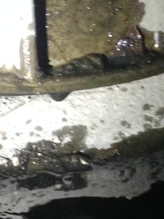

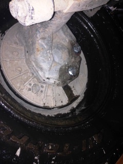

So I was all fired up... I changed out all of the oils on the truck including transmission, wheel drives, front and rear diffs and reduction gear box. Took her for a spin and everything seemed much smoother than when I bought her a few years back. I finally got a chance to take her out in the woods yesterday. I didn't do anything crazy; but we went through some mud and water and I had a chance to engage the front and rear diff lockers and give them a bit of exercise that they don't seemed to get enough of. I hit a few bumps, but nothing out of the ordinary. The trip from the house to my lease is about an hour. Ride up and back was fine. When I stopped in the driveway to open the garage, I noted oil that seemed to be pouring out of the drivers side rear wheel. I got her in the garage and took some picks. The leak does not appear to be coming from either of the oil plugs. In the photos they may look a bit wet; but they are merely clean from my working around them last week. Note the oil that seems to be dripping from the housing. The entire inside of the wheel was full of oil. Another interesting note is that the boots seemed clean and dry. I did not open up either of the plugs to see if they are the one's that leaked; I just assumed it was a wheel drive leak given the location. What is wrong and what do I need to do to fix it? I looked at the drawings and I figured there was some gasket for the housing that must have leaked. But I don't see such an animal. Any thoughts on the cause of my trouble??? Thanks a ton for the help.

The oil appeared to be coming from between the brake backing plate and the housing wheel drive. It wasn't just a drip; the oil seemed to be running out and you can see it was slung up on the inside of the wheel itself. I guess I am wrong and there isn't a gasket between the backing plate and the wheel housing. But, I'm confused as to what seals or rings could have gone out that resulted in the massive failure. Any thoughts would be greatly appreciated.
When I get time I'll jack it up and remove the wheel to see if I have the problem noted about the broken backing plate. But, with the wheel on there is no sign of oil dripping on the front of the wheel or the tire; just between the backing plate and the wheel drive housing.

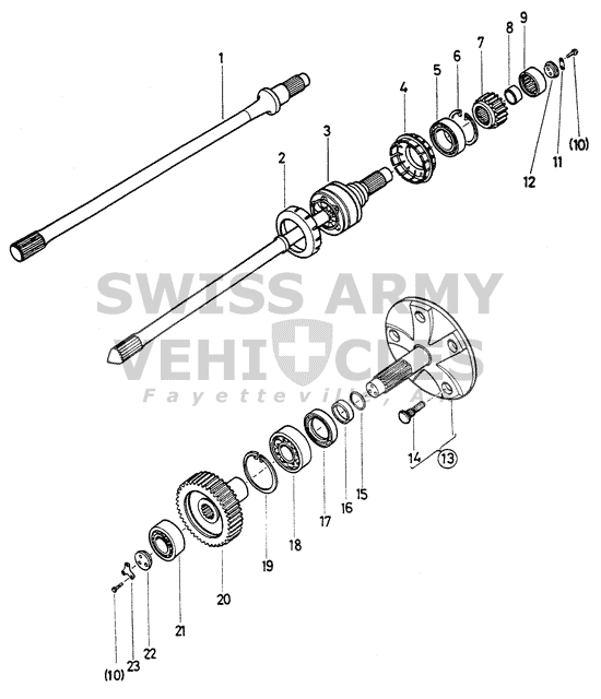

I had something similar occur on the right rear wheel of my '72. Here's a diagram:

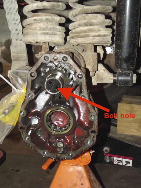

Item #11 (bolt retainer) failed and allowed item #10 (2 bolts) to propel themselves thru the brake backing plate. Gear oil flowed heavily thru the break and into the brake area before exiting similar to yours. Here's a photo of where the bolts were: If you remove the brake drum you'll be able to see if this is what happened on yours. Hopefully you'll find it's just a blown seal. #04-10-17

Thanks Paul. I had seen some posts about this type of thing; but I really thought there was a gasket failure between the two housing units. I had no idea that the gear oil was kept in place by the seals you are referring to. I looked into it last night and upon further inspection, the oil was coming from the weep hole at the bottom of the brake back plate just under the drain plug. So, I am assuming a failed seal and/or the sheared bolt issue you discussed. I'll search again along this topic and make sure I order the right parts. I'd rather have more than I need so I can finish it when I start it. Thanks again for the help.

If the seal (#17) fails, the gear lube will flow out of that weep hole. In theory that is supposed to keep the gear oil from contaminating the brakes.
Paul U. "undysworld" did my repair for me because it was beyond my mechanical talents and required a gear puller I don't have. Hopefully you'll just need the seal and the o-ring (15).

The axle seals are offered in 2 sizes, 55mm or 60mm.
The 55mm spacers can be danged during removal(use a scraper and hammer at the base).
The 60mm spacers are easier to service but can be prone to pitting
So it is wiser to order 15,16, and 17 so the seal matches the spacer the first time
Use Permatex aviation sealant on the mating surfaces, do not use silicon sealer
