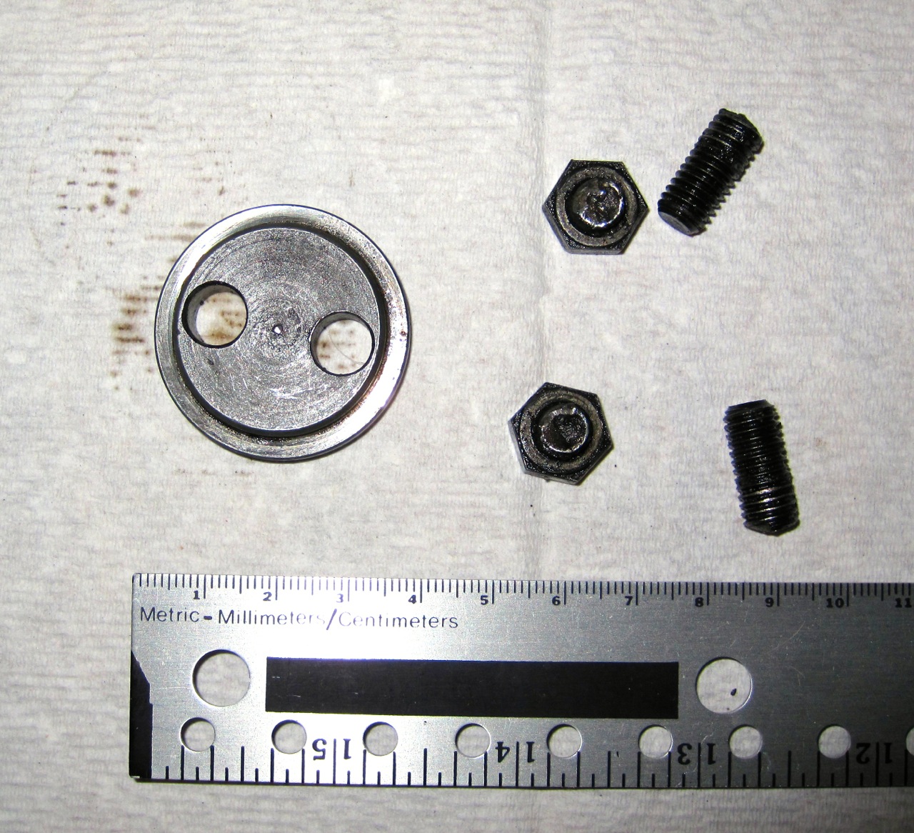

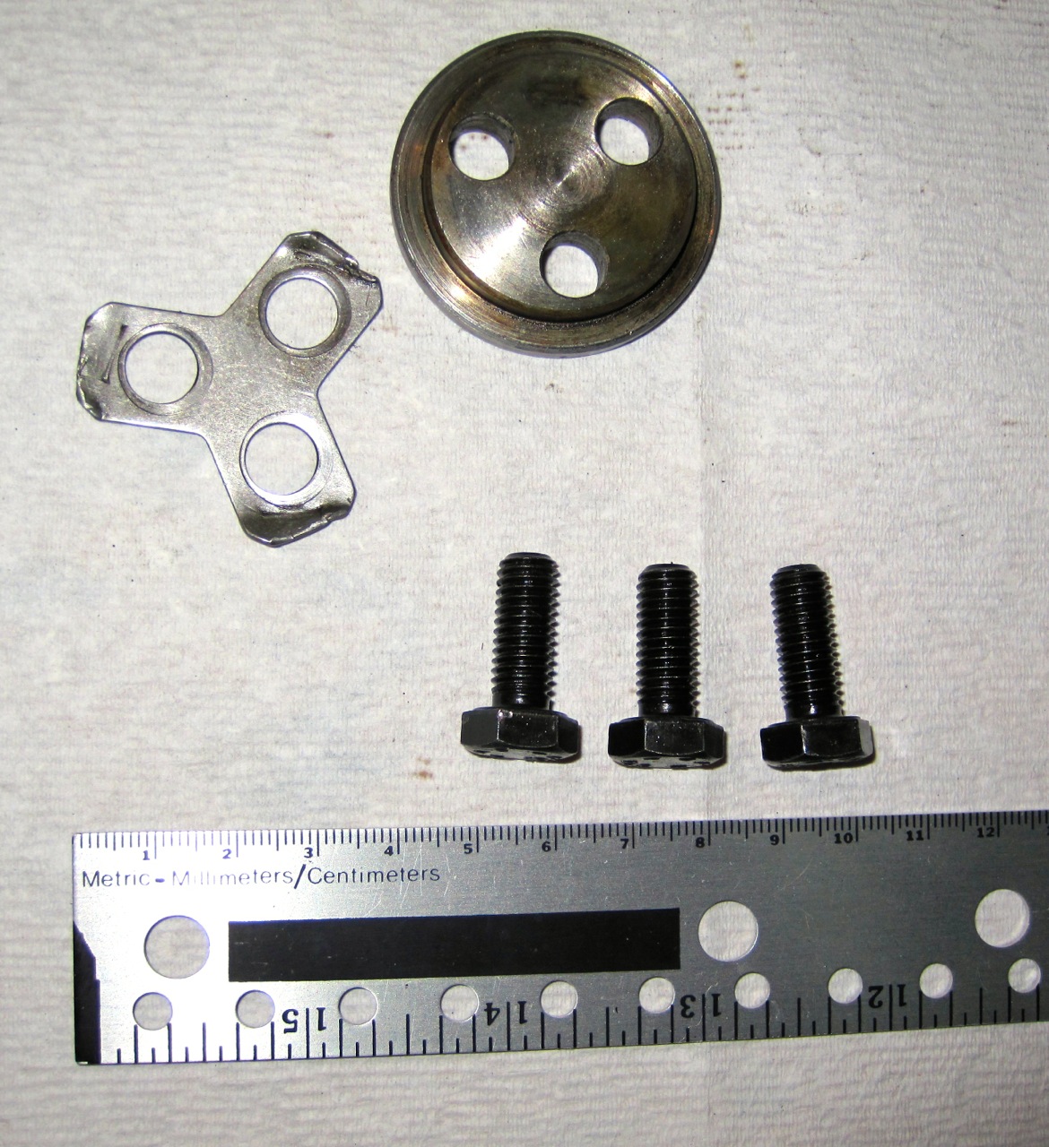

I found the old parts that he removed and took a couple of photos:
10-2-14 09-27 AM.jpg (477.17 KiB) Viewed 6737 times
10-2-14 09-26 AM.jpg (448.43 KiB) Viewed 6737 times
The locking plate for the upper (2 hole) fitting had broken and pieces were found in the gear oil and on the drain plug magnet. The lower locking plate was intact. There was no sign of Locktite residue on any of the old bolts so apparently none was used.
If either of the locking plates has broken it might be a good idea to consider if the bearings or seals were damaged by the metal bits. Paul U. and I decided to replace the bearings and seals for as a precaution.
