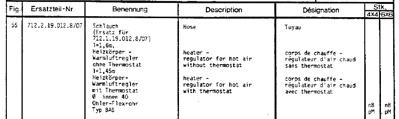

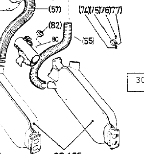

I'm trying to determine the right hose for 30-05-55 that comes off the low port on the front of the heat exchanger. Mine is worn through because it rubbed against the upper exhaust manifold.
Do I translate the parts page correctly that this is 1.6m of 40mm ID hose?
I want to get the quality stuff from Aircraft Spruce since I order from them on a regular basis, and the Pinz deserves the best. Seems like SCEET is the best choice, and since 40mm --> 1.57in that pushes me to the 1-3/4in size (#05-3067).
Does this all sound right? From comments upthread it sounds like the 1-1/2in can't be squeezed over the male fitting.
30-05 parts page.PNG (21.47 KiB) Viewed 4917 times
PDF page 327 from the parts catalogue
30-05-55 parts page.PNG (35.85 KiB) Viewed 4917 times
