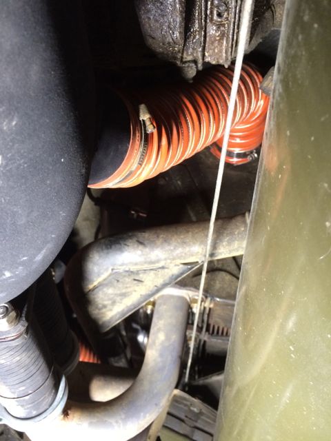

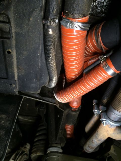

Aircraft spruce sceet flexhoses for heater seem to be great, just installed it on my 710. One tip, if the exact size is not available, go slightly bigger rather than smaller, the wire cable compresses easily with a hose clamp to fit if slightly large but doesn't expand easily to fit if slightly small (I thought it would, but it doesn't).
You mainly need 40mm, 50mm, 70mm ducting. This is what I recently ordered:
05-30606 HARTZELL SCEET-6 DUCTING 1 1/2" **(Note: 40mm = 1.575". --> The 1.5" ducting IS A BIT TOO TIGHT for the 1.575" receptacles, YOU should consider next size up for ducting).
05-30608 HARTZELL SCEET-8 DUCTING 2" (50mm=1.968" Hence 2" is slightly bigger, and works well where 70mm needed).
05-30611 HARTZELL SCEET-11 DUCTING 2 3/4" (70mm = 2.756". Hence 2 3/4" is a bit small but seems to fit ok regardless)
05-30612 HARTZELL SCEET-12 DUCTING 3" (75mm = 2.953". This 3" is slightly bigger than 75mm and fits great)
05-30614 HARTZELL SCEET-14 DUCTING 3 1/2" (90MM=3.54").

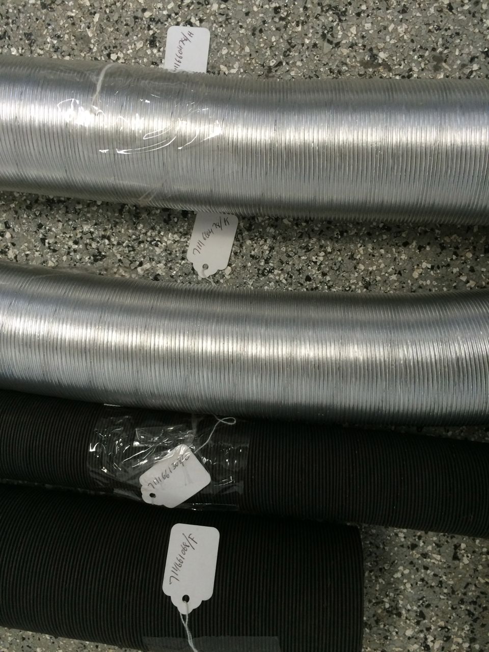

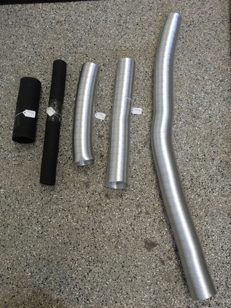

I actually bought the SAV ducting, but I wanted to get some aircraft spruce ducting anyway for my 79 VW Van, and since I like it better I ended up getting it for the Pinz too. I have some SAV ducting I will sell if your or anyone wants it. Pics attached.
Kevin.
Kevin.

It turns out I don't particularly care for the silver ducting because it will deform if pushed on, there is no inside wire to keep the circular profile (unlike the stock ducting). The black ducting is a bit better, but only due to the paper-like material rather than "tin foil" (still no inside circular wire frame). The aircraft spruce stuff has a fairly heavy gauge stainless wire wound the length to allow flex but maintain the shape, even around bends or under light loads. Of the different variations of this at aircraft spruce, I like the SCEET best because it is double-layer-thick (wire encapsulated between outer and inner layer). Hence inside is smooth. Downside is that it is kind of expensive for what we are doing here.
At the end of the day, not much sense in over thinking this, air just needs to get from A to B… but out of principle and habit I do things the best way that I think it can be done, hence the SCEET. Just can't help myself, even if it means buying stupid expensive ducting.
