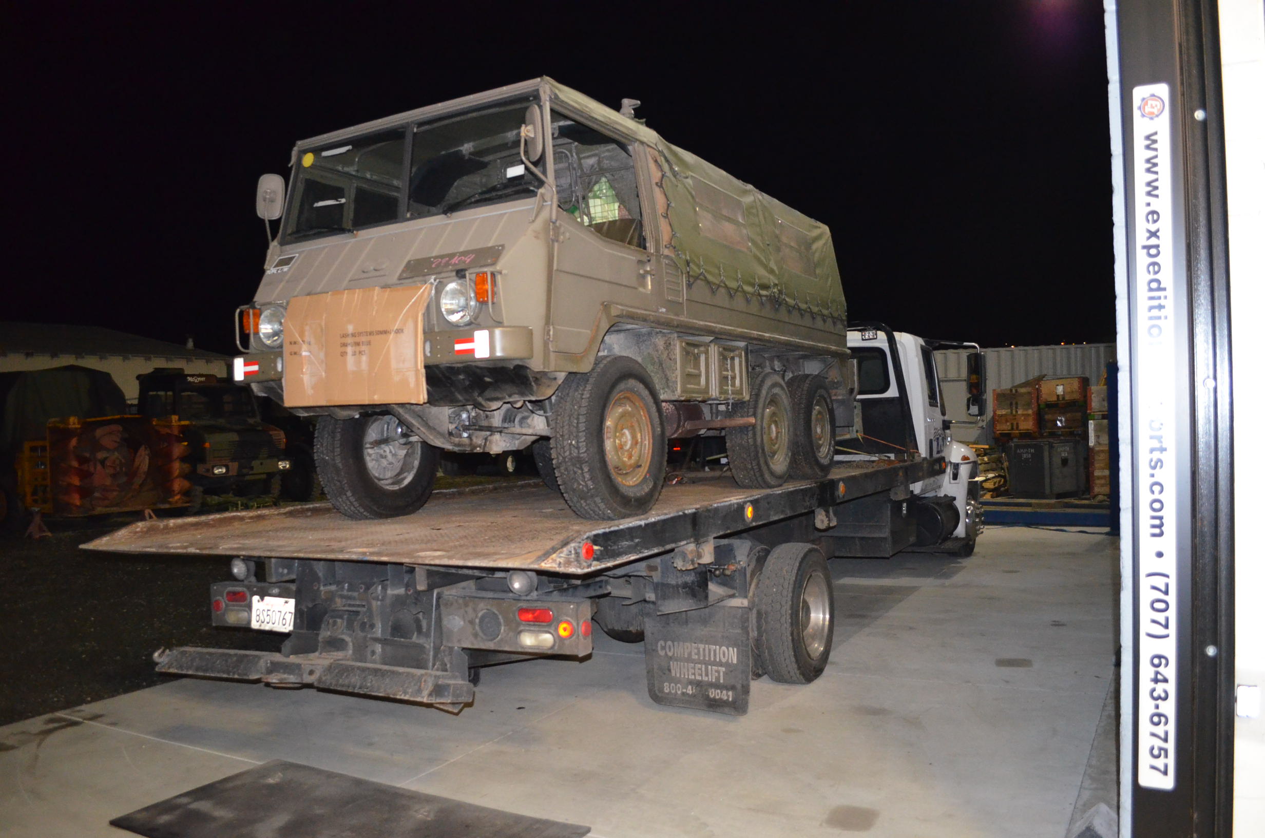

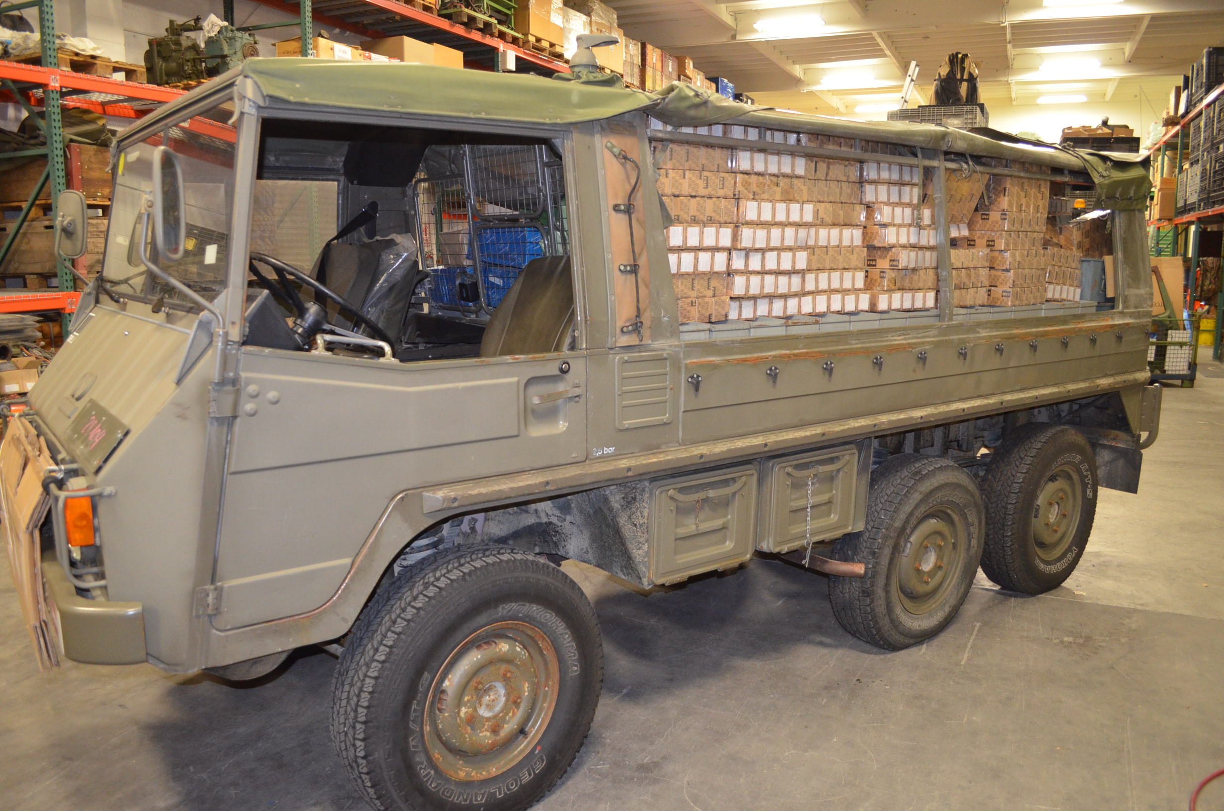

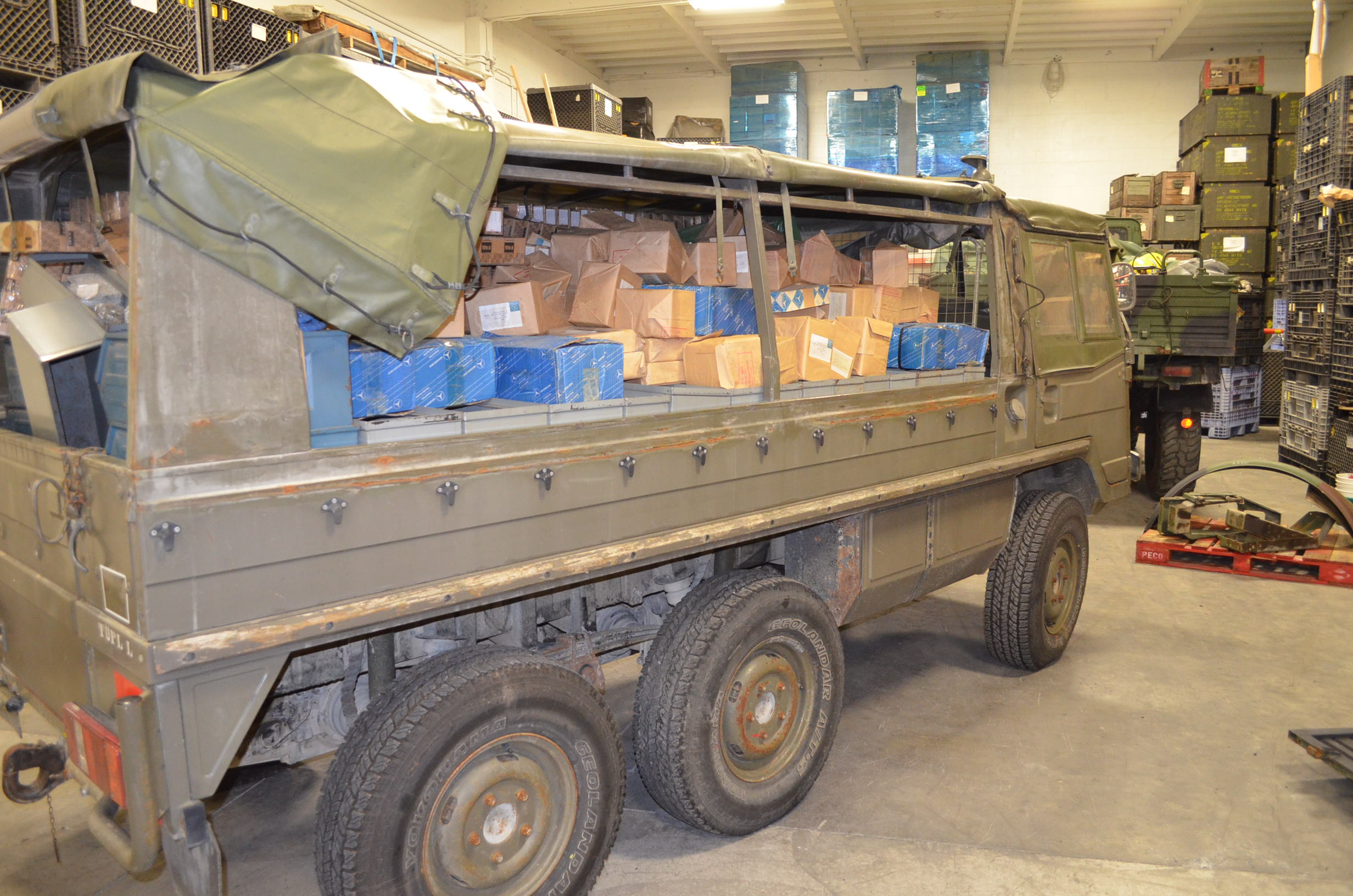

Just unloaded the 712M with power steering so if you are in the Bay Area and want to give it a try give us a call. Should have the parts unloaded by the end of the week.
