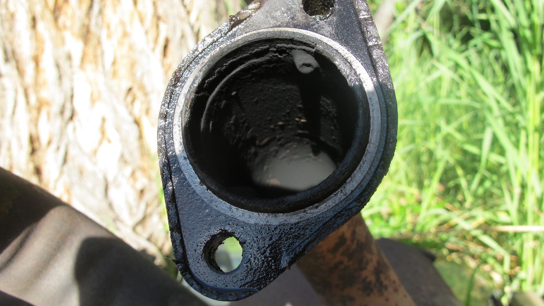

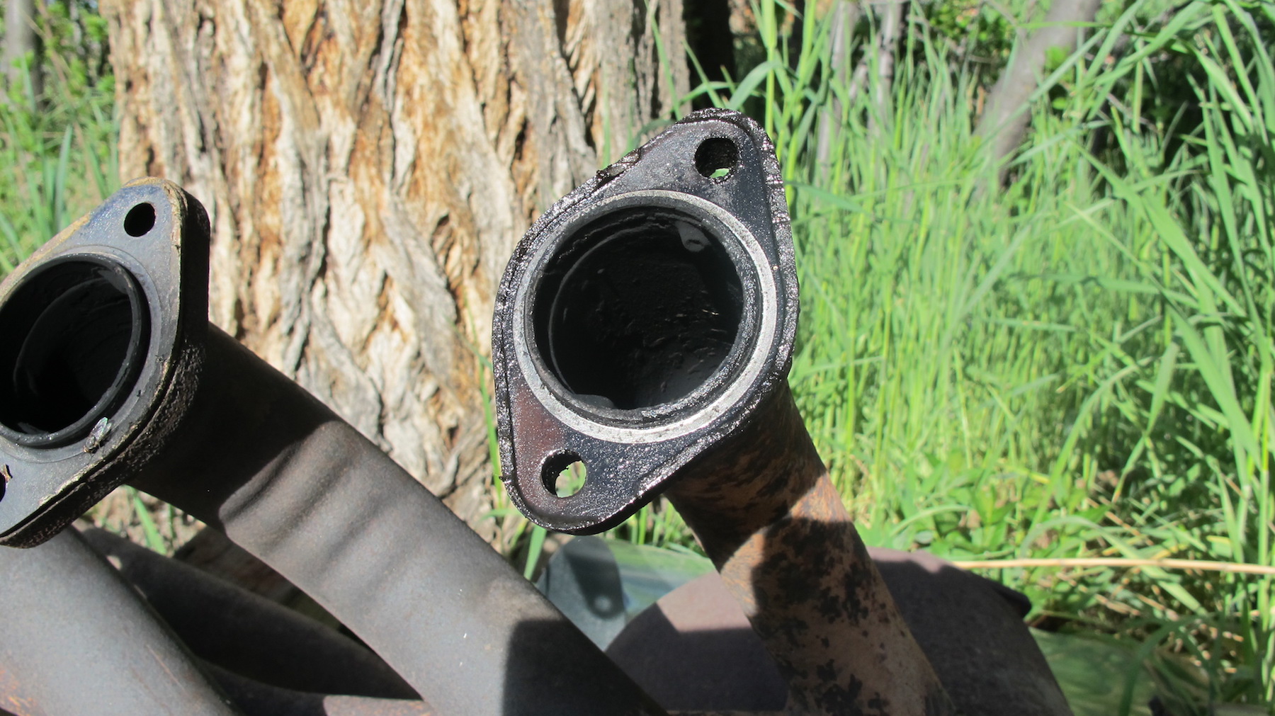

We got the exhaust manifolds off yesterday in preparation of putting on new used manifolds and the SAV flex kit. So I was able to get some better pictures. The original stud that was leaking even when the engine was not running seems original, no helicoil on it or any of the others. The nuts on Cylinder 4 that includes the leaking stud came off much easier than the others. The exhaust manifold on it had been modified by a previous Owner to be all hard pipe with no flex. My best guess right now is that the leak is coming from the oil drain tube above that shows oil on it, and getting into the #4 exhaust manifold gasket that wasn't tight. At least that's a hope.
And while I was down there I noticed another oil leak on the Cylinder #2 fins.
Any thoughts?
The number 4 leaking manifold stud flange.
IMG_1869 copy.jpg (542.06 KiB) Viewed 6402 times
IMG_1870 copy.JPG (463.51 KiB) Viewed 6402 times
The oil return tube above is leaking.
IMG_1875 copy.jpg (507.43 KiB) Viewed 6402 times
We noticed another leak on cylinder 2
IMG_1876 copy.jpg (491.22 KiB) Viewed 6402 times

The picture is a little deceiving maybe because of the flash. The oil around and along the oil return tube is very obvious in real life.
The exhaust stud leak seems to continue indefinitely after shutting down. When I was checking it more often, it could be a day or days and i'd still see a bubble on the stud after having wiped it off.
Luckily it rarely drips to the ground. It drips along the bottom of the center chassis tube that shows it in an increasing fashion over time.

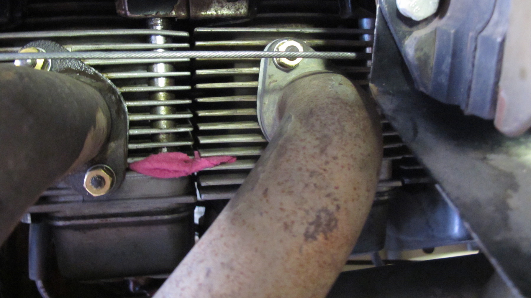

One thing to try is stuff a small rag in the fins right at the head and 1'st fin around the tube and see if
that stops the leak beyond the time you typically see it develop. Don't forget to take that combustible
material out though :wink:

Started the Pinz again yesterday and tried the rag stuffed around the oil return tube. The stains in the pictures are from the day before, before I started it up with the rag in place. I didn't see anything visibly flowing with the rag around the return tube, like I saw the day before with no rag. Sure appears that I have the same oil leak that rmel had, maybe more.
IMG_1900 copy.jpg (213.89 KiB) Viewed 6314 times
IMG_1901 copy.jpg (429.79 KiB) Viewed 6314 times
Posts: 1536
Re: Engine Oil Leak on bottom of cylinder head nearest drive
One step closer to nailing that then :wink:
In your case it would be a failed O-ring that is just giving up the ghost.

should hold long enough to indite that O-ring as bad. Might hold up for
the season if your lucky :?
clean thoroughly around the Oil return tube with brake cleaner
Just be sure to prevent the brake cleaner from draining into the engine oil!
