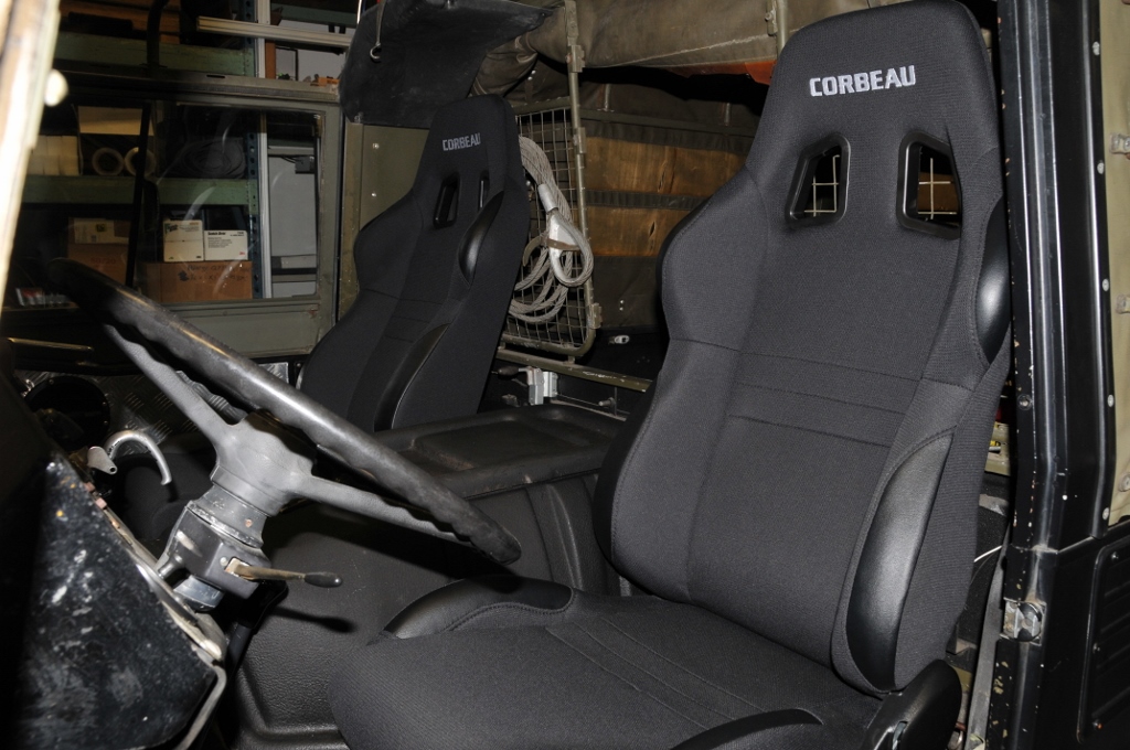

Another option. I used Corbeau A4 seats. They just fit the PS perfectly. I used the stock frames so I still have adjustment on the drivers side. Both remove like stock using the wing-nut. Available through Amazon for $650 for the pair. They will not fit someone over 35" waist. I am 6'2" 200 lbs and they are snug but comfortable.

Nice!
Can you measure how far they are (seat and nose of seat) off the floor.
Just interested if you were able to get them lower than stock seats?

Those are very nice seats.
When I was at Scott's shop I looked at a set of those already installed in a 710. They put me too high and my head was bumping the pad at the ceiling support.
I opted not to go that route and eventually got a set of Honda seats from a salvage yard. Had to make the plate to put them on and it raises me about an inch higher than the original
seat height. Almost too high to use the dead pedal except with my toes. I put a piece of angle metal under it to get it higher. Sort of feels like putting blocks on your bike pedals when
you were too short to pedal the bike. :D
