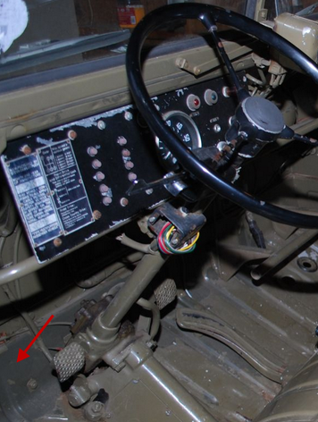

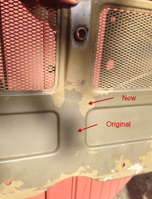

Ok so I was going through photos of my 2nd Hafi that I recently sold and the "new" Olive color Steve/Constantin mentioned now makes sense. Mike not sure if yours in olive green or more hunter green? Perhaps another color we don't know about??
As you can see from pictures below (olive color is also on the other side (inside hand crank area as well)) this hafi was definitely olive green (someone resprayed it a bit lighter color but the olive green is factory as it is in every side nook and cranny).
I will take a RAL chart home today and see if I can match it up to RAL7013 (looks really dark on my charts) - once I do I will make a new thread so we can document this and have it easy to search for.

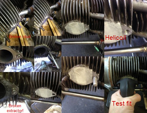

Sorry for double post but this one is back on topic
Finally got my exhaust manifold bolt fixed up and ready for assembly!

Your original color is the L275 code that I gave you a while back. Note that many of the bolt-on pieces on original Hafs were painted with the olive green Austrian military paint before getting the final color coat. You will often find the inside of battery or tool boxes and windscreen frame flanges with the olive green under layer. My guess is that S-D-P had a large parts inventory at the ready for release to the Austrian & Swiss armies so would also use this stock on the vehicle assembly line.
