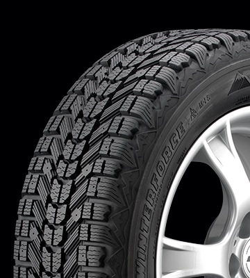

These are the tires l found in 13" 155/80 . Not expensive. Great on and off road.
Re: 145r12 Yokohama Super Digger II's
Looks like a nice tire - diameter should be 22.76" according to the online calculator I found.
