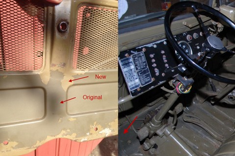

I agree about camera's (and computer monitors etc) Steve - the 2 pictures I posted previously (posted here as pic #1) are of the same Hafi - my 1971 olive green, RAL7013. So the rear door pic is from the 1971 olive green hafi and really shows the difference lighting and the type of camera can make!rustywheel2004 wrote:Hi Dan,
The color of your 2nd Haf and Mike's side boards is the RAL7013 Matte Olive. Although the images appear as slightly different hues, you have to consider lighting conditions and camera model color shifting. My Haf looks deep orange with my Fuji digital camera but the proper red with my Leica digital camera.

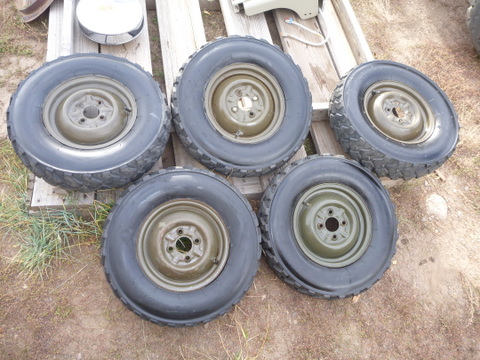

#1 The Hafi that I am rebuilding (and got the Wagenstammkarte for is my red/yellow one (picture of paint under window bracket rubber below) - pic #2 - you can see the red, then yellow and the light (what I think is L281) original paint. Note: the dark areas around the edges is just 40 years of dirt and has now been cleaned off, I just don't have a new picture.

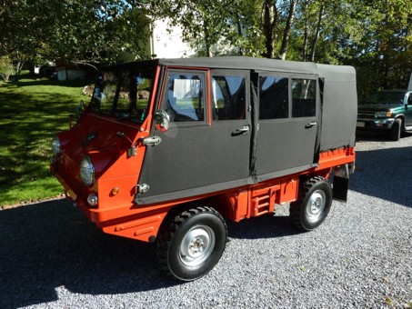

#2 From what I can tell it is very "white/grey" and to me looks exactly like the one SAV just sold? (Pic #3)
Which I assume is L281 as the L275 looks much darker to me.

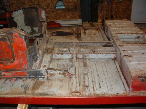

#3 And just for reference here is a picture of L275 Light Beige (pic #4)

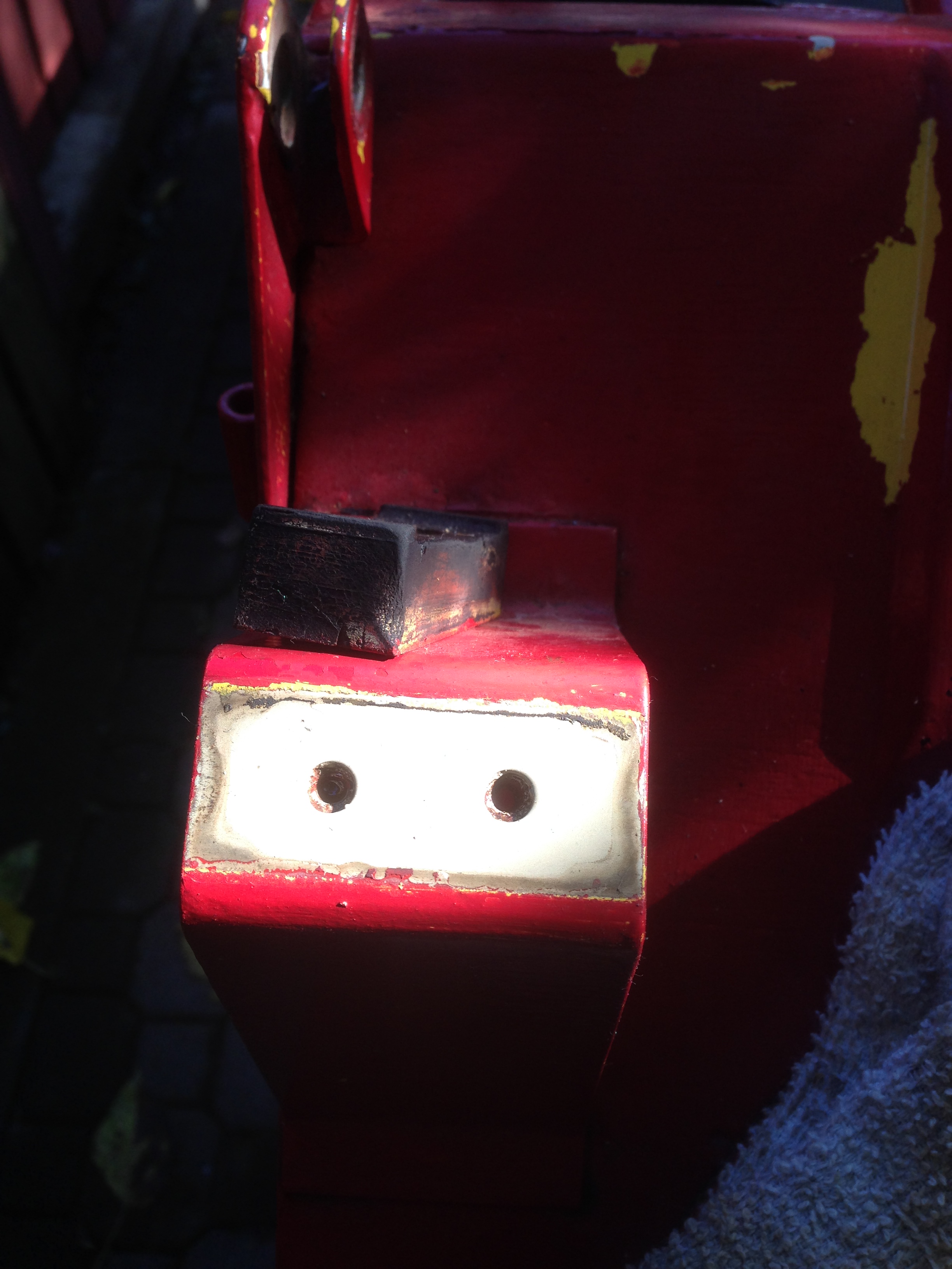

Here's a picture of the underside of my "Rot" Canadian Haflinger with the asphalt undercoating stripped off. You can see the coat of L281 that is beneath the LA3A red.

So it seems that these 2 pictures are of the same truck - now I am not sure what color this truck really is!
Hard to see it the way I posted the 2 images but they have same front antenna
- US Haflinger Paint Colors1-001.jpg (58.47 KiB) Viewed 2967 times
In the lower photo many things seem to have too much yellow, looking at the ground around the Pinzgauer in the background and the canvas top on the truck next to the Pinz I’d find the colors in the upper photo to be more what I think is correct.

I agree, I think it was camera and lighting that made the 2nd shot look so yellow

Hi Dan,
The Pathfinder in the Puch museum is L281. The lower photo apparently is displaying the effects of lighting/camera abnormalities.
