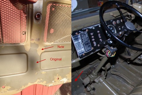

Hi Dan,

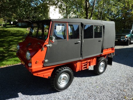

The color of your 2nd Haf and Mike's side boards is the RAL7013 Matte Olive. Although the images appear as slightly different hues, you have to consider lighting conditions and camera model color shifting. My Haf looks deep orange with my Fuji digital camera but the proper red with my Leica digital camera.
The color you indicated as "Original" in your photo of the rear engine bay door is L275 which coincides with your Wagenstammkarte sheet.
Steve

I agree about camera's (and computer monitors etc) Steve - the 2 pictures I posted previously (posted here as pic #1) are of the same Hafi - my 1971 olive green, RAL7013. So the rear door pic is from the 1971 olive green hafi and really shows the difference lighting and the type of camera can make!
#1

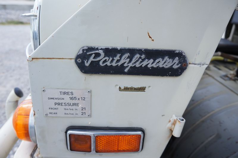

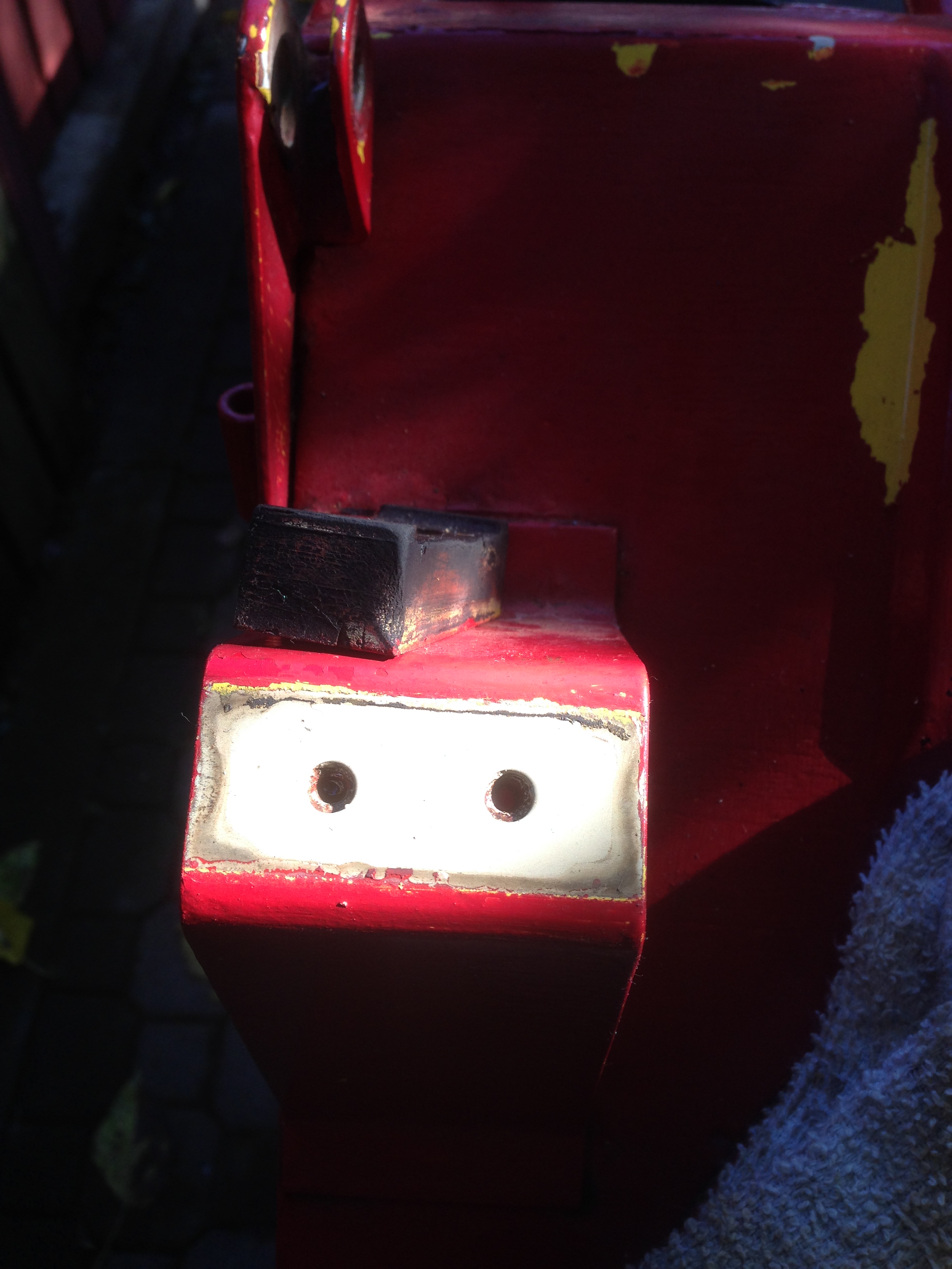

The Hafi that I am rebuilding (and got the Wagenstammkarte for is my red/yellow one (picture of paint under window bracket rubber below) - pic #2 - you can see the red, then yellow and the light (what I think is L281) original paint. Note: the dark areas around the edges is just 40 years of dirt and has now been cleaned off, I just don't have a new picture.
#2

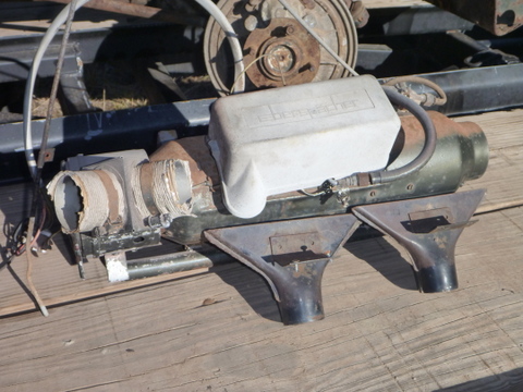

From what I can tell it is very "white/grey" and to me looks exactly like the one SAV just sold? (Pic #3)
Which I assume is L281 as the L275 looks much darker to me.
#3
shfull (22).jpg (92.79 KiB) Viewed 3048 times

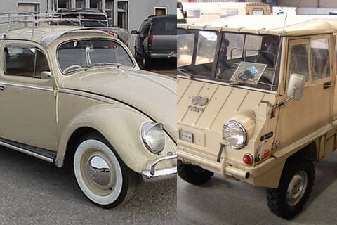

And just for reference here is a picture of L275 Light Beige (pic #4)
#4
L275 Beetle and Hafi from Museum.jpg (50.08 KiB) Viewed 3048 times
Thoughts?

Hi Dan,
Wow! Your picture #1 really exemplifies my comment about different cameras and lighting conditions...I would never have imagined these were from the same truck. Your #2 picture very much tells me that your truck was L281 but this is contrary to the description on the Wagenstammkarte. Yes, picture #3 is most surely L281 (Francis Landry also has a Haf in this color). Picture #4 is L275 on the VW but I'm not sure on the Haf as this truck may be illuminated by sodium lights. Perhaps Constantin can confirm as I'd imagine he has seen it in person.
However, remember that L281 was not only used as a final finish on some Hafs. It was also used as an initial coat on all the NA Hafs that I have encountered. It is most easily found when you start stripping the asphalt undercoating from the platform underside. It is possible that someone had sanded your windscreen support down to this layer during one of its respray episodes. It is also possible that your front cowling may have been replaced due to an accident during the truck's lifetime. I'd take another look around your truck's parts to find evidence of L275 if I were you as this is what the Wagenstammkarte is telling you.

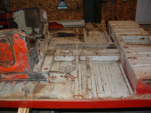

Here's a picture of the underside of my "Rot" Canadian Haflinger with the asphalt undercoating stripped off. You can see the coat of L281 that is beneath the LA3A red.
Steve
Posted: Fri Nov 08, 2013 8:55 pm
Thanks Steve, but I never expected you to go strip down your Hafi just to show me the color :mrgreen:
Seriously though, that is a great photo to have showing the L281 color.

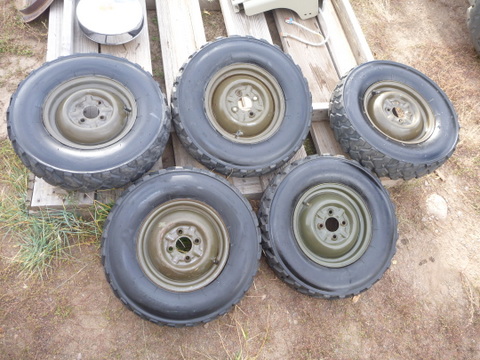

5 Mayola's with rims (will be selling the rims once I sort through them all)

This just in..
The wheels are silver.
You're welcome.
